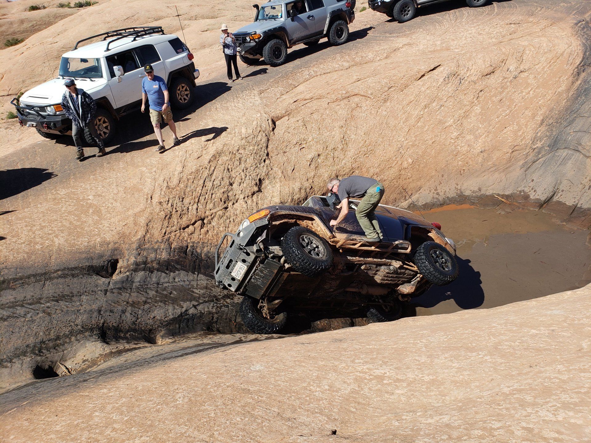

Finally, some more comic relief was in order on Hell's Revenge. This gent flopped his ride twice, once per side before he came out of the tub.

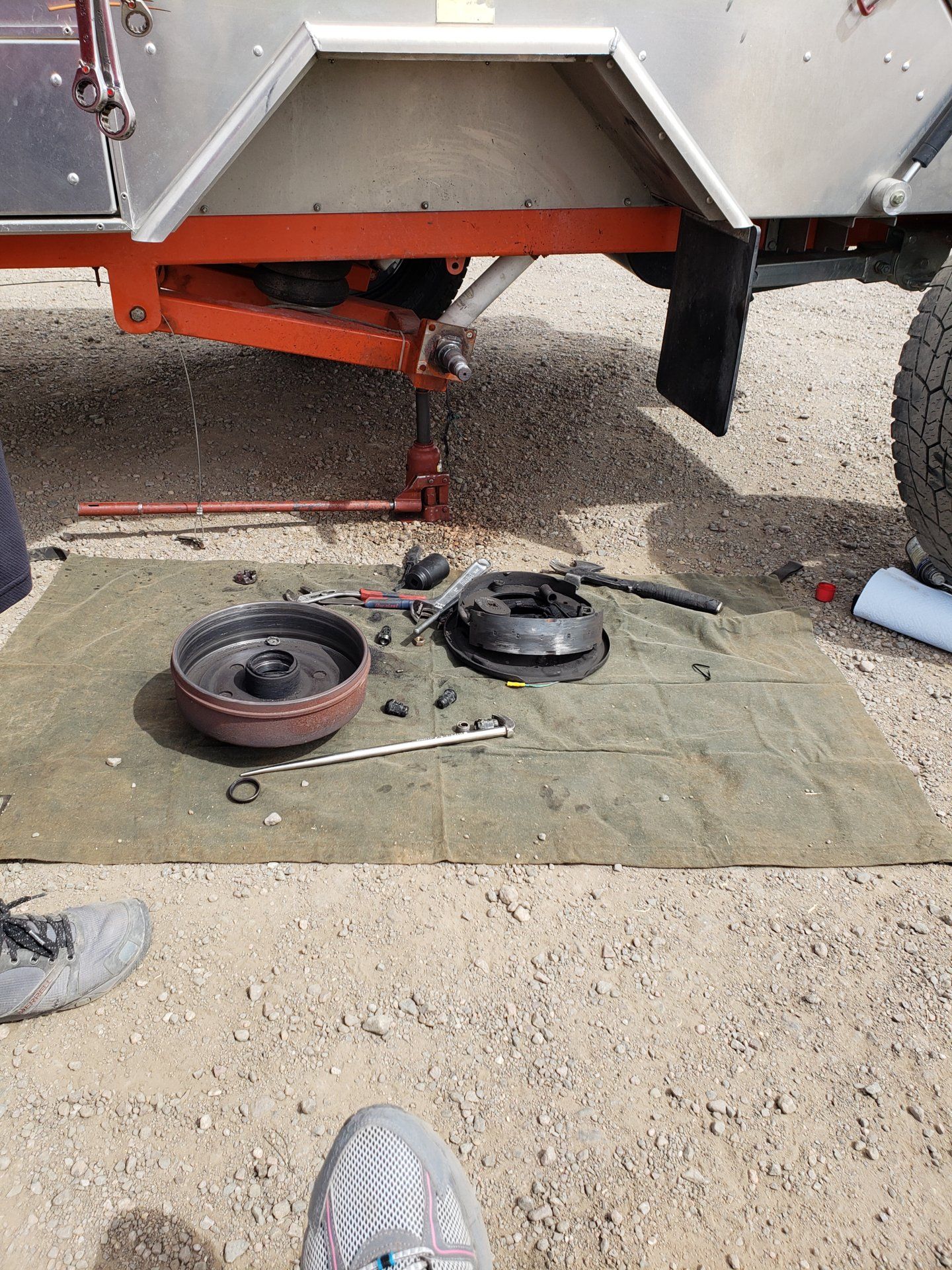

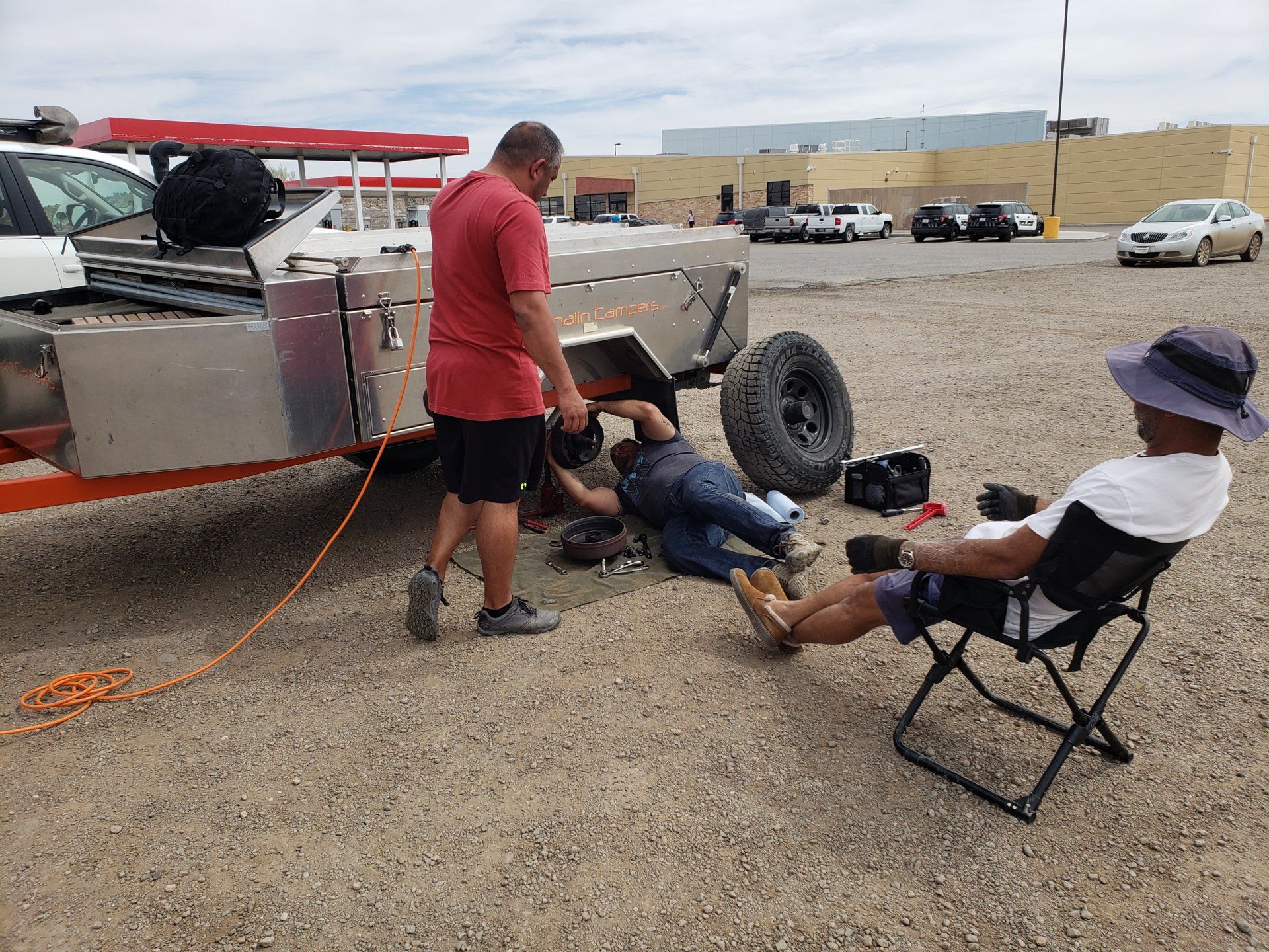

That's no fun roadside. I learned that lesson with our 5th wheel and now carry a clean, greased spare. Apparently, one can never haul around enough extra crap!
That is very true! Whatever you don't have is what you will need.
I spoke to Matt and the sick trailer is back home safe and sound. Nobody messed with it overnight, whew!
Did you have extra bearings or was it more complicated than just having the spare on hand?
