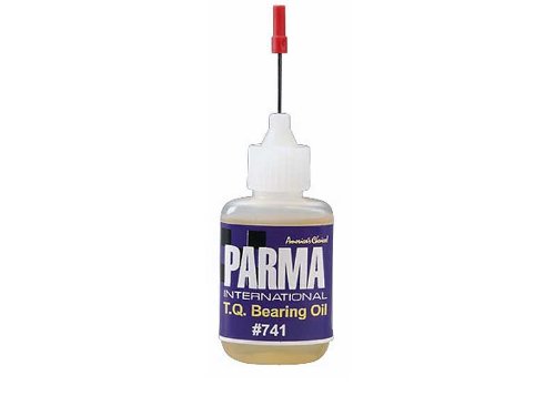

If these can be lubed, I'd use Teflon grease over silicone.
X2
X3
Doesn't take much.
