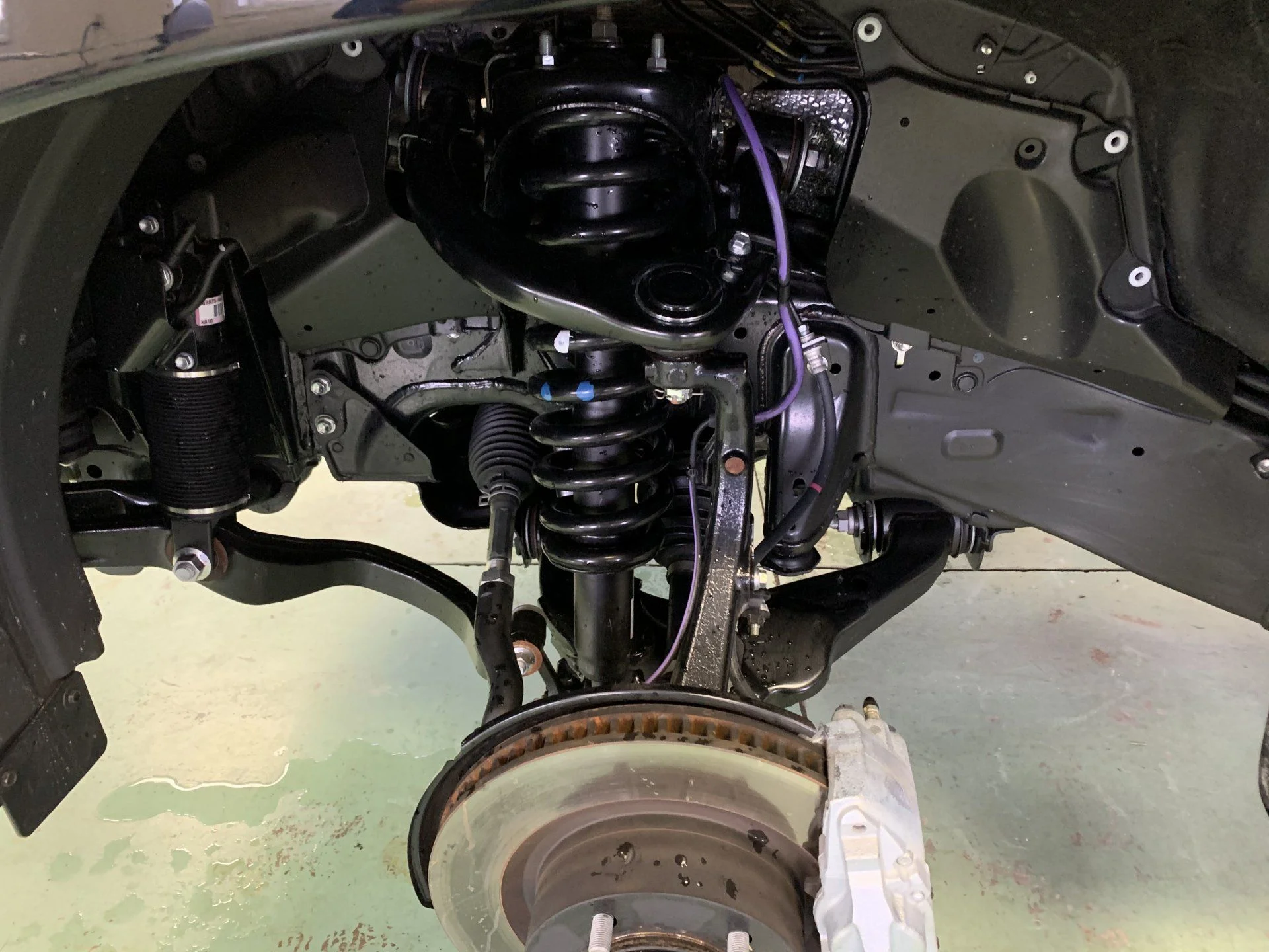

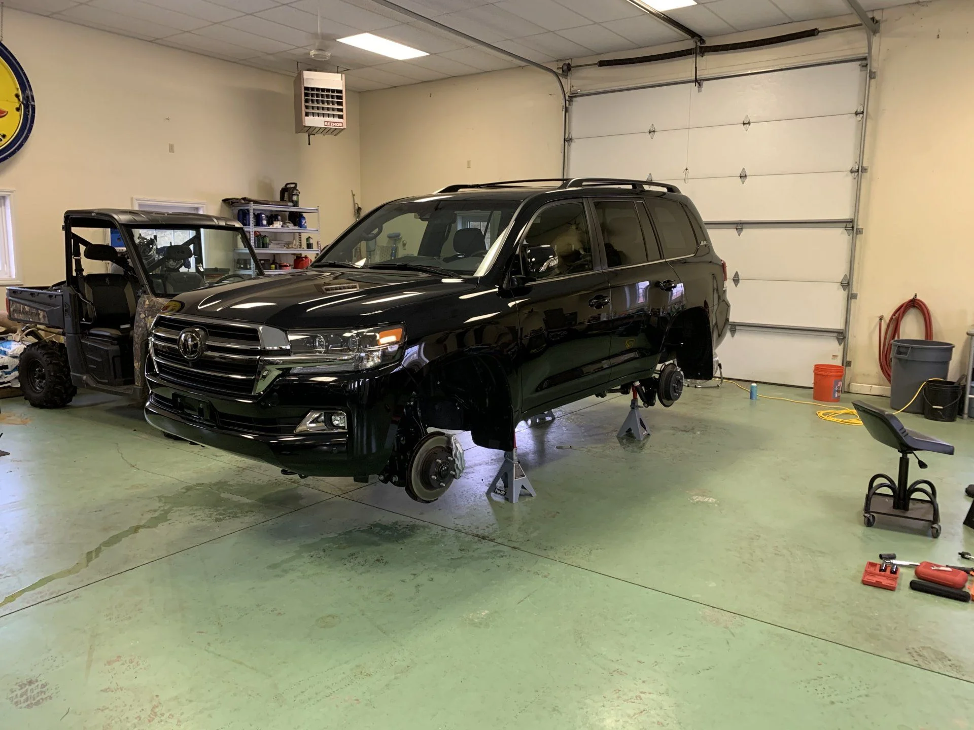

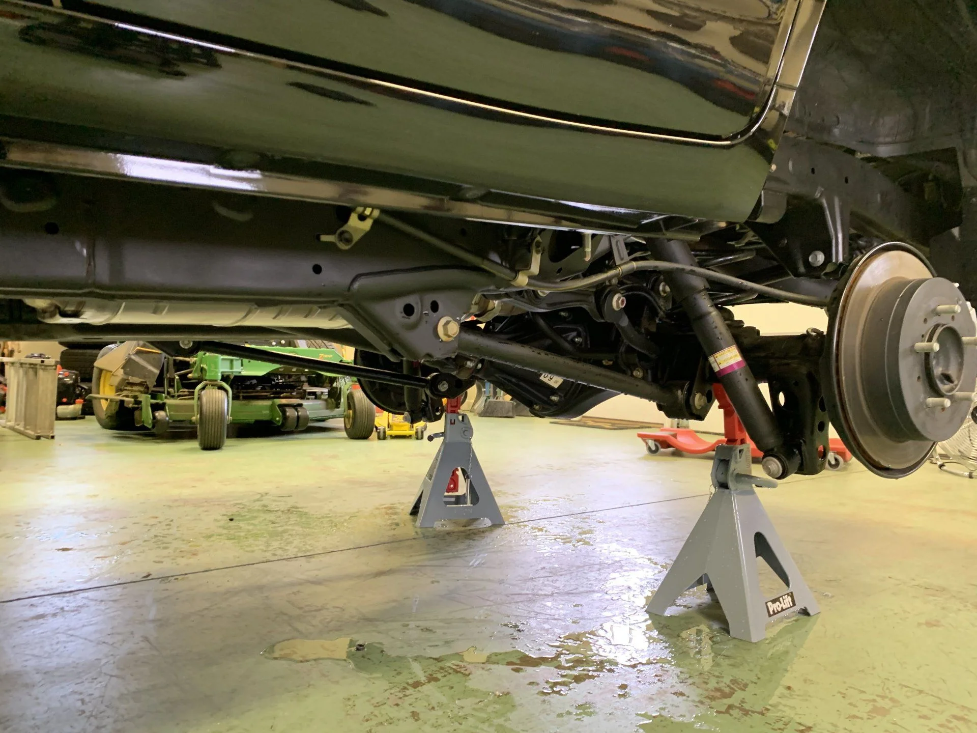

Hi guys, looking to get some advice from those who have used CRC Corrosion Inhibitor on your undercarriage for rust prevention.
I am over halfway done, just removed the wheels, and I’m getting ready to do the wheel wells. I realize this stuff is not a lubricant and hardens to a pretty dry finish, so you’re supposed to avoid spraying it on moving parts. As I get ready to do the wheel wells I plan to put garbage bags around the brakes/hub assemblies and to spray the control arms and anything metal in that area. Is there any other areas I need to worry about and avoid?

The wheel wells are a different type of material and I'm not sure you will benefit from spraying there. But around the inner fender well would be a good spot. You can feel the lip around the fender well. Also, the top of the frame rail in front of the rear tires aswell, the rear brake dust covers need to be hit hard with that stuff.
PS nice work!!
Thanks PDoyle! Do the shock coils tend to rust; would you bother hitting those?
They rust yes. If you can get to them you might as well. Keep in mind you will do this again in a year or two. Sorry.
