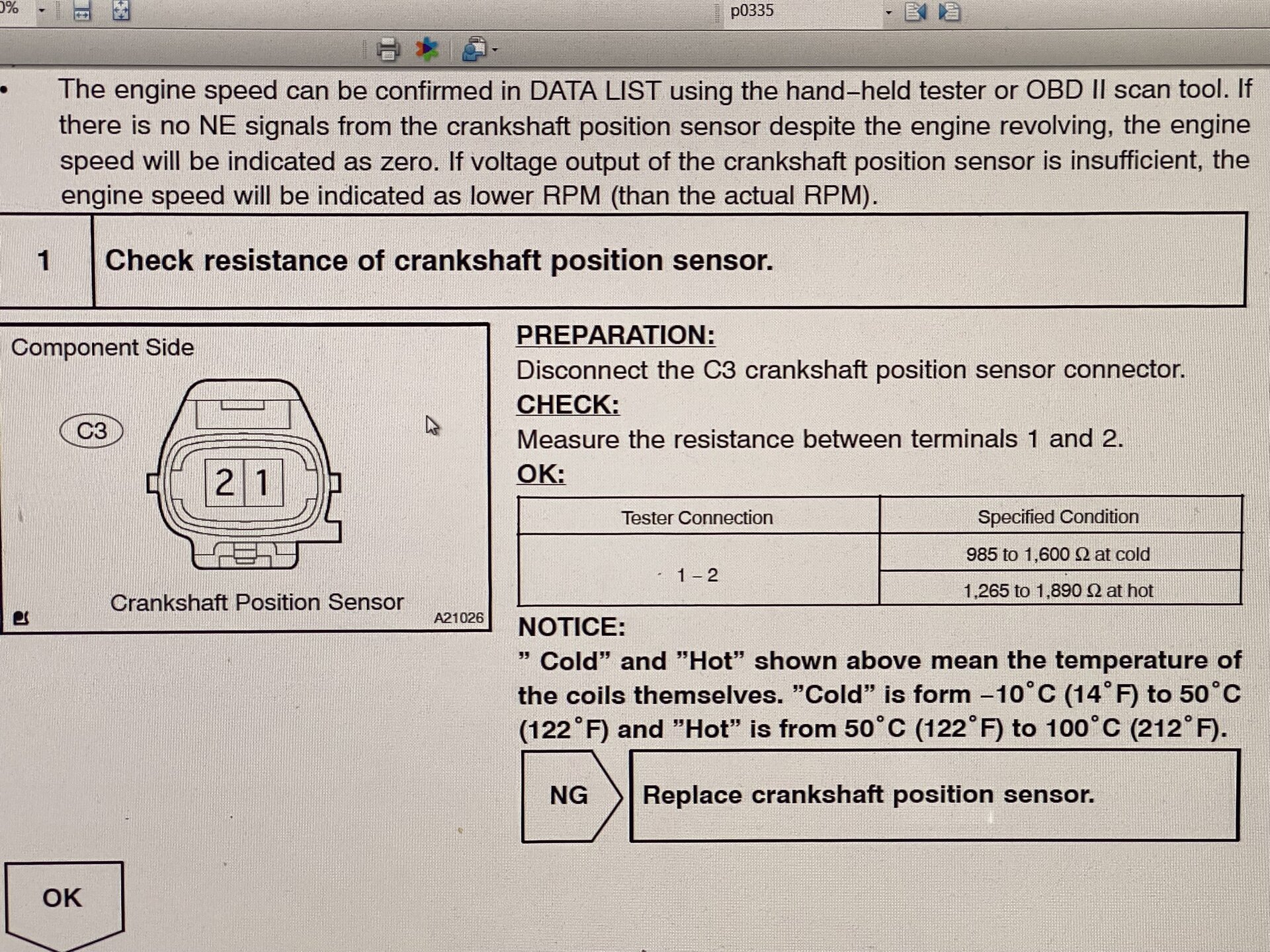

The FSM should provide a troubleshooting for the code listed where you can do a continuity check of the wire harness.

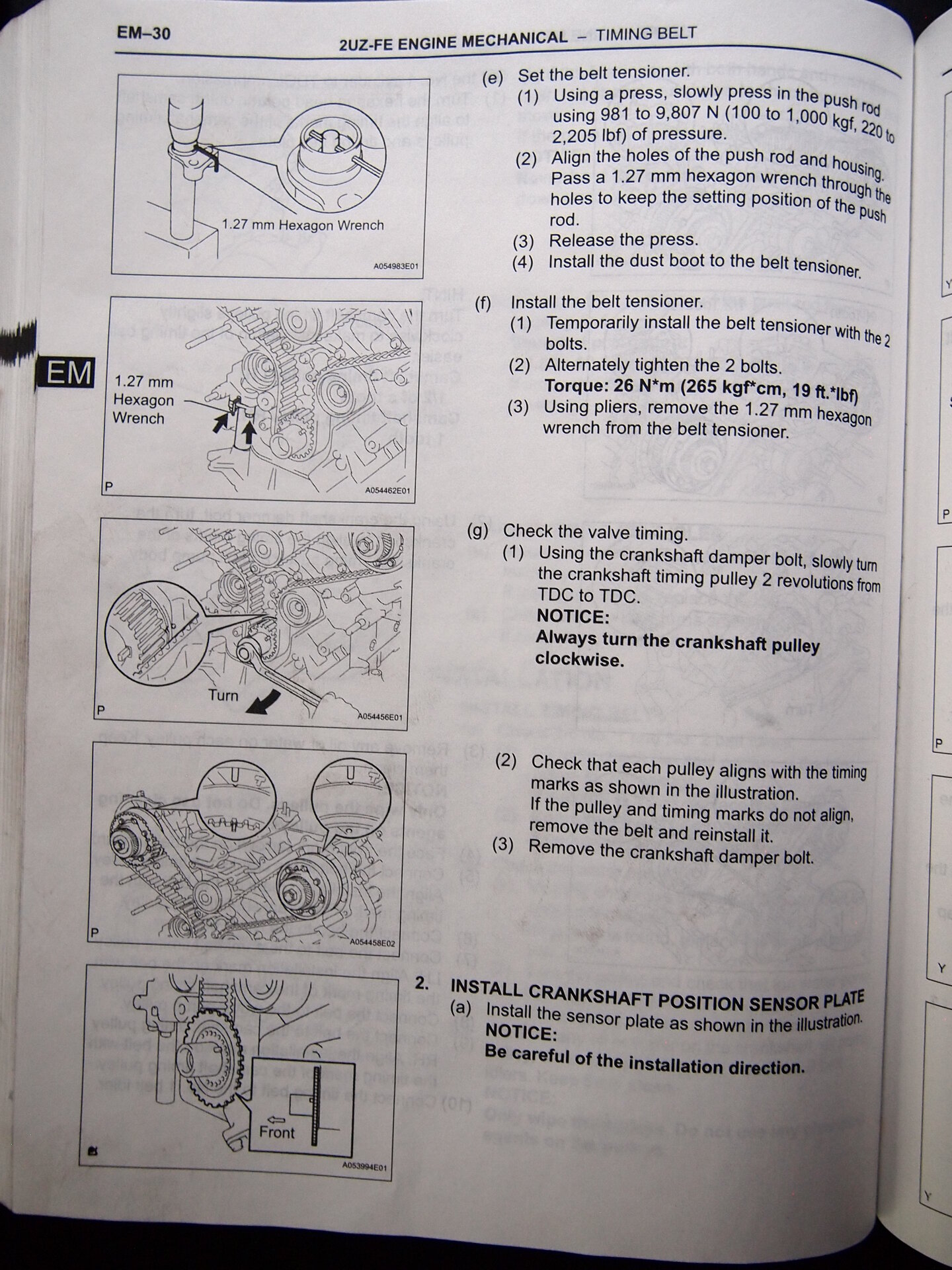

Crank no start and P0335. If crank sensor good, wires need to be test for continuity. Not only at front of engine. But all they way to ECU. Keep eye out for rodent damage. If all good. I'd ask/suspect recent timing belt service? Where Crank shaft position sensor plate, installed backward. When this happens it rubs belt, as belt wear from rub of plate, plate move inward. OR Crank pulley bolt loose and plate has moved. I've not seen a P0335 for T-belt skipping a tooth, but I'd not rule out until inspected.
See bottom of page for "Crank shaft position sensor plate" orientation.
There are other reason for crank no start. Most deal with fuel pump not getting signal/power or bad fuel pump. But with P0335, I'd start with crank position sensor end to end testing.
Thanks! No recent belt service, but can't hurt to add the crankshaft plate to the list to look at.

If timing belt, crank plate & sensor good and secure, crank sensor wire/circuit good end to end. FSM states replace ECM.
