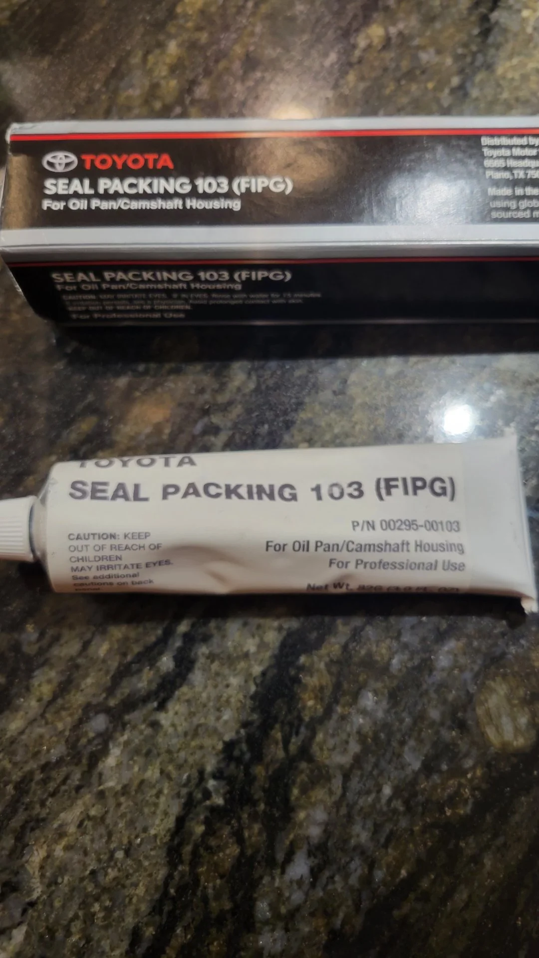

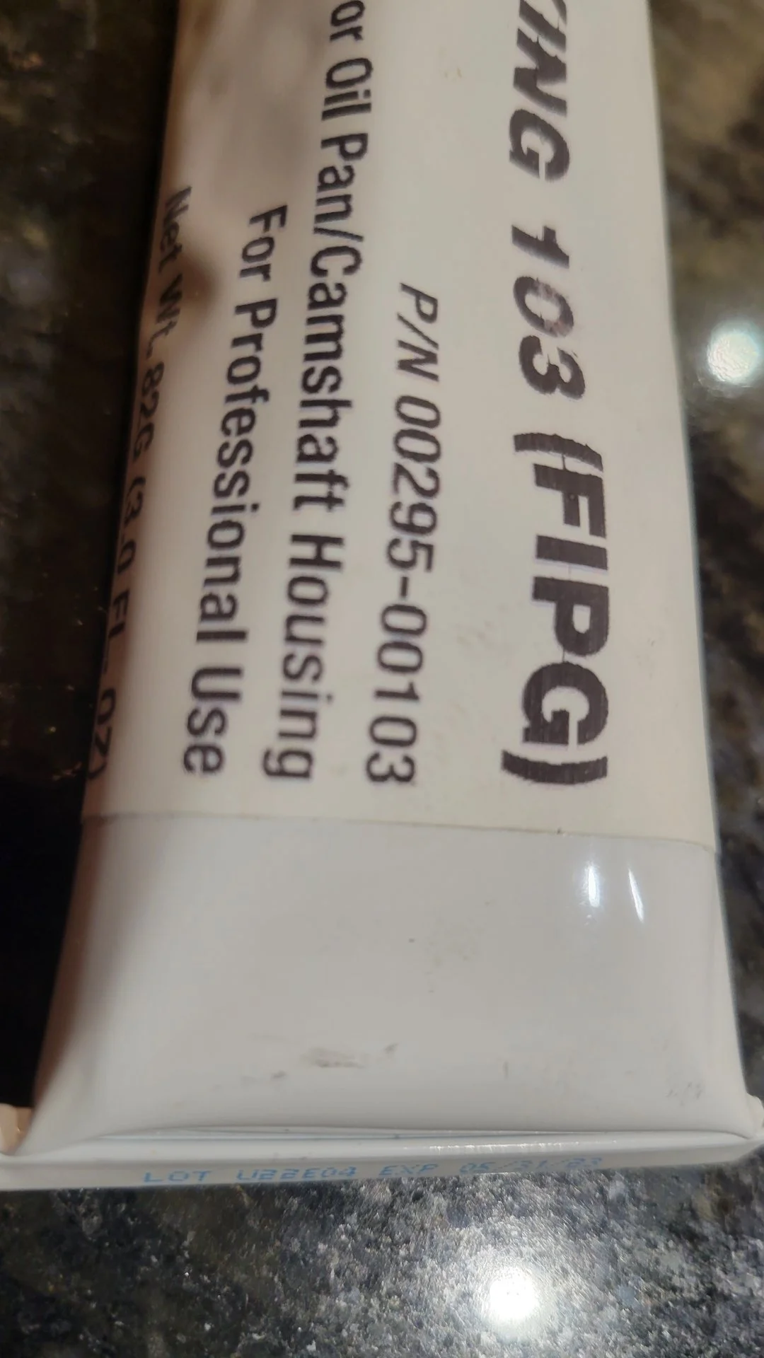

I wouldn't buy this stuff anywhere but a Toyota dealership at this point. This is what I just got from Amazon. Straight up printed ink jet label stuck to a tube of who knows what. It's pretty much impossible to find genuine parts online anymore, especially Toyota parts.

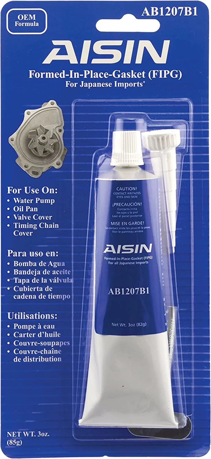

Aisin has its own branded FIPG for toyota coolant but a fraction of Toyota branded stuff. Just used it for mt 3VZ water pump/idler replacement.
Aisin FIPG Yotashop
Internet perusal brought up some coolant incompatibility between RTV and yota red/pink coolant that I couldn't shake the fear of so the Aisin stuff was my answer. Granted the coolant exposure failure for RTV was speculated at 4-7 years to leakage...

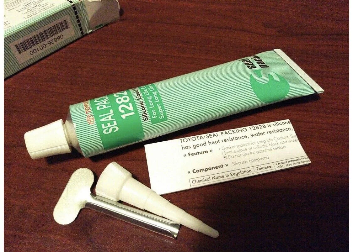

Toyota 1282b for coolant is ~$100
Ebay 1282b

I ended up using the aisin fipg that I had left over from my 100 series coolant pipe connection. I used it for the oil pan and timing cover on a 99 corolla that I put new rings on. No leaks so far but time will tell. It claims it can be used for coolant and oil. I've never had an issue with (genuine) Toyota 103 FIPG so I will continue to use it as well. The Toyota product 1282B for coolant is the one that has the ridiculous price ($50-$100 a tube) which is why I had bought the Aisin instead.

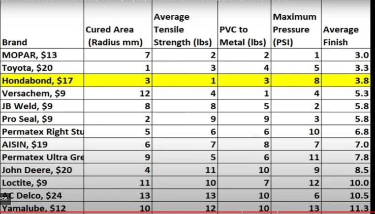

That is very interesting. I am subscribed to that channel but had not seen that episode. Here is the breakdown of the results first to last place.

was the 00295-00103 black FIPG in the end counterfeit ?
i re read the entire thread and it seams it was

was the 00295-00103 black FIPG in the end counterfeit?
Based on the packaging, I think it is obvious but I didn't test it to find out.
I was passed my return window but was able to get a refund after chatting with Amazon support. I told them that selling counterfeit items was illegal regardless of going past the return window by a couple of weeks and I was sure they wanted the item back so their fraud department could investigate.

Anyone have an update on this? I just received an order from a Toyota dealer and the tubes look just like the original post.
perhaps they just changed their labeling ?
