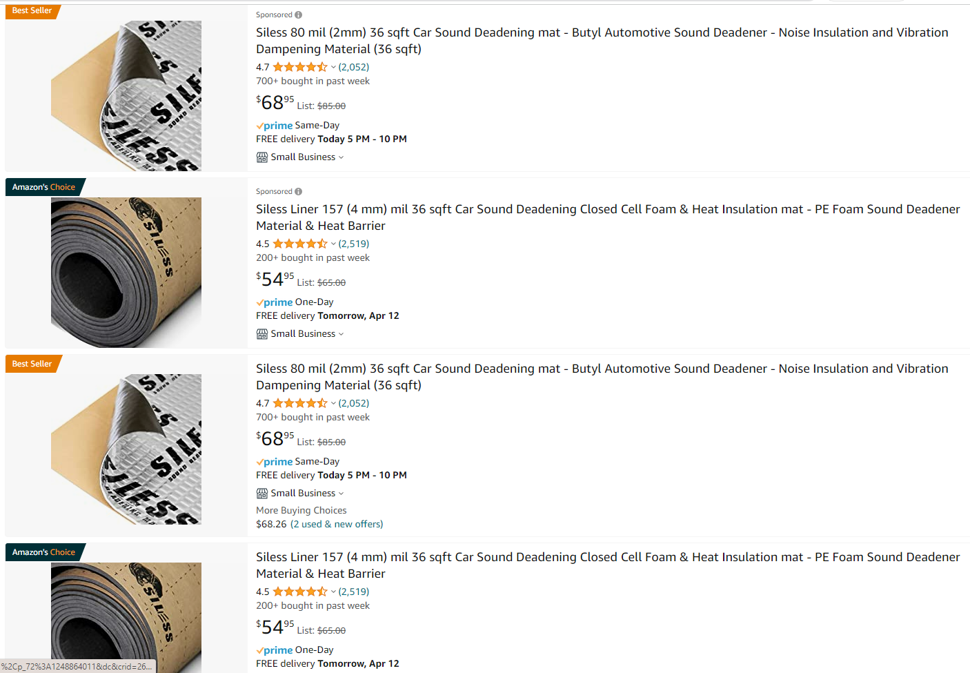

I don’t imagine Utah is very humid. Jute collects a lot of moisture, the reason most old cars in the south smell pretty musty. Instead of replacing it with more jute, id look into a cheap knockoff of Dynamat. I went with a “Siless” brand on Amazon and like it really well. 1 layer of butyl for sound deadening, and one layer of closed cell foam for insulation. If you have spills in the future, no worries about it soaking in.
Was one roll of each enough? Did you have to cut it up a lot or did it just lay down nicely?
It comes in square rolls, so you’ll have to cut it to fit. I can’t remember exactly how much I got, but take a tape measure and measure out at the very least the floors, and rear fender wells. Length multiplied by Width will give you a rough idea of square footage. Order accordingly. It’s pretty easy, but do some research before you jump into it. You’ll want a roller for the butyl.

I went with the Siless products first suggested. I got 46 sq. ft. of the Butyl and 36 of the closed cell foam. I figure I'll start at the front and work my way back. If I run out I can leave the rear carpet out while I order more. I got the rollers as well. About $165. That's an expensive gallon of coolant. I need a hazmat container in the back.

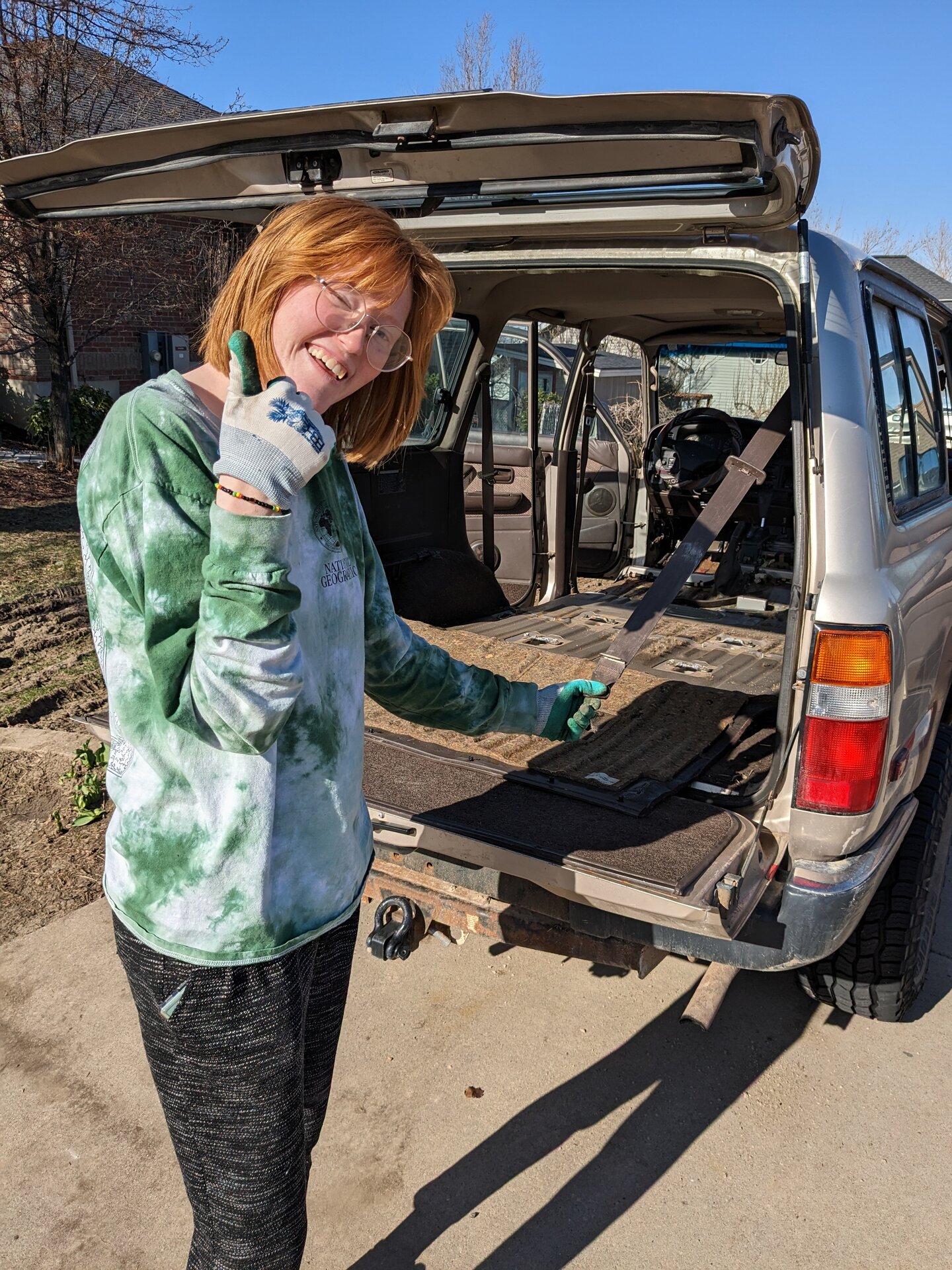

We started last night and got all the seats and things removed by the time it got too dark to work. Back into it this morning. Pressure washing is great, but I wonder if a good quality suction carpet cleaner would be faster. (Videos in the Google photos album)

We used the pressure washer inside, just pulled all the plugs to drain. Then we used a leaf blower to mostly dry it, then hooked up the R2D2 type dehumidifier from the house for an hour. Worked great.
It looks like 46 sq. feet is enough to cover the floor, but not quite the wheel wells. Here's our dry fit.
We'll cut out for the floor bolts so we have metal to metal faces, and for any other openings and access points.
