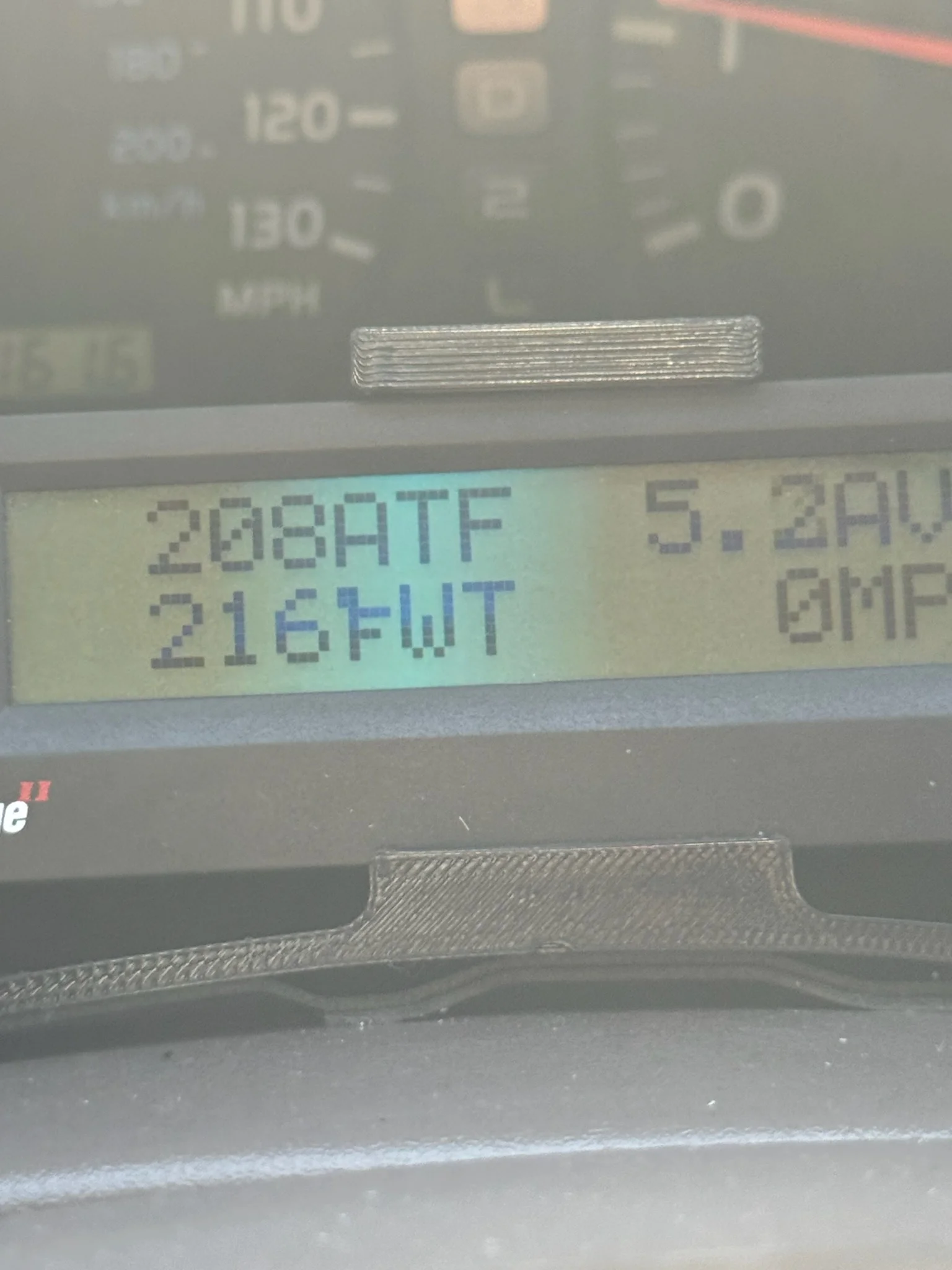

Coolant running over 210+ F in Phoenix

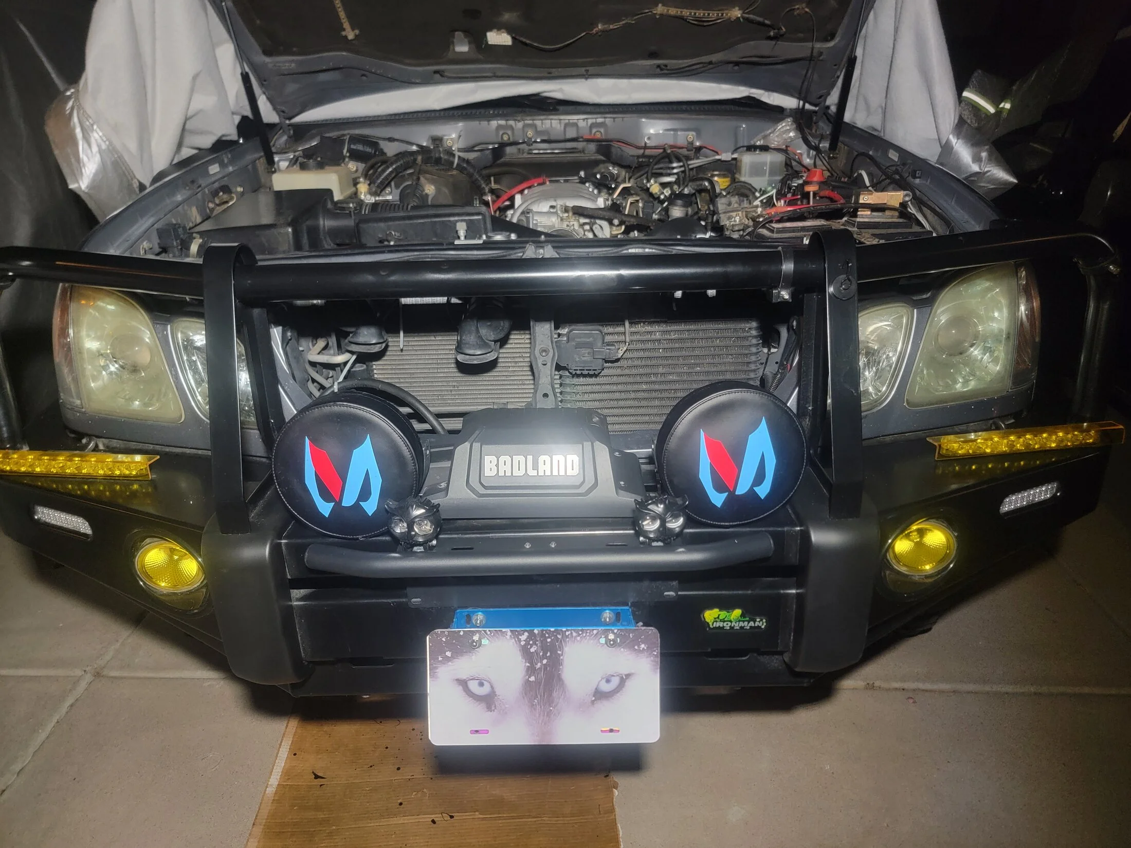

This is how the bumper and winch looks like, and it does put a solid block to the air path of the bottom half of the radiator.

If you look at an OEM bumper it typically has a pretty solid piece where aftermarket bumpers are. The lights and winch box though are directly in front of the grille opening and probably causing the most impact.
You could consider drilling some “breather” holes in the bumper…
The winch itself is a giant heat sink, so when it’s hot, it’s Hot down there!
Yeah, thinking of removing the lights as it's the easiest one to remove.
I believe the bumper has enough openings and think the winch has more impact as it is a big chunk sitting right in front of the condenser and radiator

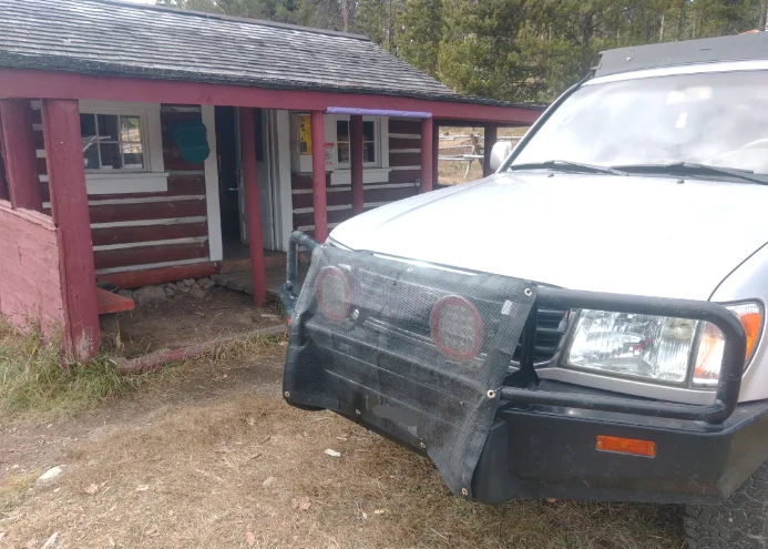

For what it's worth. I have a similar bumper setup with lights and badlands winch + I run a mesh screen year round and have no issues. BUT my area doesn't see temps over 100f too often so perhaps I'm not much of an example to compare with ..... I did a few days in Nevada recently in 95+ degrees with this setup and my temps stayed under 195 even when climbing hard in 4 low off road, usually right around 187...

I can't seem to find a pic with the winch installed but you get the idea , the badlands control box sits right in the middle there.

Keep in mind. The first rad is the A/T oil cooler. If A/T fluid (ATF) running hot, we transfer extra heat to condenser and then engine rad.

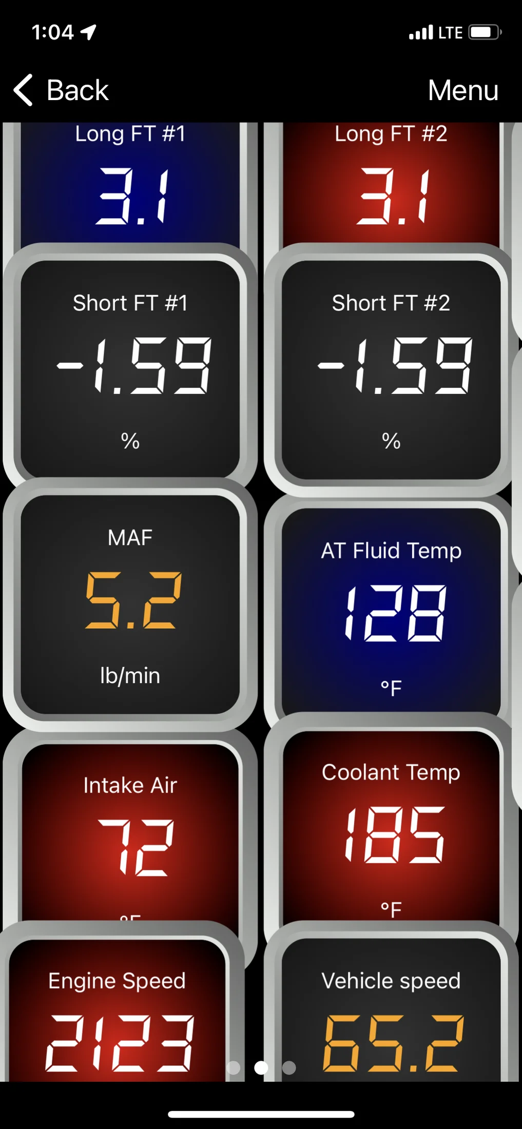

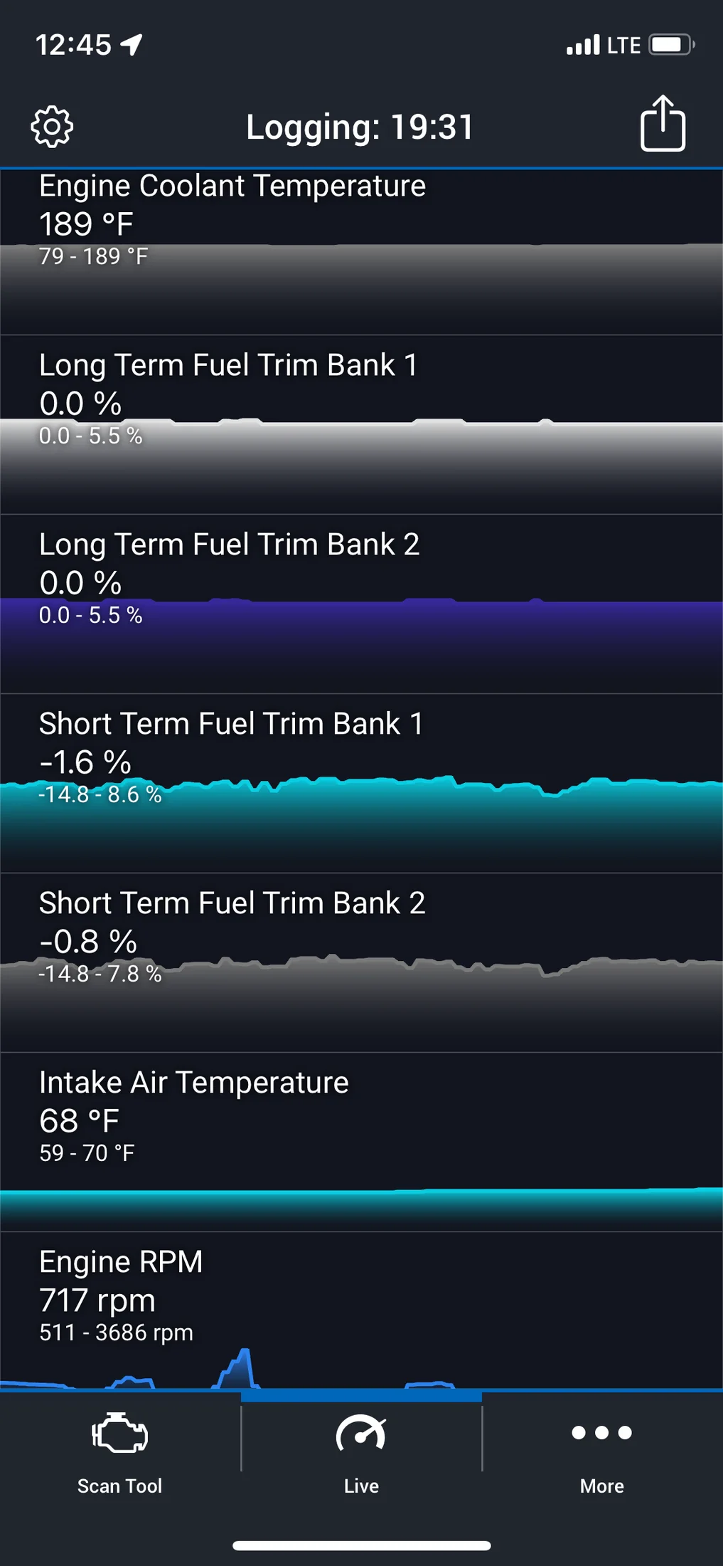

Good starting place, is watching fuel trims and AT temp.
What are ECT, fuel trims and AT fluid temps readings. While on HWY, off road??? If running lean, cylinder head temp goes up.
At higher RPM, fuel pump runs in high speed. It may be worth monitoring fuel pump speed, if you find fuel trims running lean at higher RPMs, as ECT temp hit your highs.

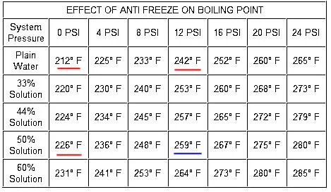

I think the 100 series cap is 16psi, so w a 50% mix, even at 210* you shouldn't be in any danger of boiling over.

More water, less antifreeze will cool better, especially if you don't have to worry about freezing temps. The cooling system is under pressure as has been mentioned, so even if the coolant is above the boiling point, it won't boil unless you lose pressure.
Right now I noticed the high ECT issue on highway, not on trail. I didn't do any hard tail either. The ATF temperature was at about 180F range according to the Torque Pro.
Fuel Trim is new to me and never heard/thought about it before. Just did a quick reading and found it's an important indicator. Will start monitor it...
How to monitor the fuel pump speed?
