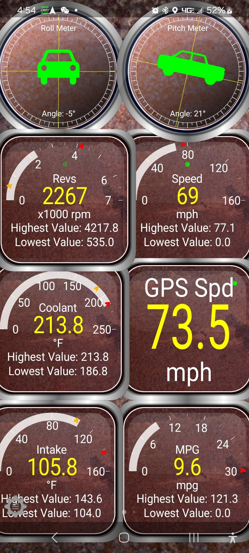

Hello friends,
I was trying to figure out if it's normal for my coolant constantly run over 210F under Phoenix sun, no matter if it's cruising at 70mph on highway. It's even higher at 220+ when climbing from steep hills at highway speed. The outside air temperature is above 105F...
My 04 LX470 has new fan clutch, new coolant (drained/filled with over 16 gallons of distilled water), new tees, new hoses, and almost new thermostat. I tried a brand new 3 rows all aluminum radiator and now the CSF radiator, but the temperature seems same. Thermostat doesn't matter as it's same high temperature even without thermostat installed.
Anything I missed to get the coolant back to range?

AC seems working fine, even it shows over 220. Have squeezed the upper hose lots of time for burping, with full heating.
One thing I'm waiting for part is the ECT sensor...
