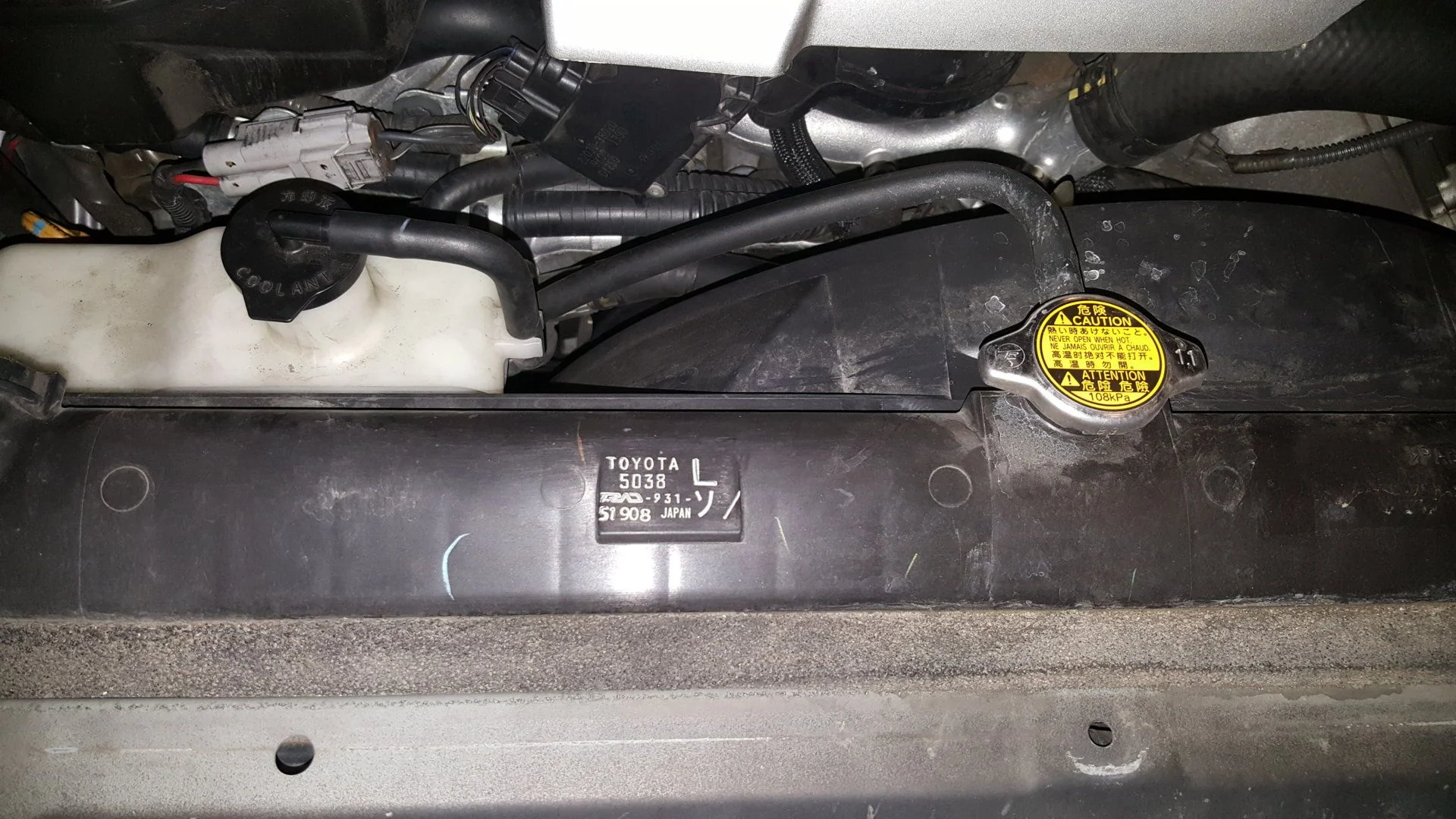

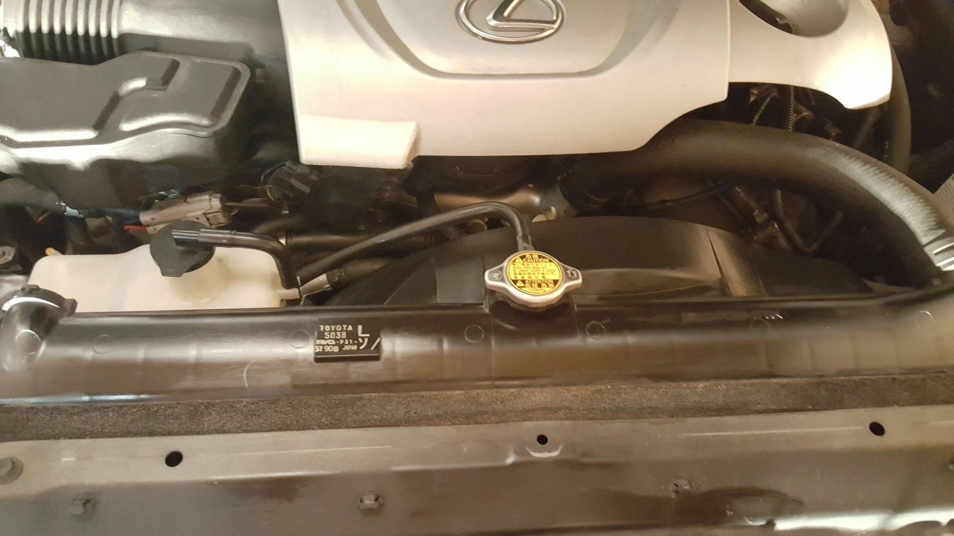

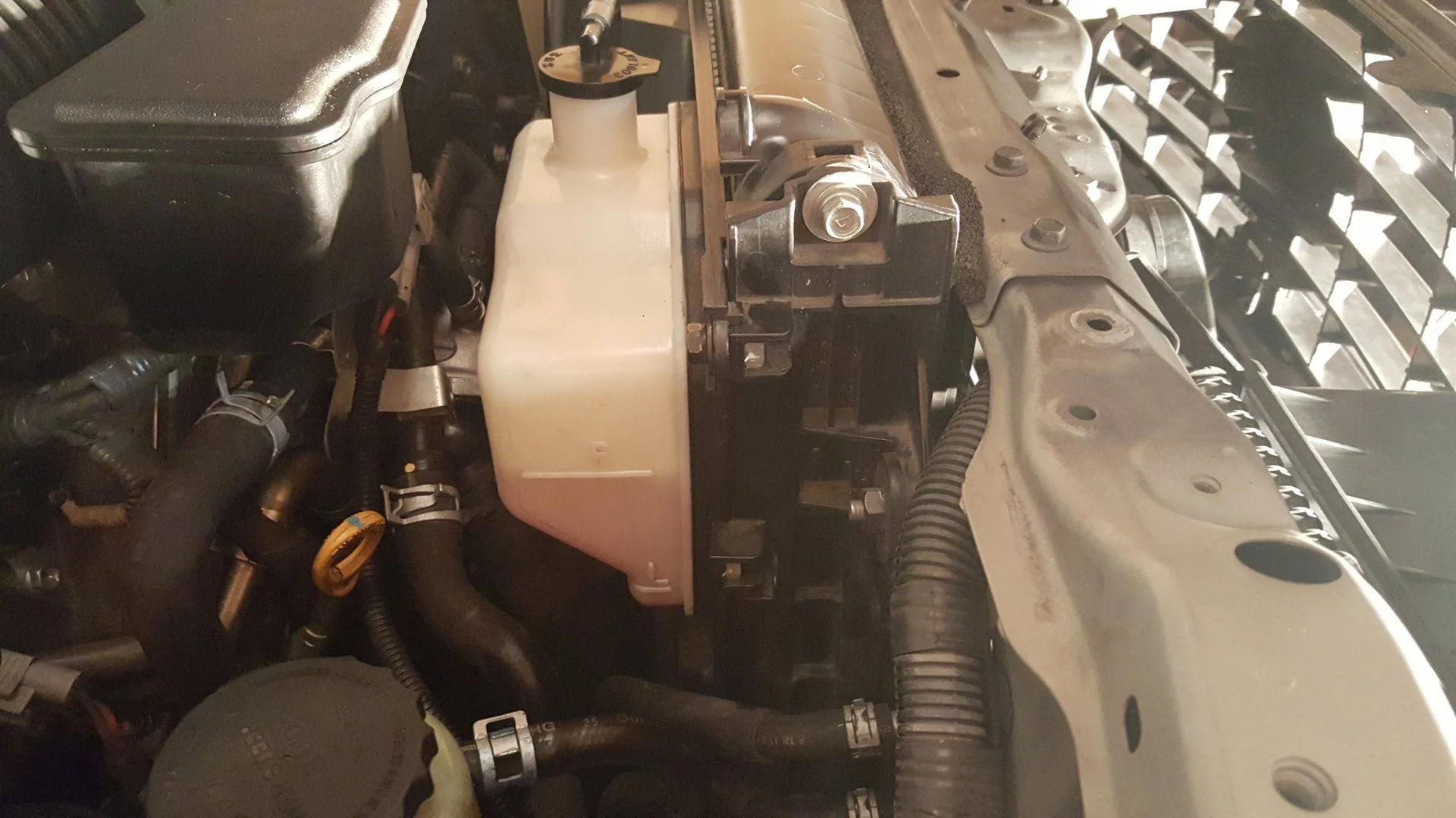

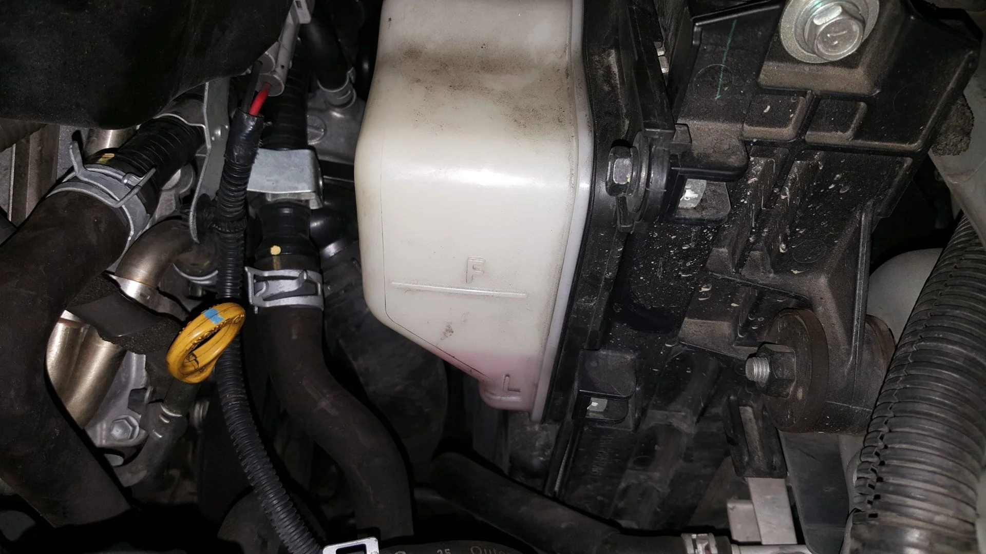

Today while reading the cracked radiator thread, it spooked me out so I took a few pics of my LX570 while it's been sitting outside for 10 hours now. I swear I topped off the coolant a few weeks ago but today the coolant level is sitting half full. What do you guys/gals make of the pic? Is that dried coolant around the coolant cap and to the right of the reservoir?
You need to top it off to the full mark when it's cold and take off the radiator cap and top it off could of been some air in the system from the water pump change and coolant refill. I can't see any pink, but I would also buy a new radiator cap if your over 100k miles along with a over flow cap and tubing. Then keep an eye on it.

You have to use the Toyota pink coolant for topping off the tank to the full/cold mark. I don't think you need a new cap/tubing at this point, but if you want to go with a new OEM radiator cap, fine. Then track the level when cold. Any use could indicate a problem.
Take it back to the dealer that did the pump and have them top it off as part of the pump replacement if possible. Problem is, it'll have to be stone cold which means leaving it overnight.

On a 9 year old vehicle with 95k miles, your really going to cheap out on a new radiator cap and over flow cap and tubing?

I like to determine first if the coolant is indeed dropping and I'm not imagining things, so I'll wait after I top of the coolant to "max" when the vehicle is cold before I start replacing things.
If the coolant does indeed drop after the top off and I see pink or new white residue near the rad cap/over flow cap/tubing, I'll either order said items or bring it back to the dealership. Thanks for the suggestion.

The coolant arrived early, so I cleaned a bit around the coolant reservoir and radiator, and topped off the coolant to "F" after the truck sat overnight to cool down. I'll drive it a week or so and see where the coolant level is and report back. Thought this post can serve as document in case I need to bring it back to the dealership.

Keep in mind when checking coolant, it is very sensitive to temperature expansion/contraction. So after cool down of ~8 hours, you need to be aware of outside (ambient) temperature. Checking when very cold -10F degrees level will be lower in expansion tank (reservoir) than checking when outside temperature 70F. Even 5F degrees variance makes a difference in level.
What is all this white residue? Is your rad cap failing? I think the residue is leaking coolant. It seems to be in the correct locked position. Have you tested with a new rad cap?
