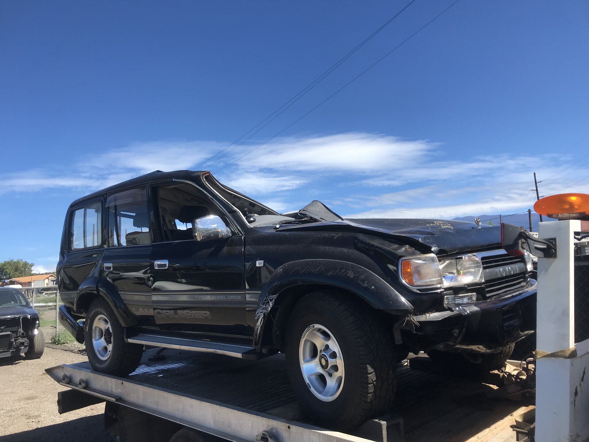

So I have found a complete FZJ80 locally that someone took the axles out from underneath. It is otherwise complete and could well be put back together.
I recently bought at auction a totalled JDM 94 FZJ80 that had been rolled over very shortly after being Fresh off the Boat.
I’m wondering how feasible it is to install these axles into a US spec 97 80. I expect the rear axle and traction bars are the same.
I hope all I have to source to convert the Right Hand Drive front Axle to work in a Left Hand Drive chassis are the steering linkage and the top of the knuckles for both sides.
Pictures to follow; I pickup the JDM Landcruiser from the tow lot tomorrow.

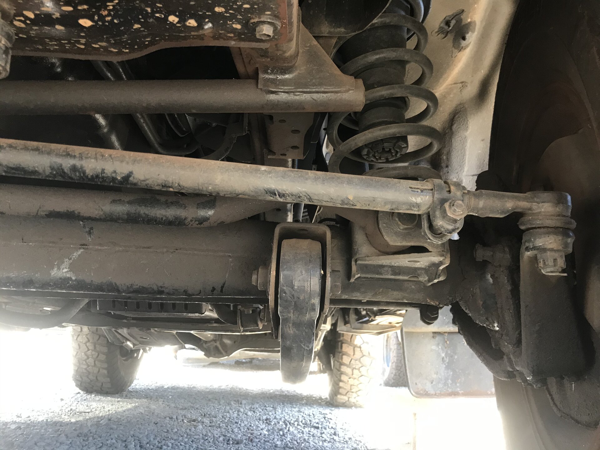

58bf12e7-3664-4dda-87da-a038e26b0ceb-jpeg.3271659
Looking at this pic, is that a crack by the ball?? Looking between the steering stop and the track bar bracket. Hard to tell if its just grease build up or a crack.....
It was just a lot of grease buildup. I looked up under there close. No apparent damage to the drivetrain. There is a damaged rear shock and rear drag link.
