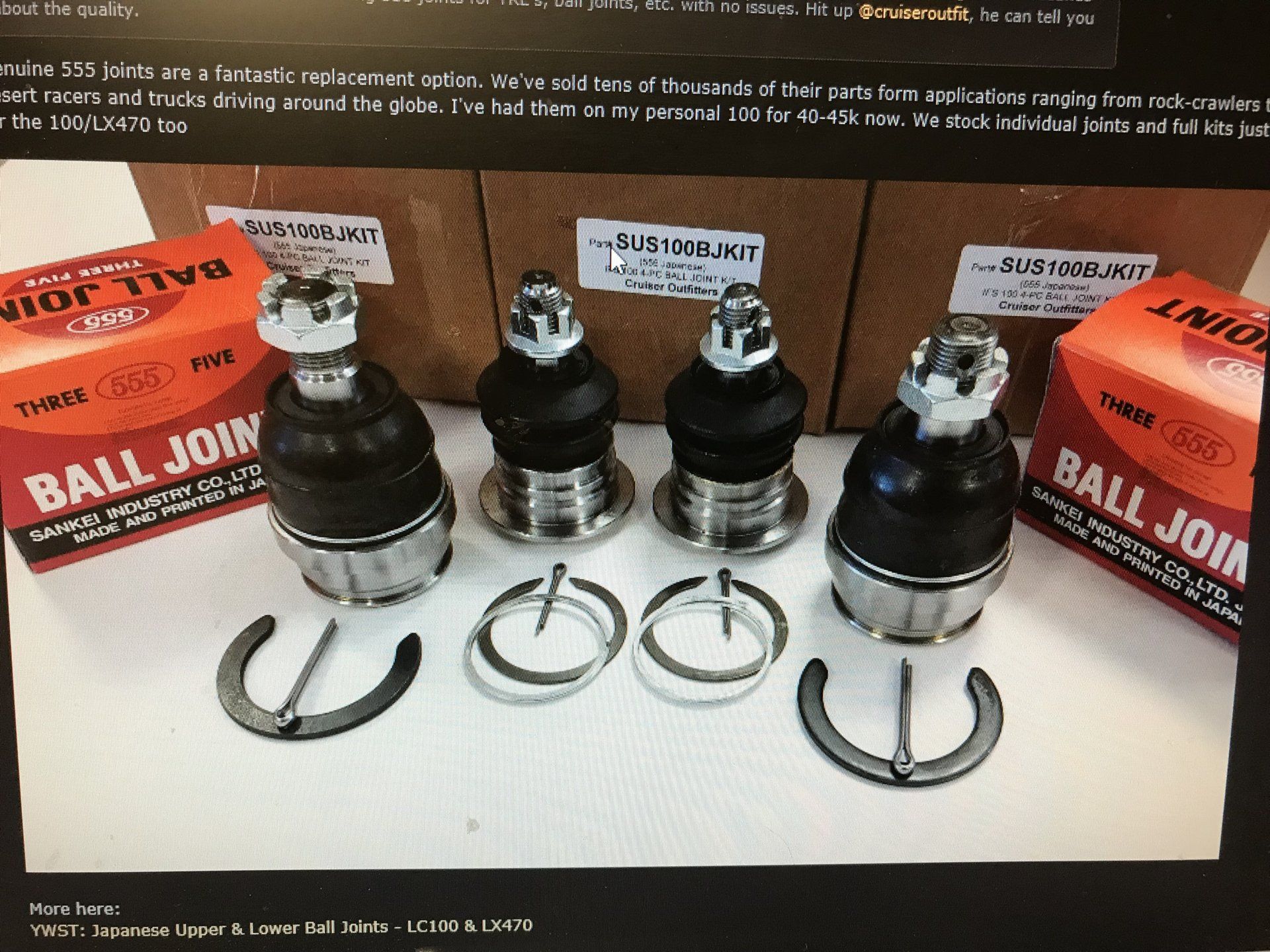

    Awesome. Thanks for the response. I'm a novice for sure, but trying to learn. One of the reasons I bought a higher mileage 18 yr old cruiser is so I could fix things and learn.
    So when you say whole assembly, I assume you are referring to the ball joint and boot kit like the 555's that 2001LC mentioned above? kit.jpg

    There is absolutely no reason to buy a complete arm. Get the 555s and a loaner press from the parts store and save a ton of money. Simple stuff.

    I know there will be a lot trying to comment about this post.
    I personally do not like 555 products. If you plan to keep the truck forever, why not get UCA and LCA's? Many on the 4runner forum and I myself have experienced the low quality of 555. The 3rd generation 4runner and 1st gen tacomas have a failing front lower ball joints. All aftermarket ball joints including Moog, 555, NAPA etc., lasts 20K miles (and definitely pops the ball out of its housing) while OEM lasts 150K miles without any issues.
    If the ball joints are good and are OEM, then replace the boots.

    In the case you choose to install entirely new UCAs and not just the ball joints do not trust the boots to last long, unless they're OEM. The only non OEM parts on my truck are the Dorman UCAs I installed. The boots rotted within 18 months. Crap.

    Honestly, I went went with some cheap moog complete replacements due to some time constraints at the time. Honestly they have been completely fine for the time I've had them installed. I did keep my originals to rebuild later on down the road. Think I've had them on for about 18 months now, and no issues.

    I am definitely talking about replacing the complete arm but it doesn't have to be oem.
    There our two huge problems with recommending a self described novice to press in new ball joints. 1. have the ball joint already been pressed into this control arm before? hard to say unless you're the original owner. 2. we assume the new ball joint will be pressed in perfectly aligned to the control arm opening.
    I have had one upper ball joint come out while on the trail that was professionally installed (moog 555). I have had one lower ball joint go bad do to a torn boot from rotted rubber Also moog.
    Based on my own experience i can not recommend a novice to press their ball joints in their self. I think there's a reason Toyota only sells the complete assembly.
