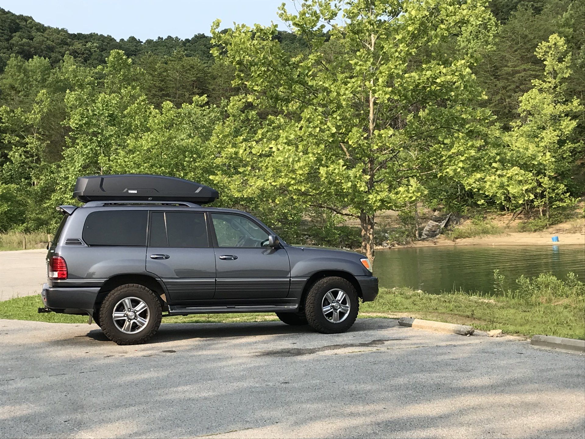

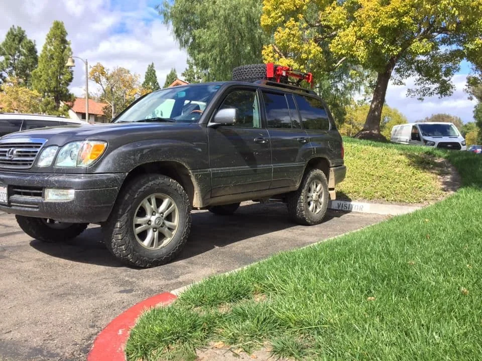

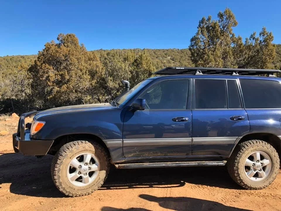

Below are the two different sizes. Posted on a thread in Facebook. The black one is 275/70/18. The blue one is 285/65/18.
