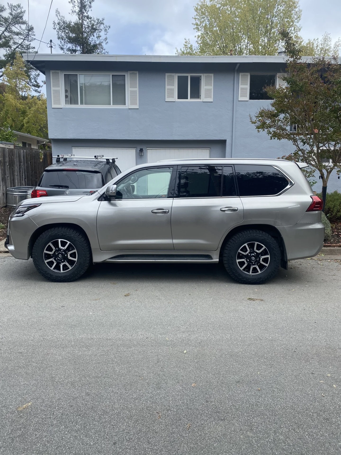

Confirmation on Tire / Wheel Purchase... looking for a thumbs up from LC pro's before I buy
Also, just to note, the ICON 17" wheels fit the newer LC front brakes, but they are very close to the rim. If the tire shop installs the stick-on weights in the wrong place on the rim, they will hit the brake caliper. That is how close the brakes are to the rim. Not sure if your LX has similar brake specs.
Hmm, yea I’m thinking 18 wheels for sure and 275/70 (32’s) as I’m not looking to push the limits of tires right now.
Figure I’ll want to iterate at some point, and that’s where I can play around with the AHC lift and larger wheels.

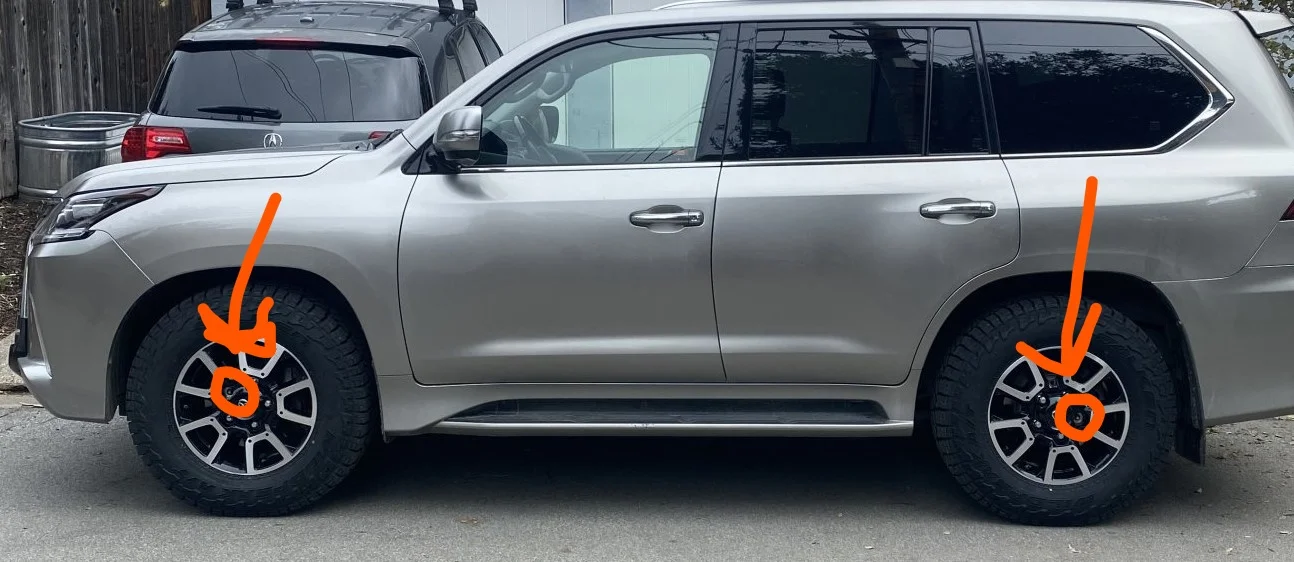

Do you know you are missing a lug nut on these two wheels?
HTH
My guess is an investment in wheel locks that haven't arrived yet or weren't installed for pic

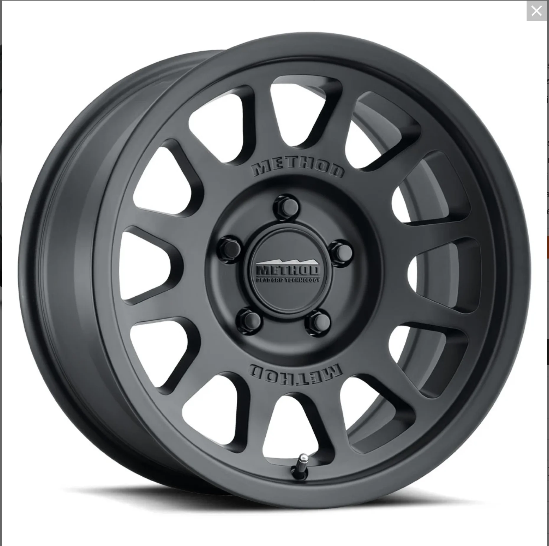

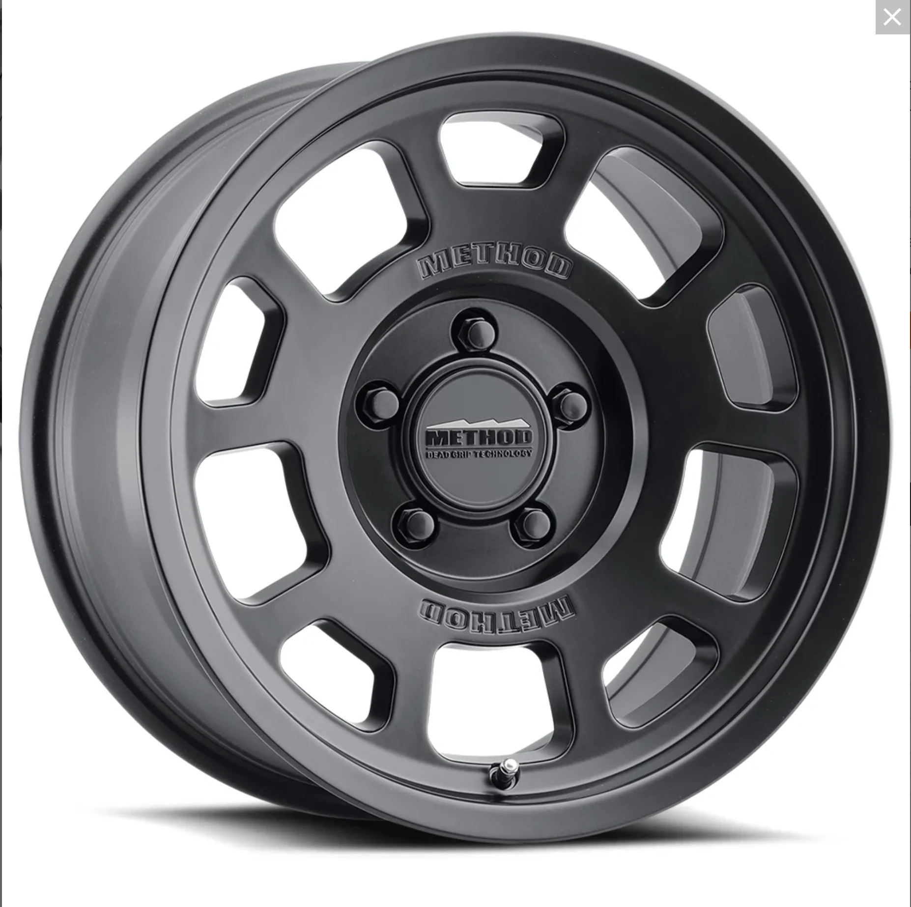

IMO the best offering right now are these two unless you want to import Evo Corse wheels at a +40. I dont know who sells them stateside.
I think +35 is great for stance visually.
I prefer the design of the 703 even though its heavier, not by much.

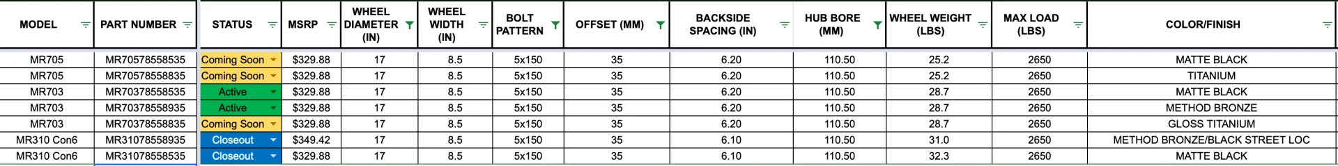

705: 703:
EDIT: Sorry I'm also assuming a plus size tire.

705: 703:
View attachment 2822762View attachment 2822763
