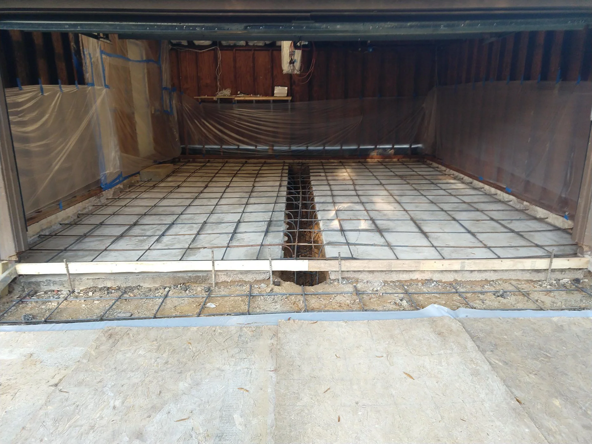

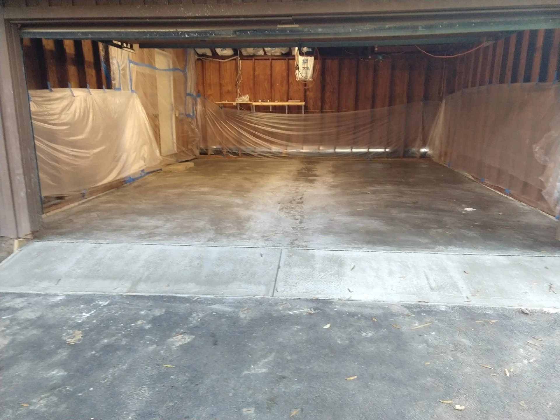

Thanks for the help. I have decided on a 3rd option my builder suggested and had my civil engineer friend confirm.
Going to cut a 2' "trench" in the middle of floor and put in a new footer. Will have re-bar running from side walls into footer. New layer poured on top between 2-5". One post of lift will go into new footer, other side will have a new 6" pad poured under it.
If there is interest I will post pictures of the work. Unfortunately the added cost will delay my lift purchase probably a year unless I find something used.
