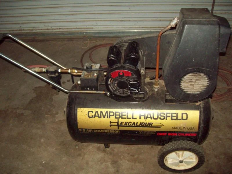

Hey, I have been wanting to upgrade for years but this small unit has pulled off everything I've asked of it. Just need some pateince on recovery time with those rare projects.
:cheers:
