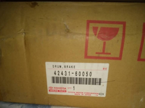

These Raybestos drums that worked for @2fpower didn't work for mine. Red Line said they are showing about 5/8" of shoe.
This is moving toward an axle replacement.
Does anyone have a 60-series rear axle they want to unload? :rolleyes:

I appreciate these links, @2fpower I’m still puzzled that those raybestos drums worked for your Dana rear but not for mine. There must be some differences between the Ute axle and the 73.
Can’t continue pondering this.
Moving on!
