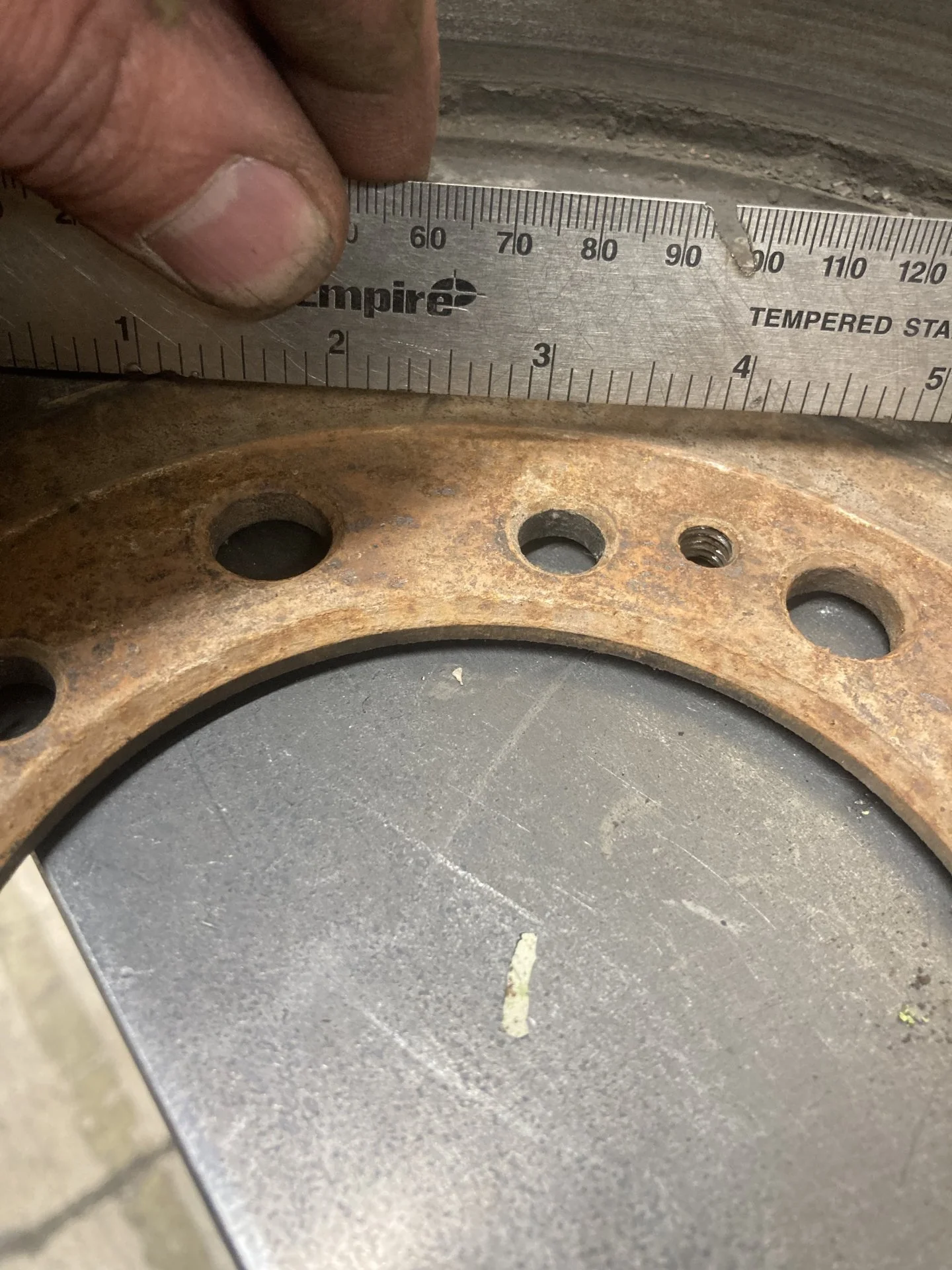

Ultimately, I need to get measurements of the drums and go through parts catalogs.

I am working on getting measurements from the shop and will take that route in finding something that works. There has to be an alternate part out there.

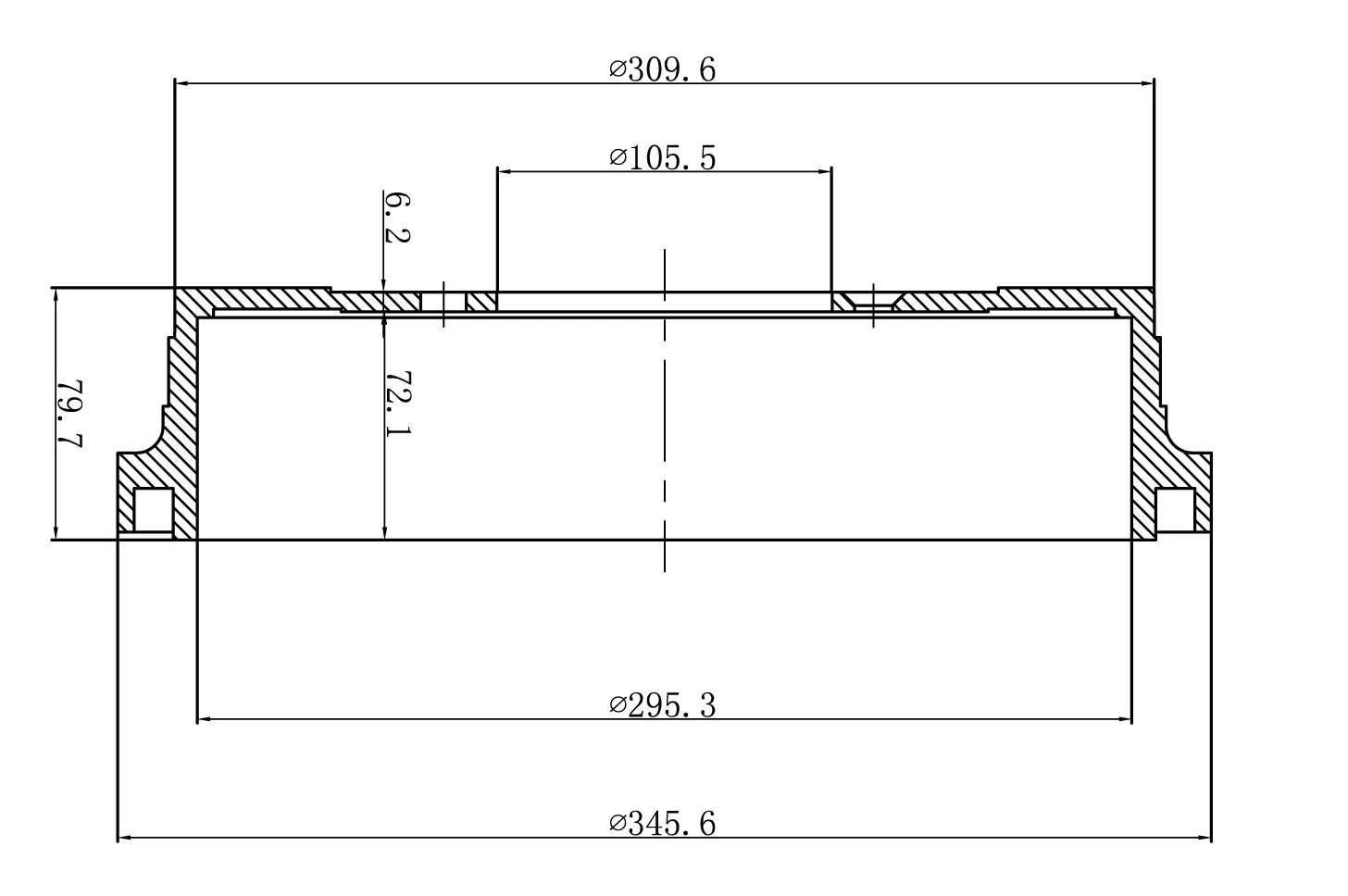

What about 42431-60070?
This site appears to claim the part number above is the same as 42431-60050. And it has measurements too.
AUTOTEC EBS - Products - BRAKE DRUM - https://www.autotec.com.cn/product/info?code=14423
Thanks for digging this up, @FJ73Texas

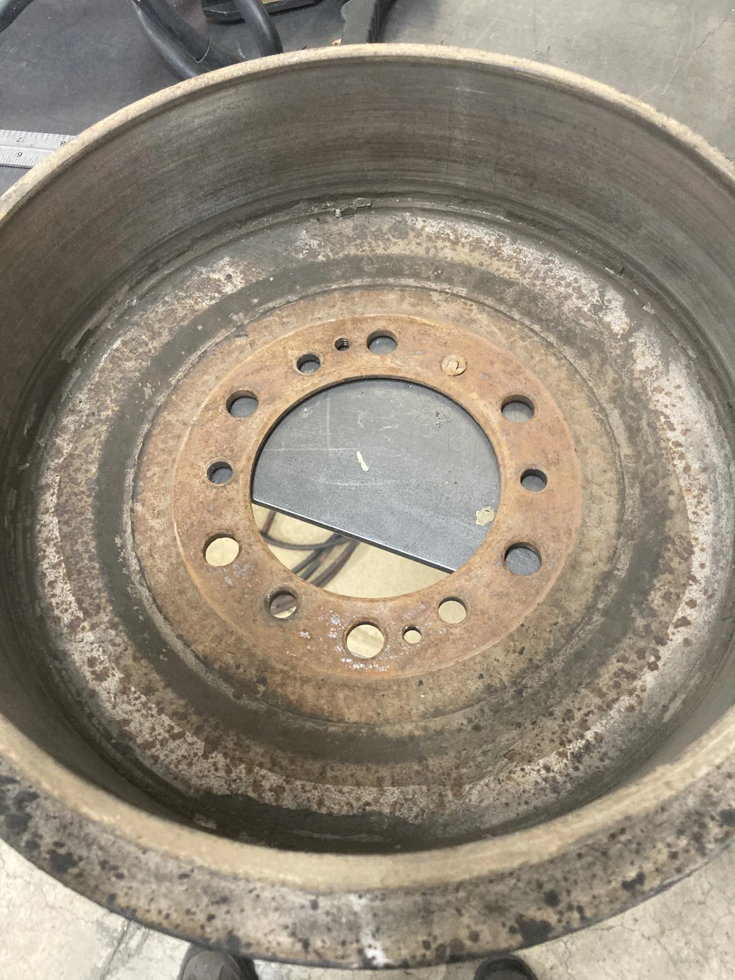

Photos of my drums show that they are convex on the out-facing surface so I’m not sure if these will work. I haven’t gotten the dims from Red Line yet so I haven’t been able to do any searching.

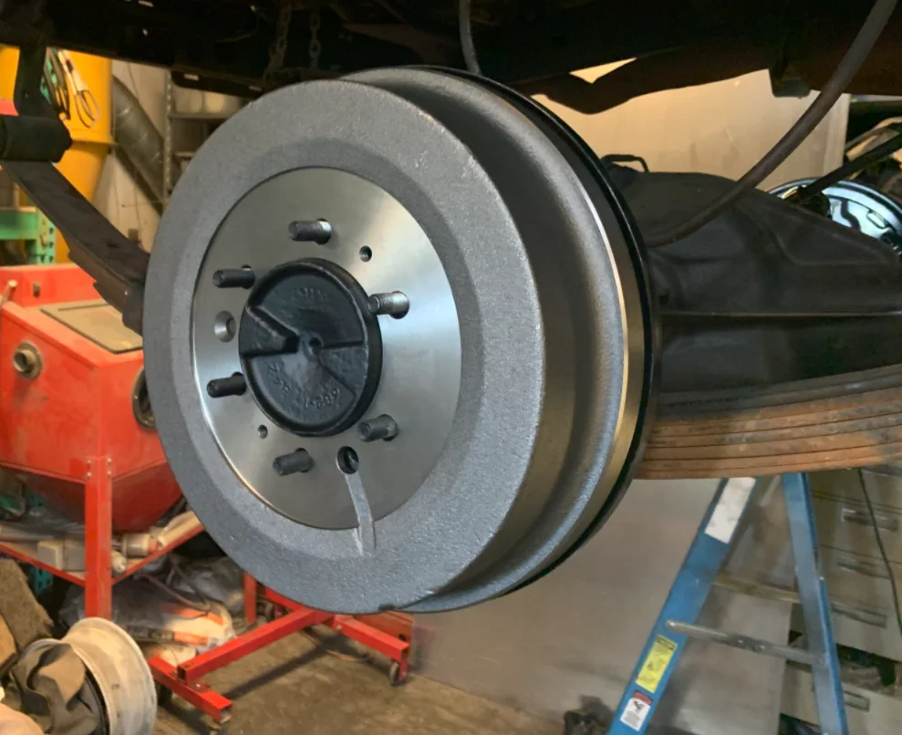

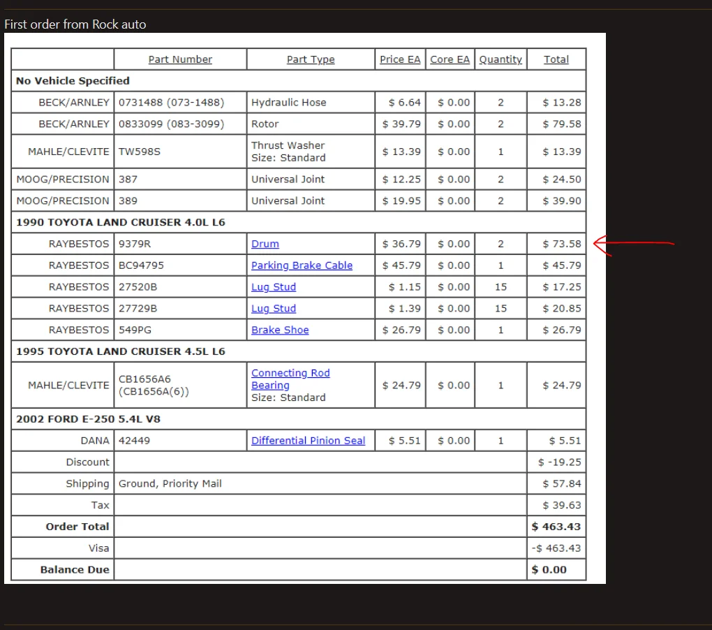

just looked back into my VZ shade tree build. I put new drums on it. Not sure where I got them from.... typically I put part numbers in the build. I will go back in the shoebox of receipts and see... pretty sure they were sourced in US.
found it.... I have lots of info on the rear brakes and well every frickin' other broken system (all of them) on this thread.
Got your pm that you are trying to match the dished out look of the ones you took off, but really , who can tell you that what you have is stock, oem? I would get one of these, maybe from a local supplier and see if they work. If not, return them. But mine fit perfect and was the same central american stupid a$$ non toyota axle you have..... Having said that, DANA company was awesome to get information from.... so I wish them no evil spirits.
