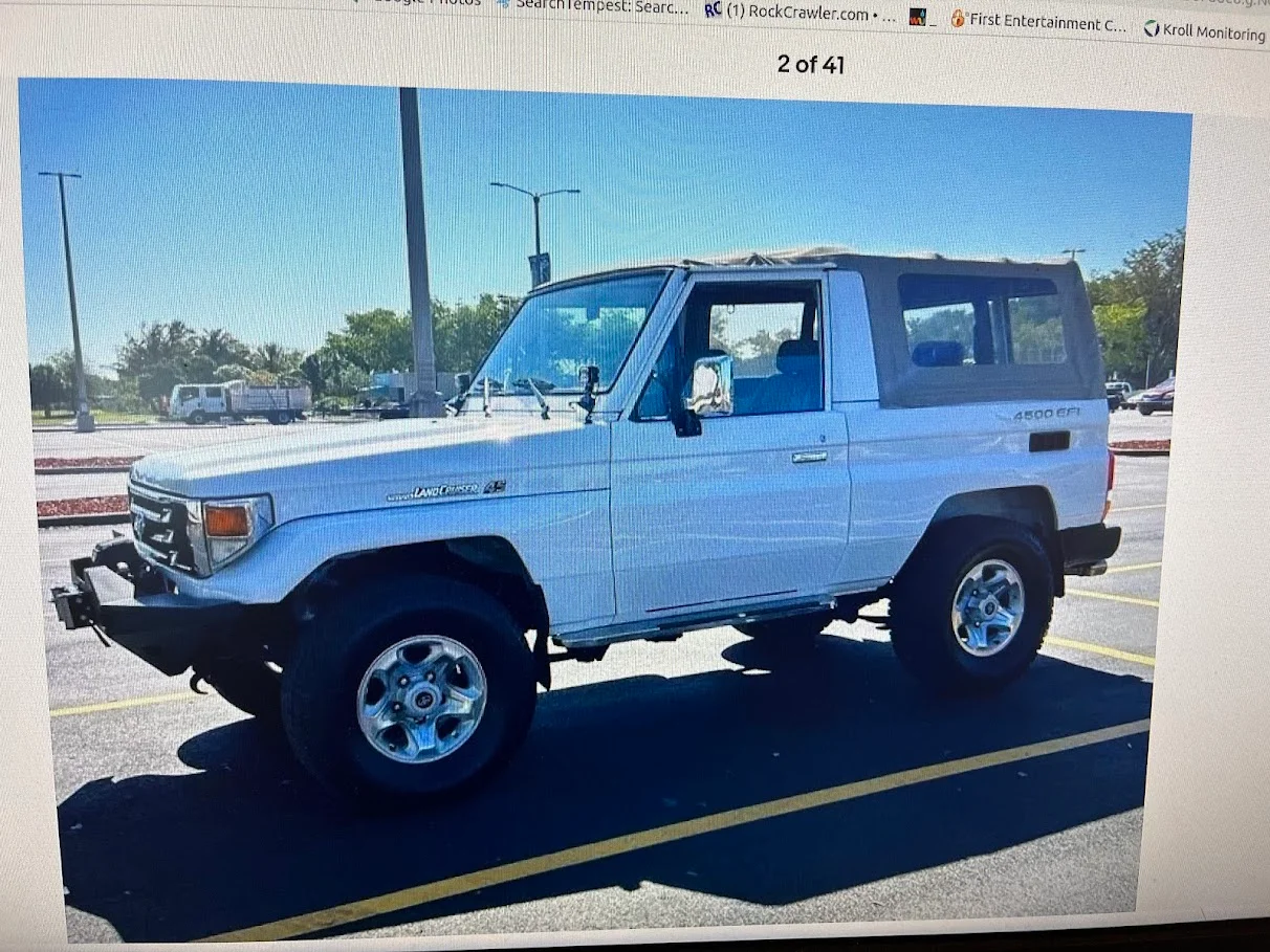

But I can't help Myself this has to be one of the cleanest LHD 73 I have seen. It's a 1998 ( not lipstick on a pig ) low miles and looks to be all original except the tasteful front bumper & touch screen stereo.
It's a dream truck for me as it has the Coil pack 1FZ, 5 speed, manual shift transfer case & AC. It also has the Coil spring front axle ( like a 80 series ) and a soft top.
Sorry for the crap pik.
My question for the great minds of Mud would this be a kit assembled Colombia like the early 73s that went to SA or were the late model FZJ73 built in Japan and imported Colombia ?

Colombian 73 Series had FZJnnnnnn frame numbers between 1995 and 1998. This changed to 9HX (or 9FX, I do not remember it exactly now) in 1999 and remained so until 2005. I understand that 9H is the country code for Colombia in the 17-number VIN designation system.
VIN plates from Colombian CKDs had the number in relief, in contrast to embossed numbers from Japanese trucks.
Colombian 73 Series got the 1FZ-FE engine in 1999. Some late model 1998 examples had it as well. They did not have the coil pack, late model 1FZ-FE variant.
The truck from the picture has five stud wheels. They are specific to post 1999 70 Series. Colombian 73 Series had six stud wheels throughout their production run.
Colombia-spec 73 Series had leaf springs in the front axle. This truck has coils on its front.
To me, the 4.5 badge and the front grill look suspicious. So do the front coil springs, the five stud wheels and the claims about the engine.

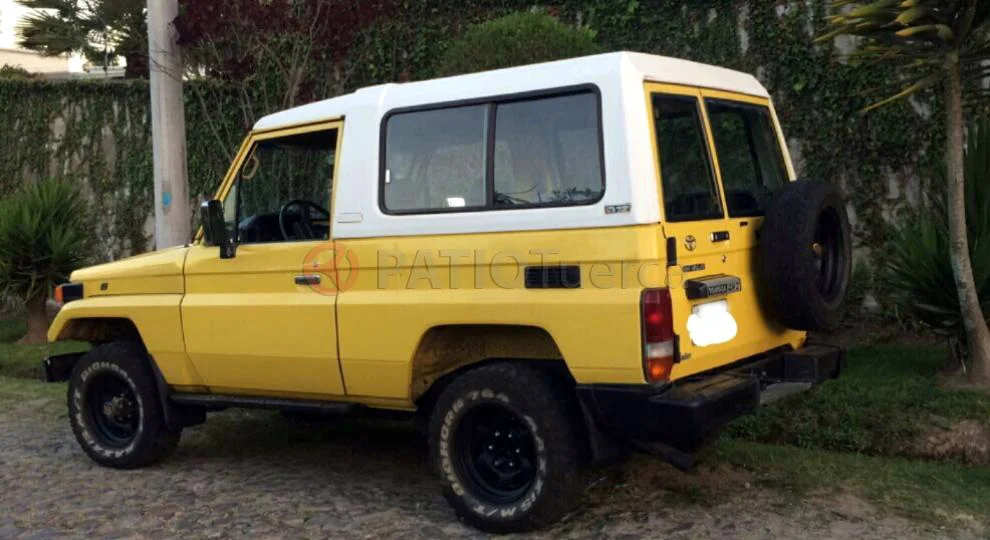

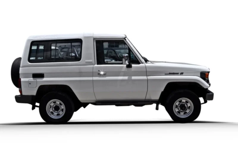

These are 2000/2004 model year Colombia-spec 73 Series. Note the leaf springs on the front and the six stud wheels.

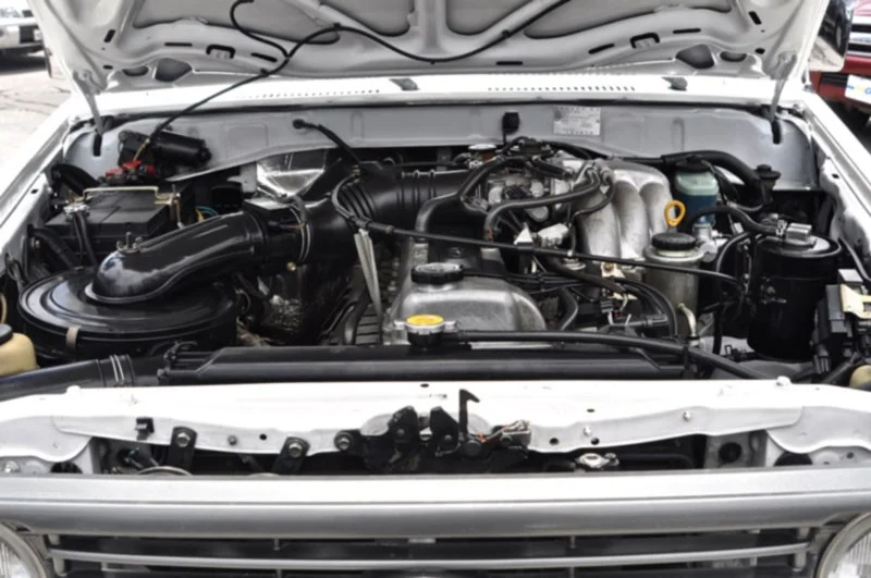

The engine bay from a 1998-2005 model year Colombian 73 Series should look like this. Notice that it is not a coil pack 1FZ.

I suspect this truck had the drivetrain and suspension of an FZJ71 swapped in.

It is not just the coil pack. The inlet manifold, the mass air flow sensor and other details give away a late model 1FZ-FE engine.

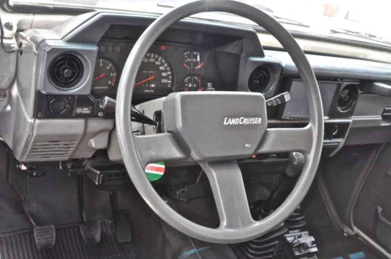

If this truck has a properly made engine/drivetrain swap., the instrument panel should be that of a post 1999 unit.
Coil pack 1FZ-FE engine have slightly different harnesses and electronics. The speedometer cable uses a pickup sensor instead of the worm gear.
If the dash is similar to the picture below, the swap did not include harness and electronics.
By the way, this is from a 2004 FZJ73 without coil packs.
It would be good to have some more pictures.
