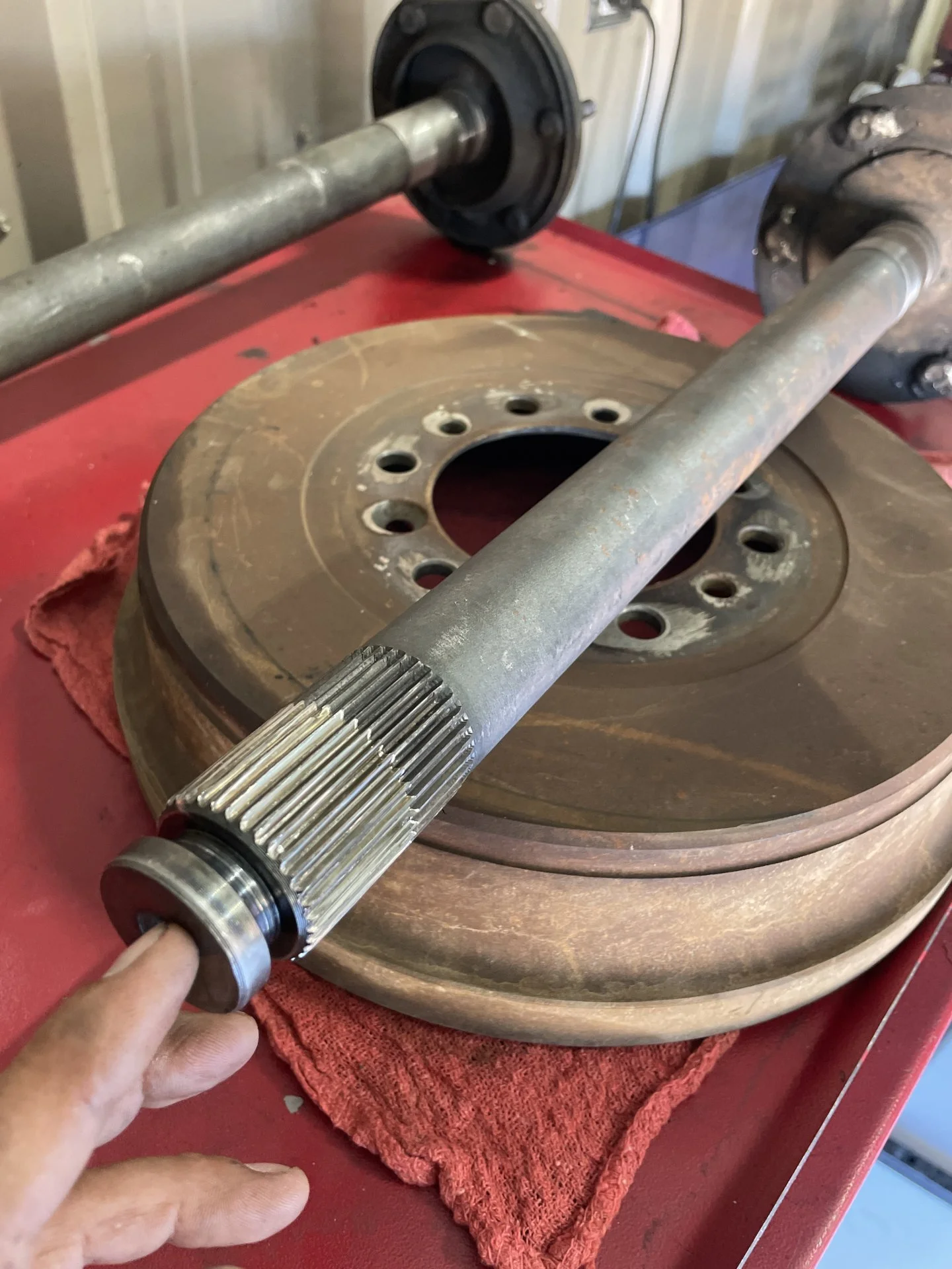

You are right, it is definitely 4.11s. My diff is open and I want to install a rear locker but I need to know the spline count to order the correct one. I could crack mine open to check the axle spline but just figured some one here might know from experience. I read a few post on the ol internet, all taken with a grain of salt, and it was stated that they were 35 spline and all the Colombian and Venezuela Dana 60s from 1993 and on used C clips.
I’m gonna send you a PM on the Drums.
35 spline.
Thanks!!!!! Seems to be to consensus that 35 spline was the standard axle in these and C clips from 1993 and newer
Am I correct that the studs here are for holding the axle back plate on which means no C clips ?
