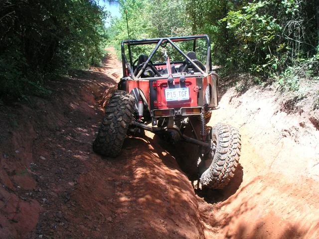

minimum 14" strokers all around, ideally as "straight up and down" as possible, will mean thru tub in rear and no fenders in front....dual rate coils with tender, stick to 2.5" body for more coil availability. Figger minimum 37" tires, and a very likely an upgrade to your axles system.
35" links plus heims fit nicely all around, for street use do a twin Y-link front with panhard so you get some road handling.

I would agree with woody about the 14"ers. I have 16s and they are long sobs. I perfer to angle mine so they don't go beyond vert during articulation, and have most effect at full comp and droop. Also having the lowers angled out a bit should help with tire clearance and the feel of stability. Although this option requires the frame to possibly be notched or modified.

yep, I have 16" saw's on the front of my rig. Very happy with them.
The limited wheeling that I have done with them has made me love the CO in comparison to a SO.
I am not positive that I agree with Woody on the vertical thing. I think they can easily be angled slightly for more articulation with no loss in effectiveness.

I am running 14" SAW coilovers in the rear of my rig and love them.

I am running a SOA front with CCOT HFS FJ-40 springs and 14" SAW coilovers in the rear 100/150.
