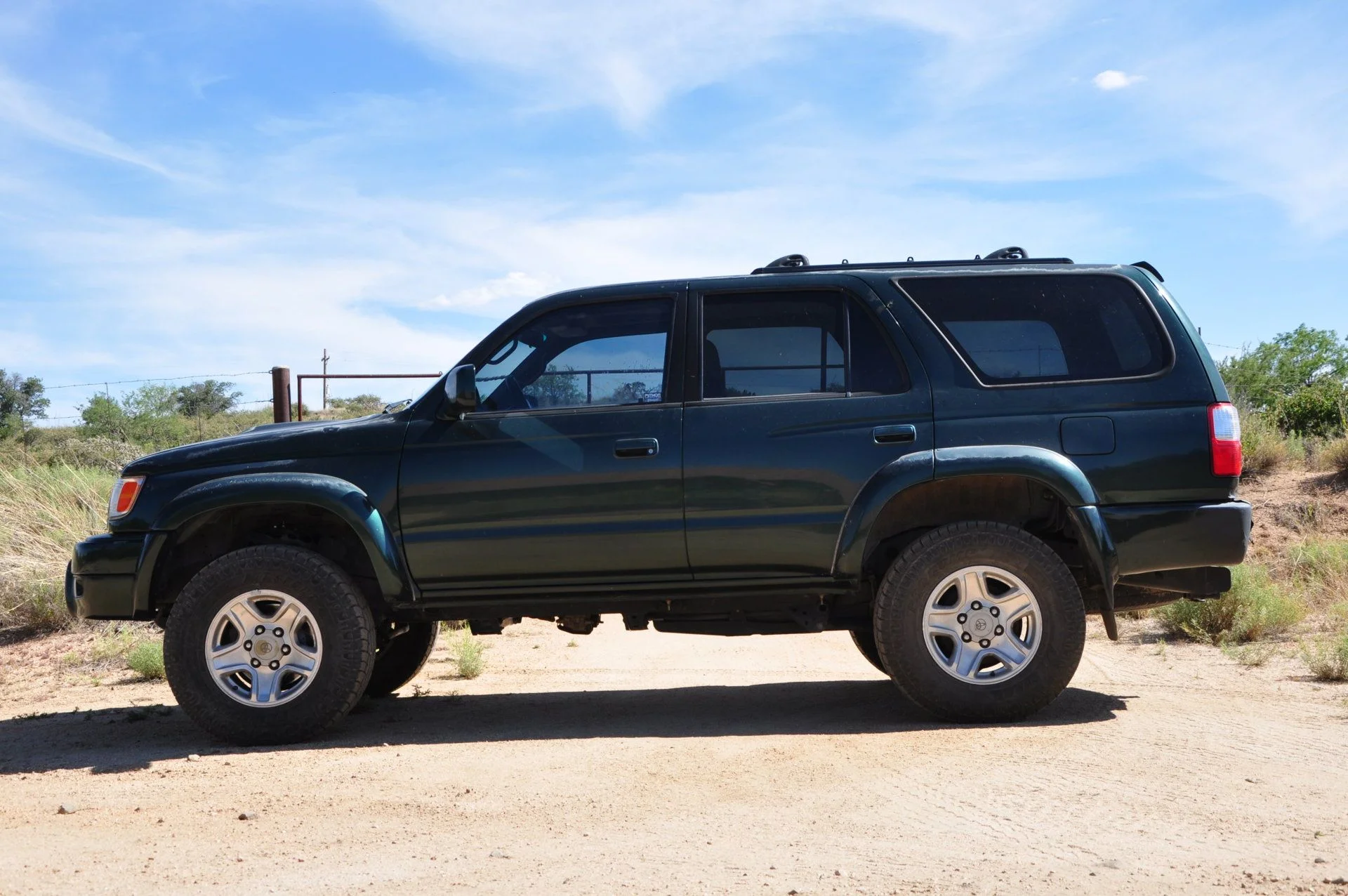

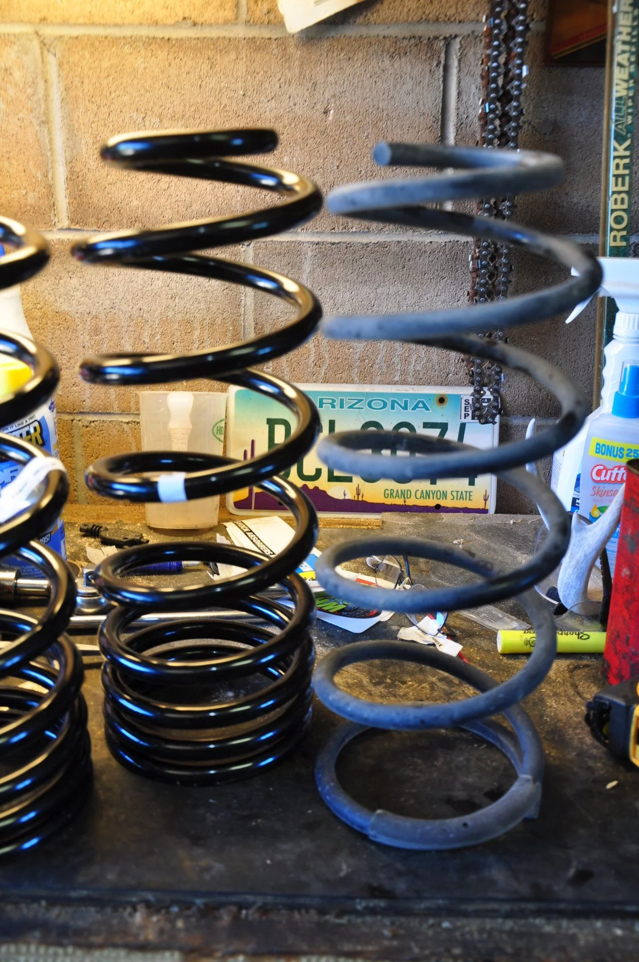

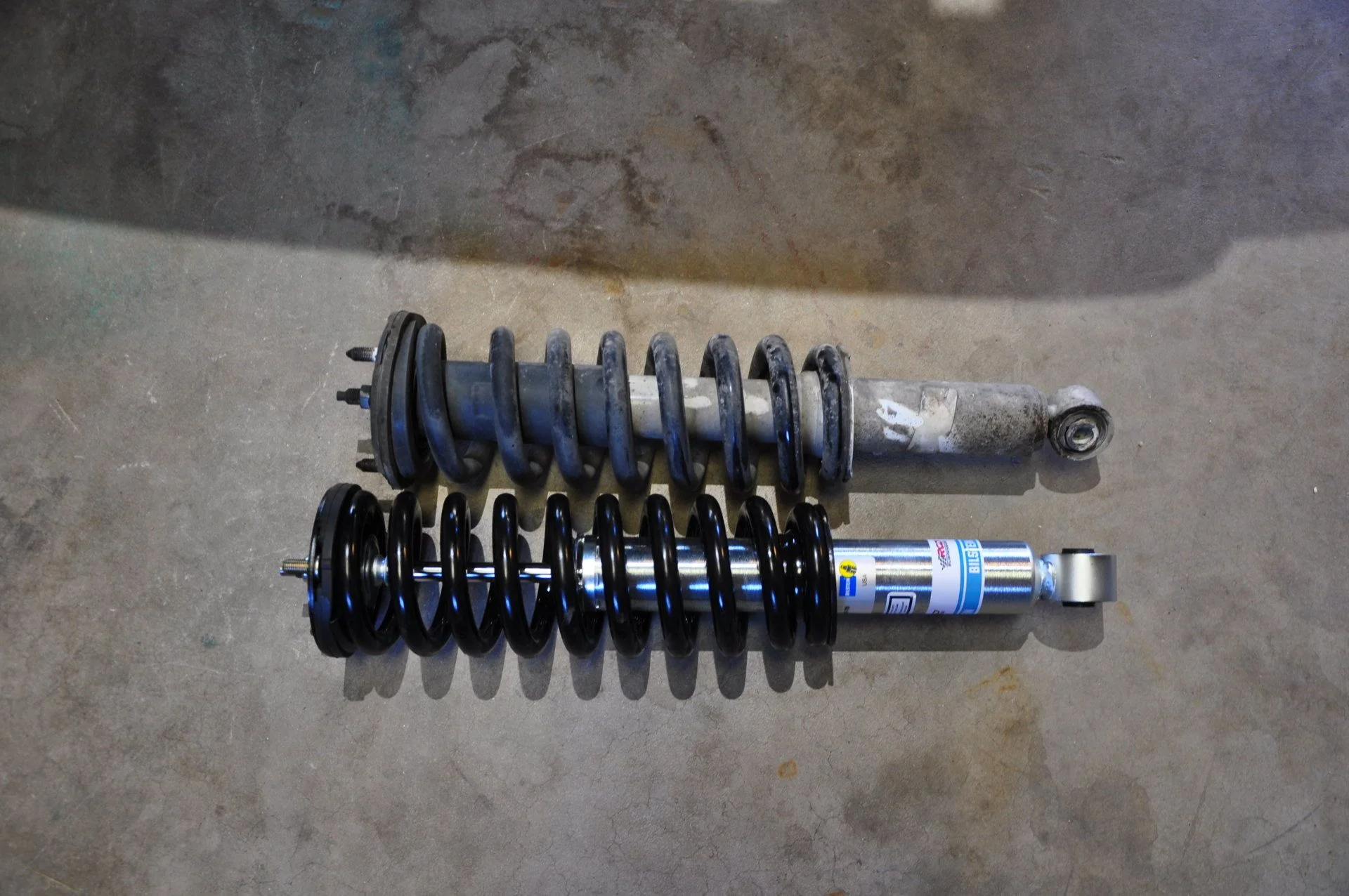

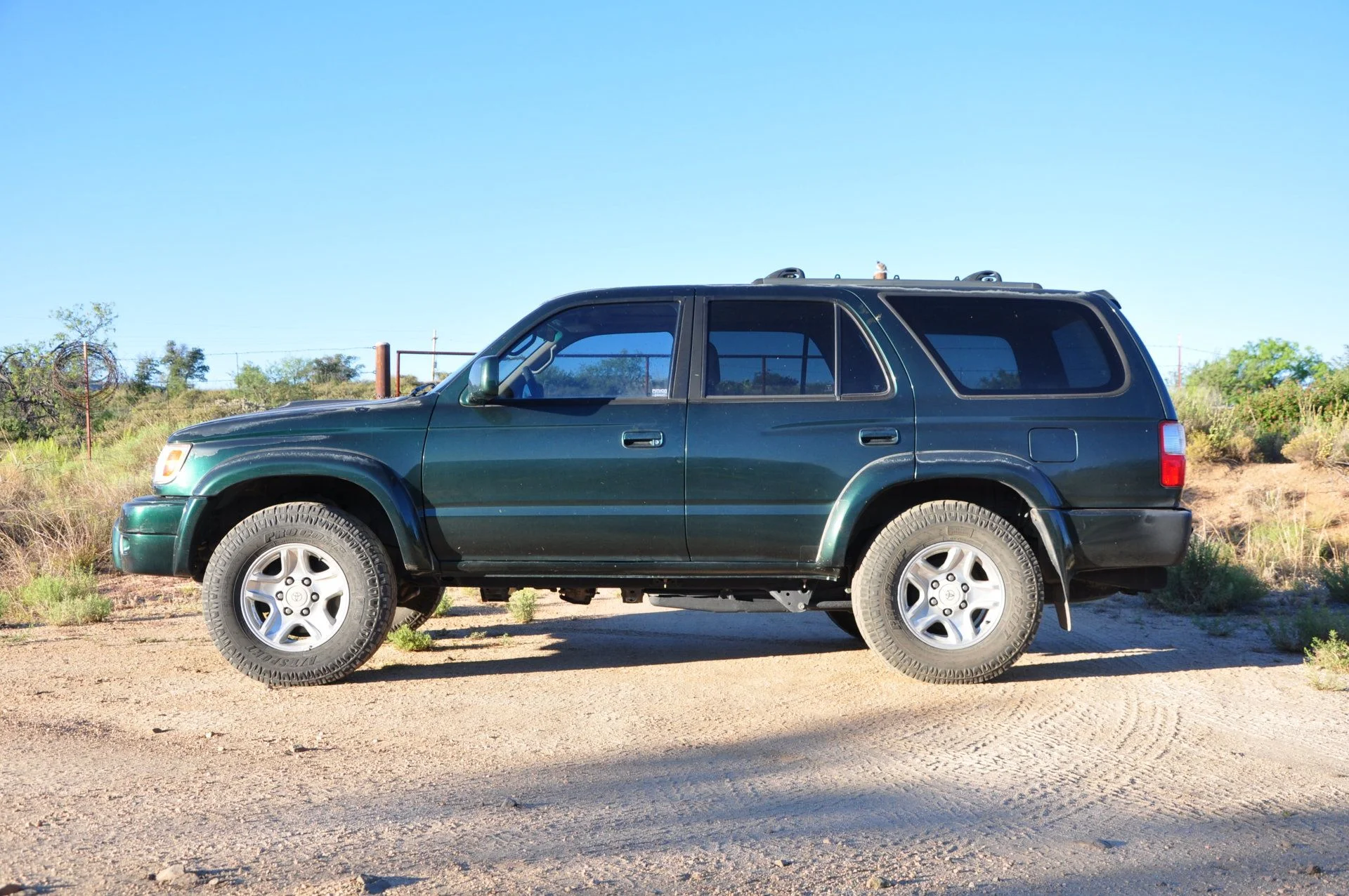

2001 4runner with severely sagging coils riding just above the bump stops. I was looking for a mild lift (2") and an extra 500 pounds of load capacity. After research, this is what came up with...
OME 880 coils in the front.
OME 906 coils rear.
Paired with Bilstein 5100's
The 5100's have 2 options (which the installer will have to choose from).
I opted for the F4-BE5-D558-TO for the front due to it was toted as having a better wiper seal. These are ride height adjustable and I chose the middle circlip position.
For the rears, it was a toss up, I went with the longer 4R5100's as they were advertised as being "A little softer valved"
Ride is awesome and the just under 3" over what I had is exactly what I was looking for.
Before and after....
