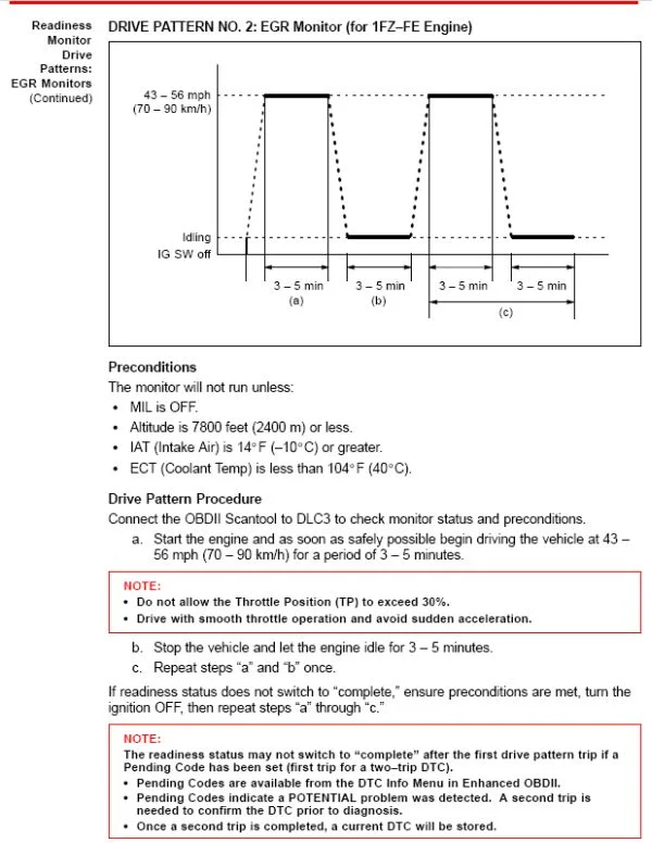

Tripping the P0401 is a relatively complex series of operating variables and it is a 2-trip logic. One of those variables is the intake air temp. If it has been cold where you live it is possible the conditions have not been met and your code is just "waiting" for the temperature to rise.

There have been several of us that suffered from an intermittent failure in the VSV for EGR. Once it starts failing on a regular basis, you will see how the 2-trip logic works.

The two trip logic gets funny. There was a certain section of road I would travel in the old days that would guarantee me a 401 code because how I drove it matched the trip logic as described in the tech sheet Beowulf posted.
