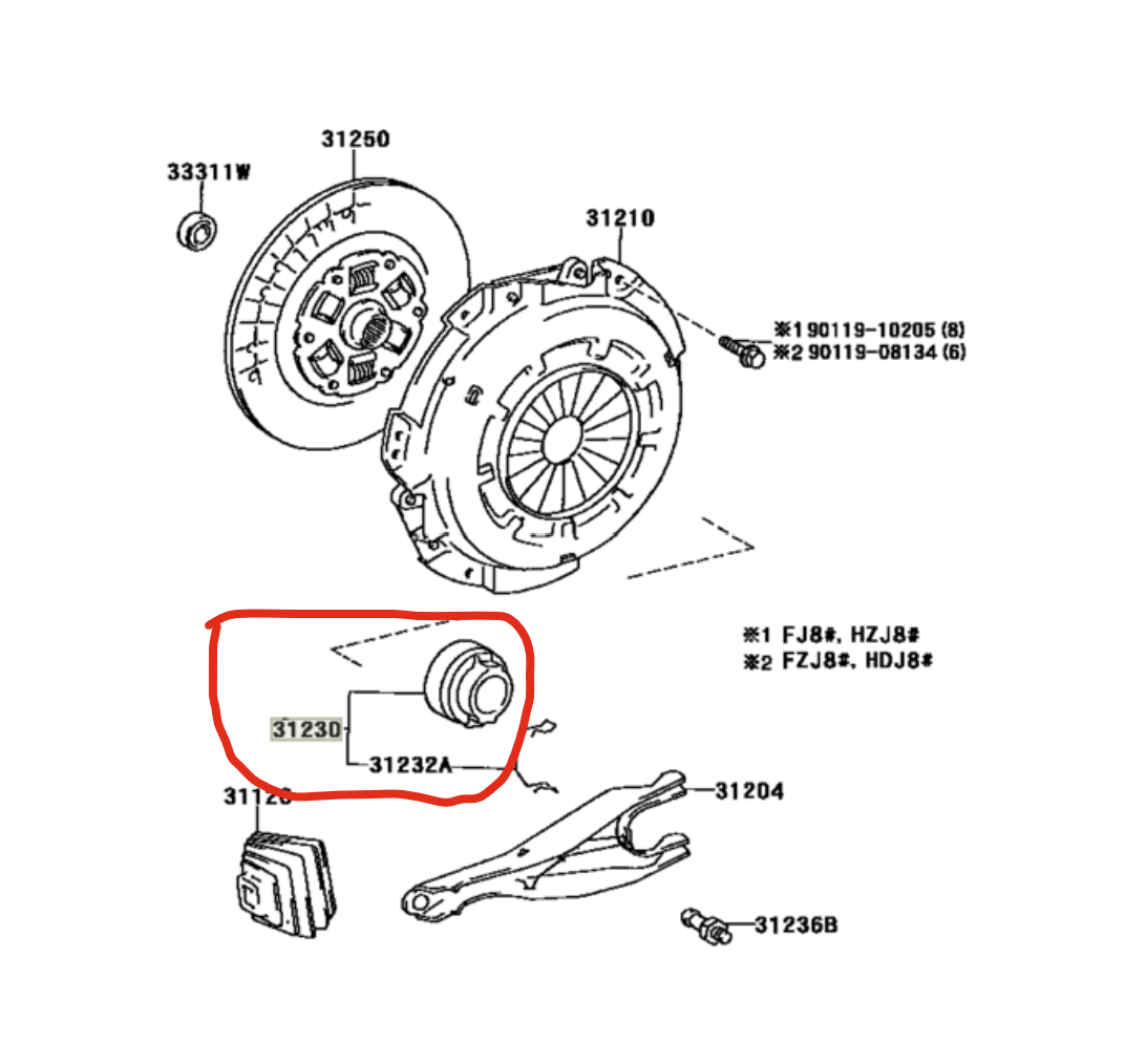

So my clutch makes this cricket-like sound when it's fully released and the car is coasting along (or idle), looks like it's there at lower rpms when there's a little bit of vibration. Pressing the clutch slightly (i.e. putting a bit of tension on it, maybe 1-2cm of pedal press) stops the cricket. I verified that there are no actual crickets anywhere in the car (and it's not the season anyway), and my indy thinks that this bearing is going - 31230-60151, Bearing Assy, Clutch Release.

2) but more importantly, it seems like to replace this, the transmission needs to come out, according to him, and if that's the case, then the "while I'm there" rabbit hole begins, and so, what else should replace while I'm there? Any seals, parts, anything? Clutch itself?
been a while since ive had a manual car but the bearing that is pressed into the flywheel could also be causing the chirp sound, i think theyre called spigot bearings
I would always replace that one whenever I did a clutch replacement along with the one you have circled which is pretty much mandatory with a new clutch

Car has 150K kms. I have to check how expensive the clutch plate is - although the feeling that I have is the work will be far more expensive than the parts :) When you say pilot and spigot bearing - is one of them the clutch release, or is that a yet third one?
Pilot bearing is in the end of the crankshaft. It supports the top of the gearbox input shaft.
Aussies call it a spigot bearing.
The pilot bearing, and the clutch release bearing are both sealed units, so they have a limited amount of lube for life.

Working on the parts list for this - thanks for the list. Am I correct in thinking:
- pilot bearing - "90363-15017 Bearing (For Input Shaft)"
- throw-out bearing = clutch release bearing = "31230-60150 Bearing Assy, Clutch Release"
- clutch plate = "31250-60401 Disc Assy, Clutch"
- pressure plate = ??
- slave cylinder = "31470-60180 Cylinder Assy, Clutch Release"
- rear main crank seal 90311-99009 / front crank seal / seal retainer? - any idea where these parts are listed?
- anything else?
Thanks - appreciate the help!
