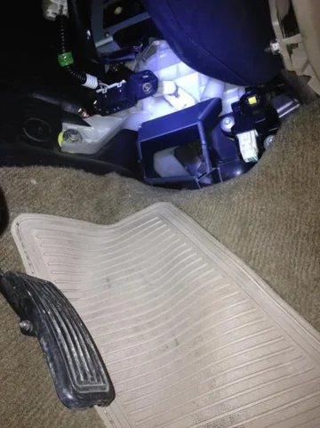

So I looked for this but never found it. Here's a pic of the heater floor vent area:

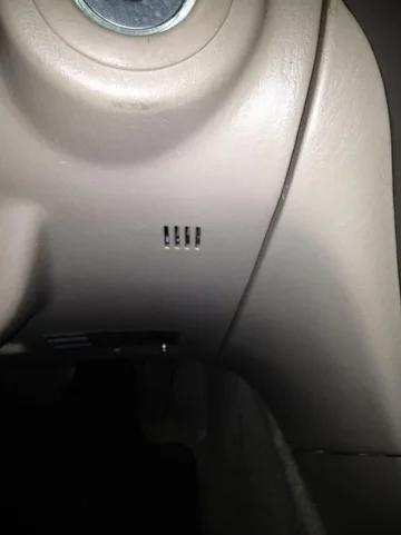

This is what you're looking for. Hose attaches to back side.
So thats what that opening is for, hmm. Thanks.

And mucho thanks to you guys. Took it apart:
1. Yes, the corrugated hose was indeed disconnected and just lying there.
2. The temp sensor was dirty with dust.
Cleaned it with some rubbing alcohol and q-tips, and reconnected the corrugated hose. And viola! Problem solved. Thanks again. Here are some pics:
Now that I look at it, mine has fallen off as well. My AC works fine. I always thought that hose was a drain for something. I thought it was a strange place for a drainage line lol.
That was about what mine looked like.
12 years of dust and frass on the temp sensor completely disabled the heater. Spent all last winter chasing possible air mixer door servo problems, and it was this little bugger the whole time! Yours is nicely cleaned up and shiny just like mine, and the heat is a great payoff for this simple fix.

nice. :cool: honestly, it was pretty easy to get to. And it has 100,000 miles and 15 years of dust and it still wasn't as bad as it could have been. But, a little door/hinge on that slotted section of the knee panel would be nice. Just flip the little door open, spray some compressed air, and you're done.
