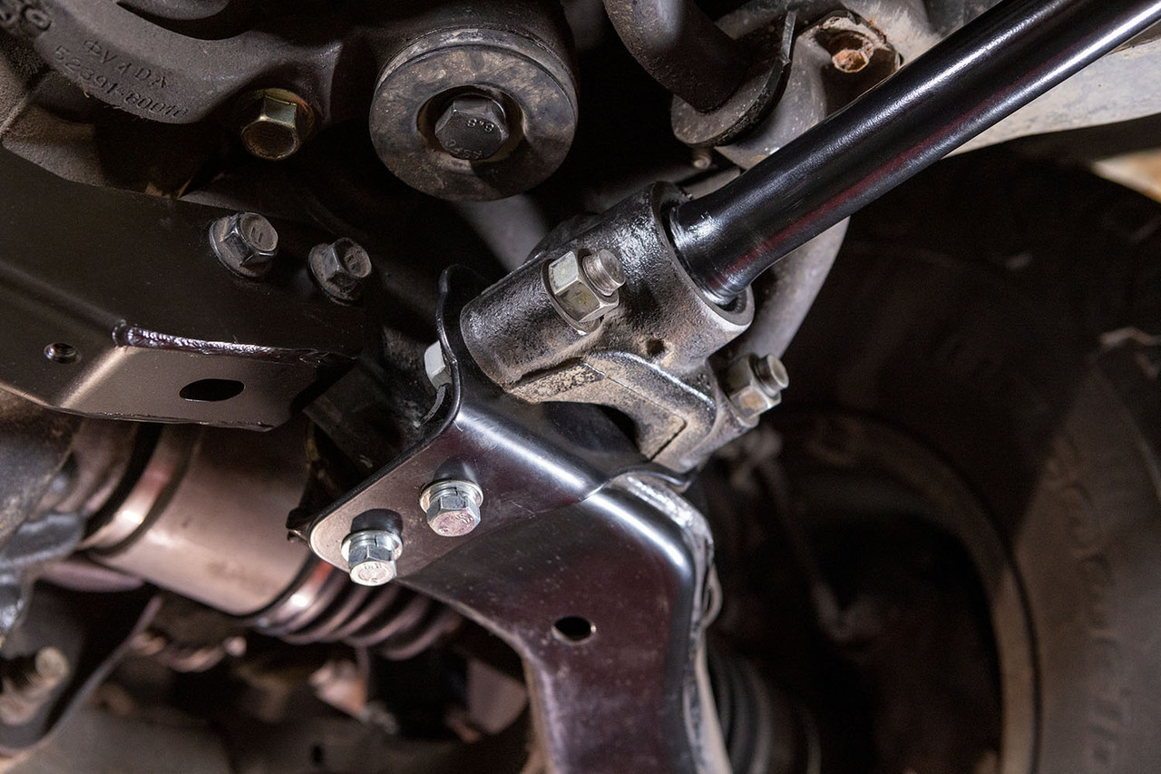

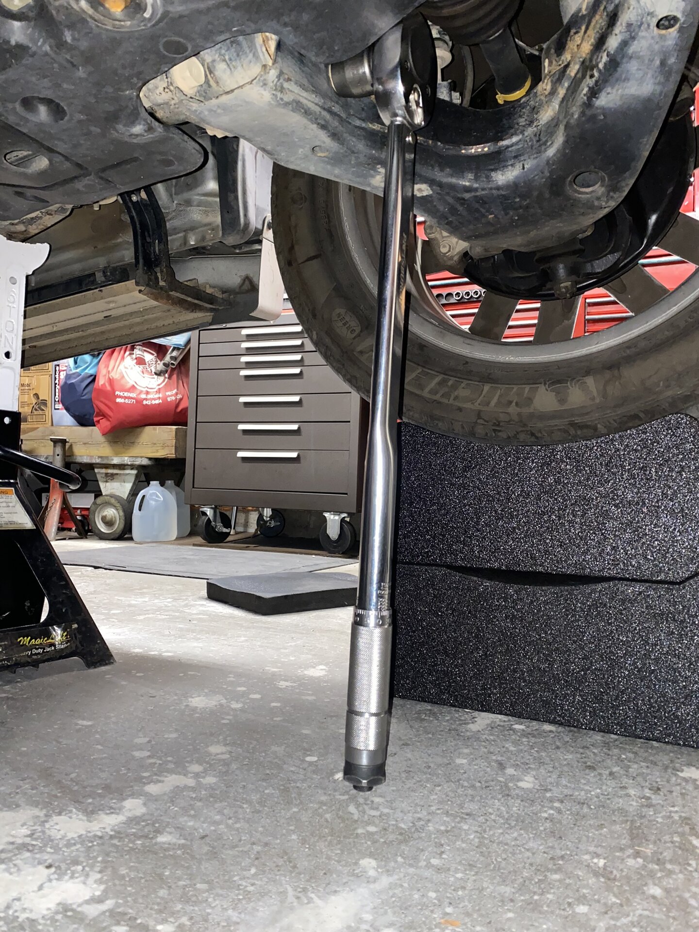

BTW: When torqueing down bolts holding bushings. You want the vehicle at a neutral stance. With weight on tires is best, IMHO! Some just set LWR at neutral position, while in the air on jack-stands. But loading the bushing with weight of vehicle. Which, is required by some manufactures, for warranty of some shock.
I've heard one or more of these click, when not properly torque in with vehicle on the ground:
  1. Shocks lower bolt.
  2. Stabilizer LWR bolt.
  3. LWC bushing bolts.

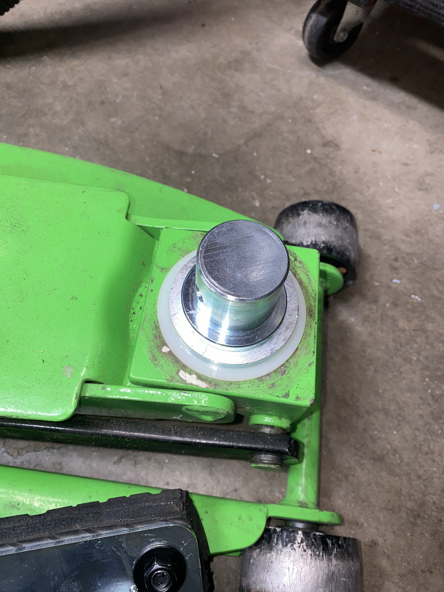

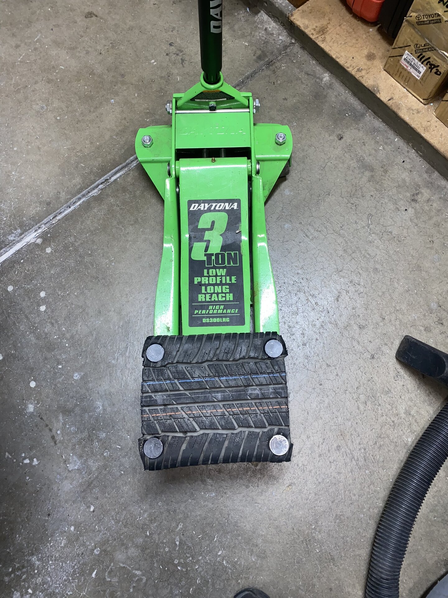

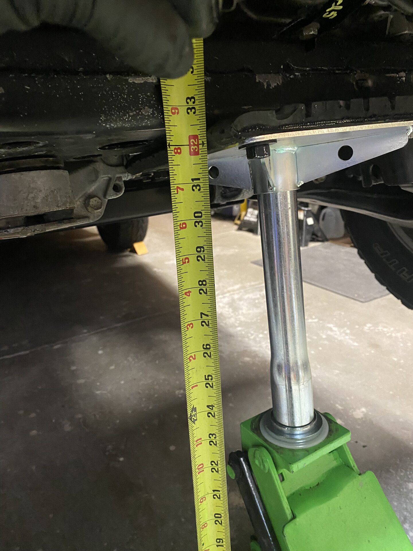

I've set up with Race Ramps, to torque these:
I've also customized my floor jack, to increase lift just for them.
View attachment 3536806View attachment 3536808View attachment 3536807
