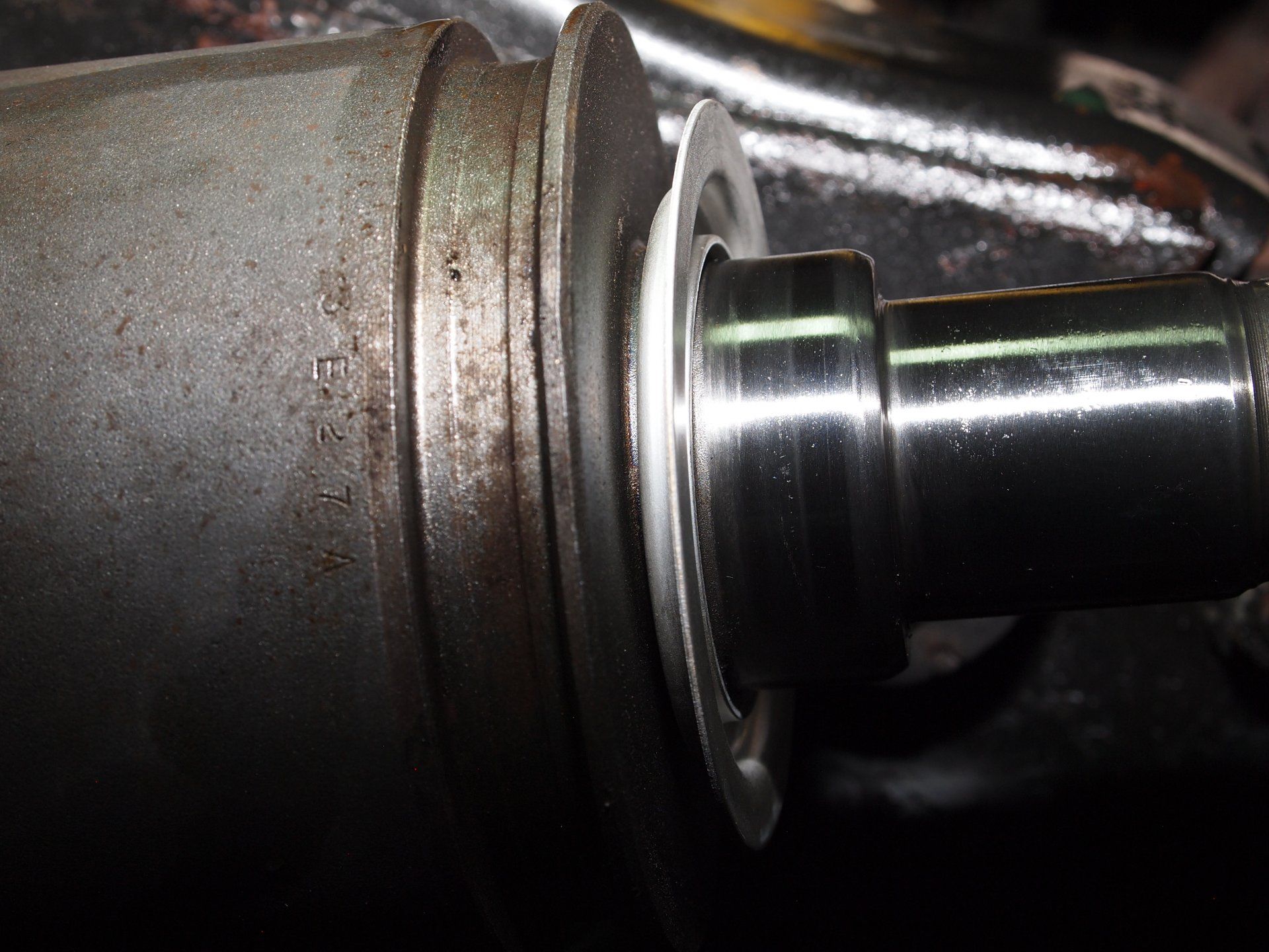

I see time and time again reports of after a lift clicks. Clicks generally start 5K to 20K afterwards. The CV of FDS (front drive shaft) don't like inclination changed.

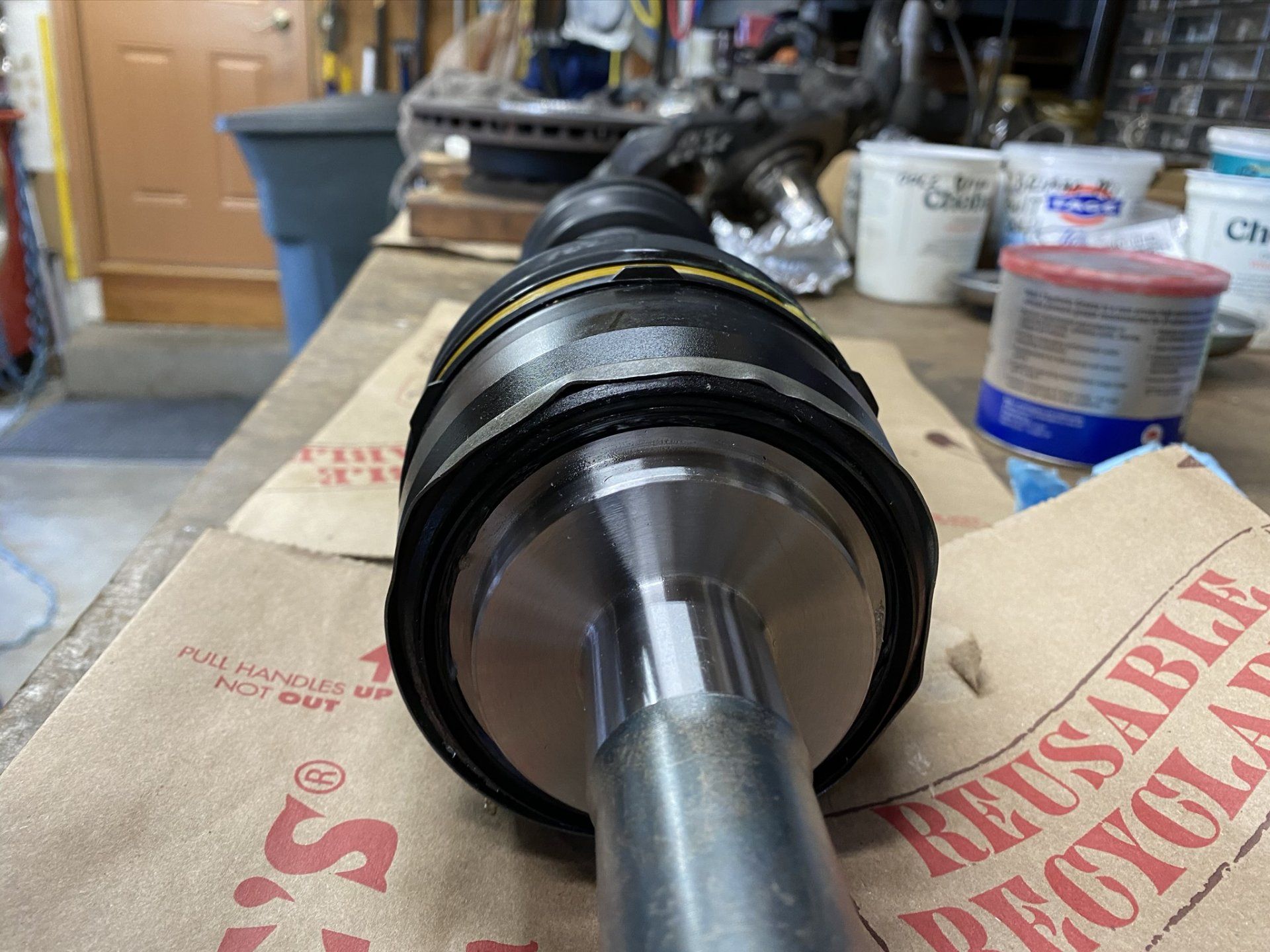

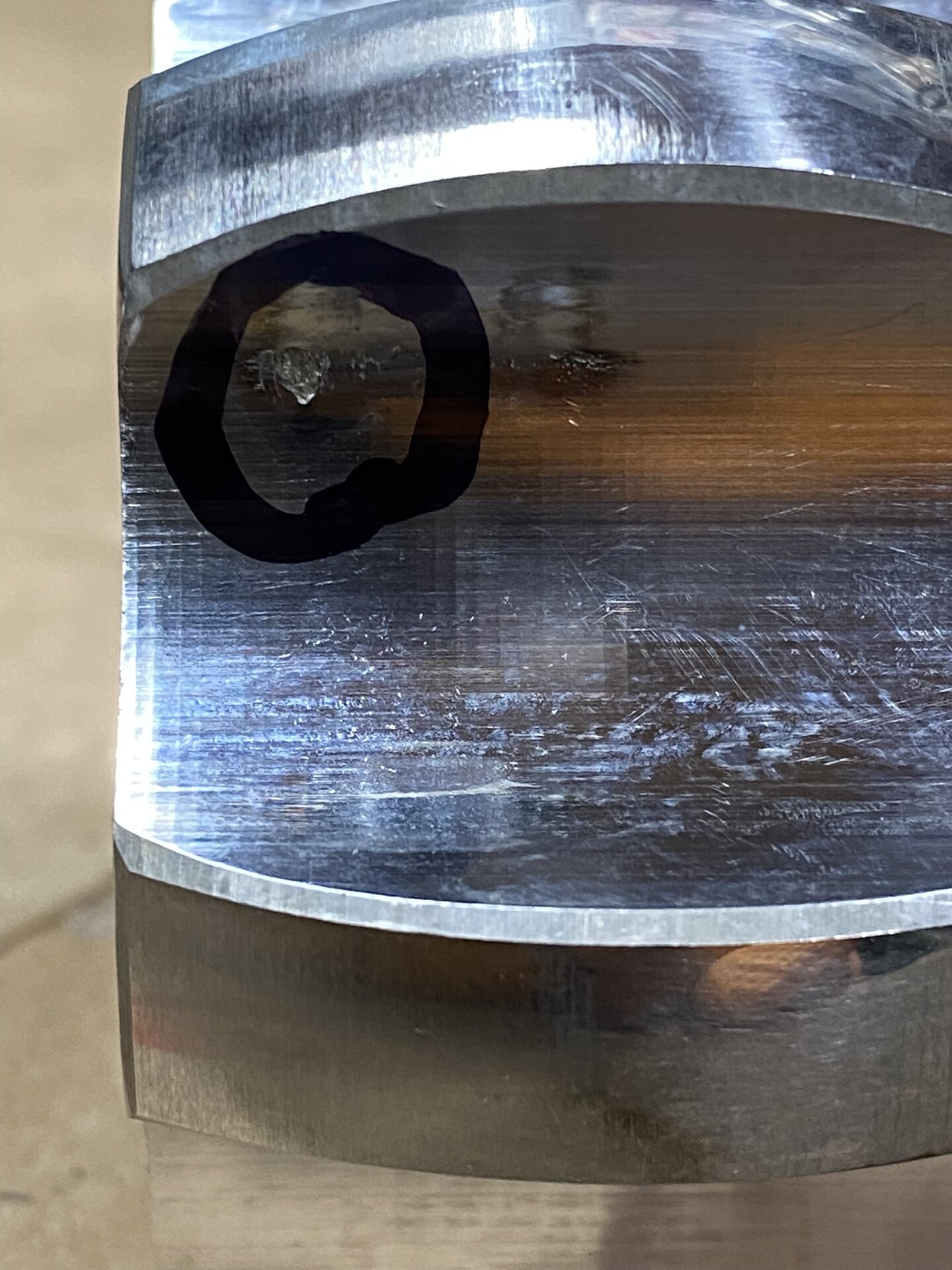

This one was lifted after 200K miles. Then after 50K miles, CV was taken apart. Notice ball scoring in tow position..
Not so easy test. Need to get front drive shaft in as straight as line as possible.

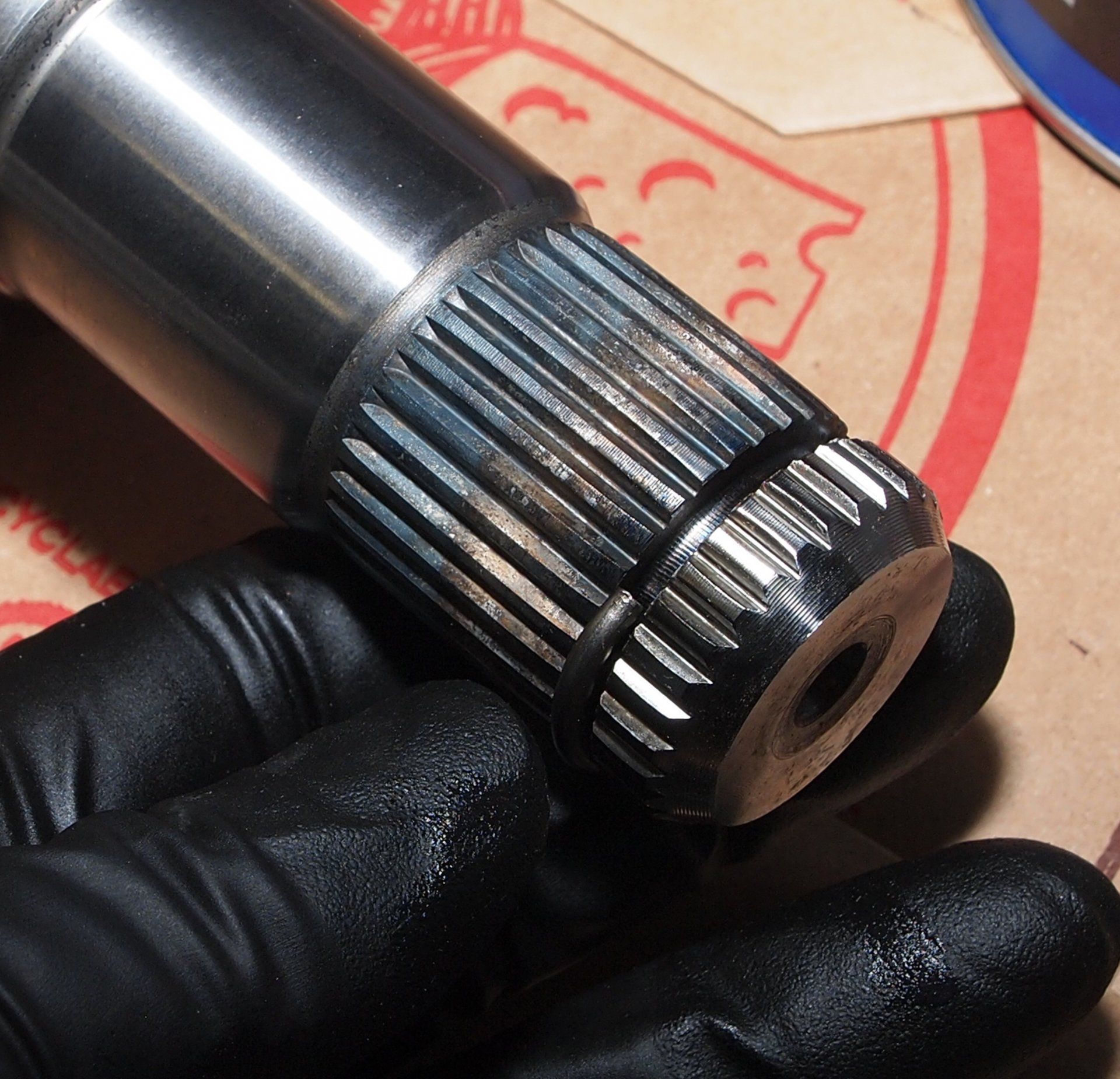

Additionally, sometimes the inner snap ring that retains FDS in differential, is not seated properly. The FDS then moves in and out of differential more than designed limits. In turns, it may pull FDS out of diff. Some have reported a click from this. I always replace these snap rings when FDS removed and install with open end down.

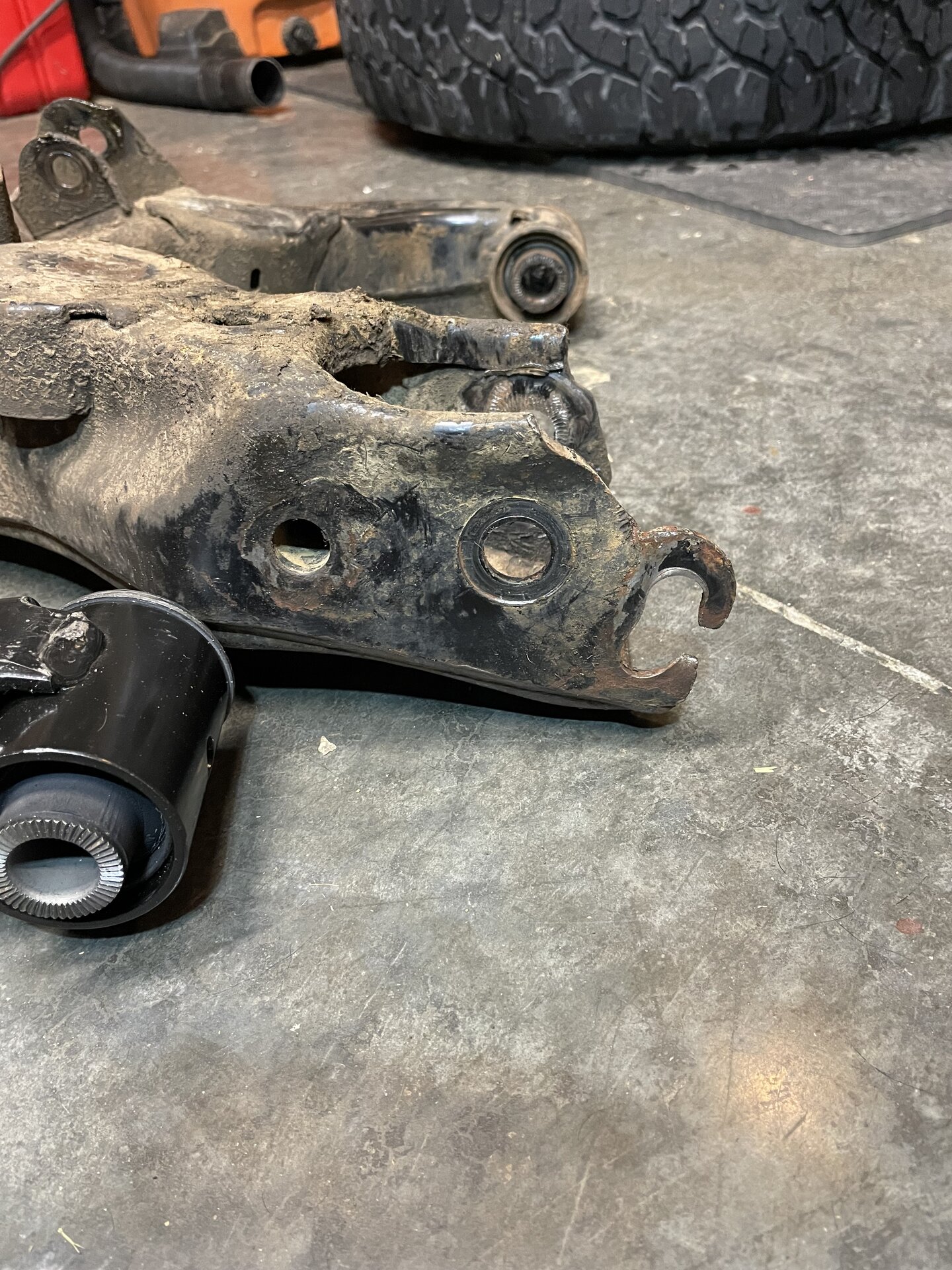

So I'm resurrecting this old thread. I recently broke my lower control arm in a way I've not seen anyone else do. The metal around the second short bolt for the torsion stretched and broke. the torsion bar was not lifting the drivers side front much at all and I was hearing noises and found the below issue.
I seem to have hit both the front LCA mount and the rear back piece of the LCA. This part had been on the truck for 5 years and about 90,000 miles, it had been through a lot of offroading and some gnarly hits (the front LCA frame mount is quite bent), but it still doesnt seem like a failure mode that should happen. It was an aftermarket LCA so I got a Toyota one for $380 (3x the aftermarket one), if the OEM is thicker than the AM part its not much thicker, at least to the naked eye (didnt have caliper). Anyways that just the intro to the problem.
After installing the new OEM LCA, I did a test drive and suspension/steering wise everything felt very tight and proper again. However....I have the clicking noise now while accelerating (5-30mph)...which I didn't really have before. I am hoping/suspecting it is the the issue @2001LC brought up about the CV dust ring/cover. Because the control arm mount on the frame was bent I had to some herculean finagling to the lower ball joint in and the mounts/bushings into place. During that time I 100% rested and probably pressed the bottom of the CV on the top plate of the lower ball joint.
So I am guessing/suspecting that the click might be from bending the cv dust seal/ring or whatever its called. OR...now that I have it torsioned up to probably above normal ride height (it had been sitting lower than the passenger side for a while) maybe the CV is clicking at the newish angle? I am kind of ruling out bearings because it was clicking before, so nothing should have really changed with regards to the bearings...and also I dont want it to be bearings because that's annoying.
Anyways @2001LC if its the CV dust ring is there really anything to be done? Seems like more of an annoyance than an issue, Other than taking the CV off im not sure what I could do. If the issue is the CV itself and the angle (+-1.5" above stock) I assume the clicking would just continue/get worse and I'll have to replace the CV. The boots are not torn or anything, but it is probably 60-70,000 miles on this CV. Is the CV more likely the issue than the cv dust ring since it is more of a clicking sound than a scraping?

Sorry to hear. I would suggest using electronic ears to zero in on the sound. From experience, it could be any number of things and using ears will cut down on the amount of exploratory surgery.

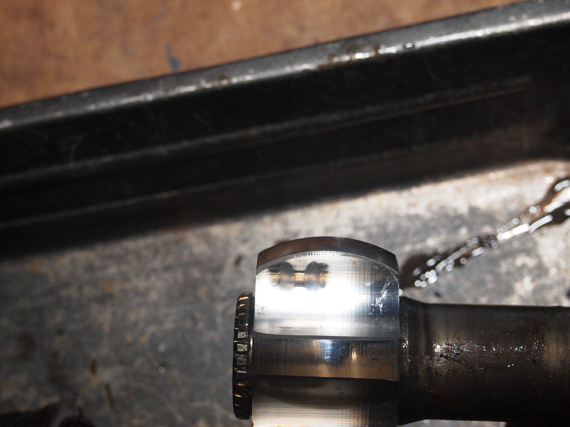

If it's a bent dust shield on outer CV tulip of FDS. You can raise the vehicle and spin the wheel and inspect for bends and sound. You'll also want to look over the seal in the back of knuckle the best you can.

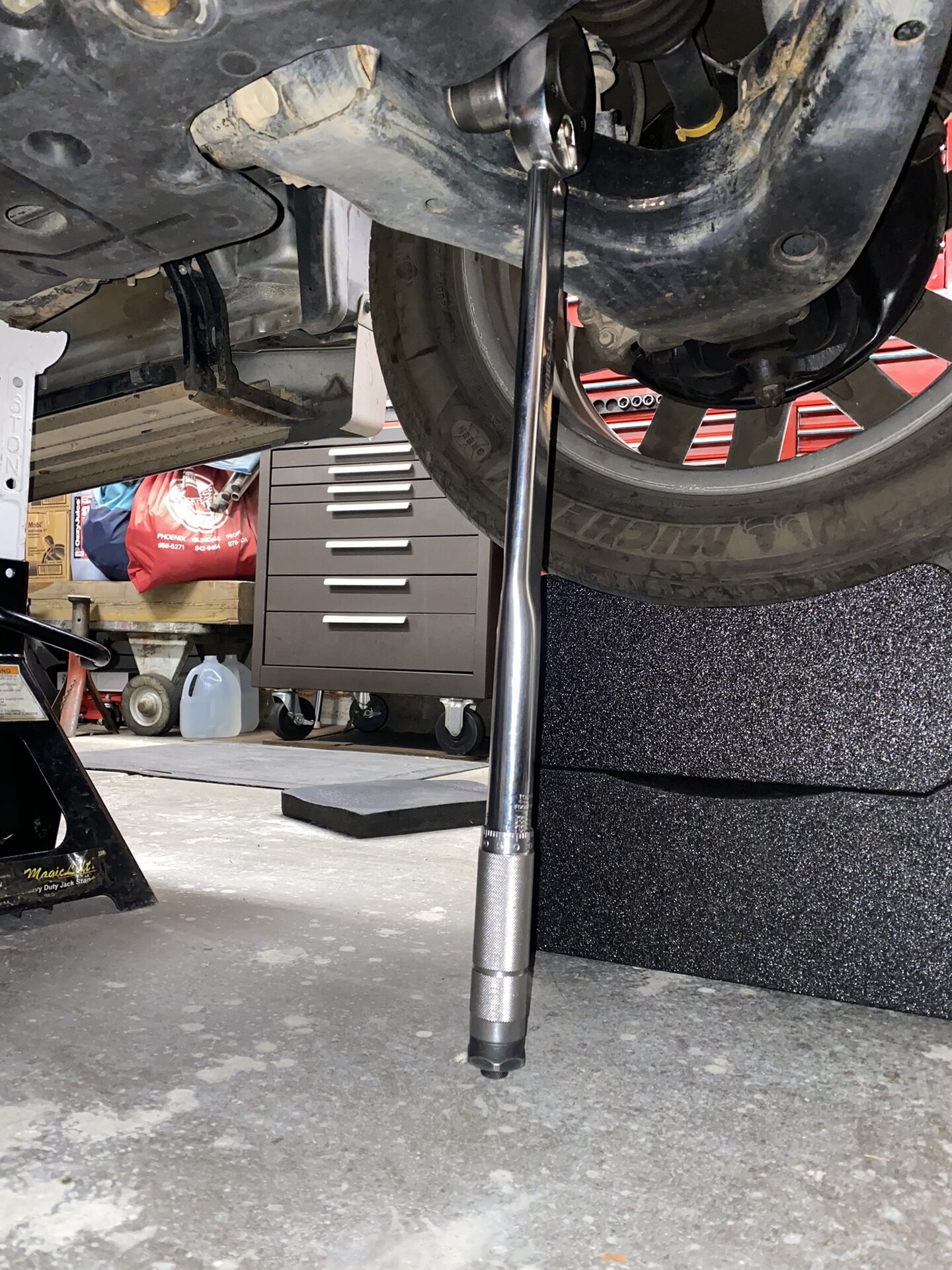

BTW: When torqueing down bolts holding bushings. You want the vehicle at a neutral stance. With weight on tires is best, IMHO! Some just set LWR at neutral position, while in the air on jack-stands. But loading the bushing with weight of vehicle. Which, is required by some manufactures, for warranty of some shock.
I've heard one or more of these click, when not properly torque in with vehicle on the ground:
  1. Shocks lower bolt.
  2. Stabilizer LWR bolt.
  3. LWC bushing bolts.

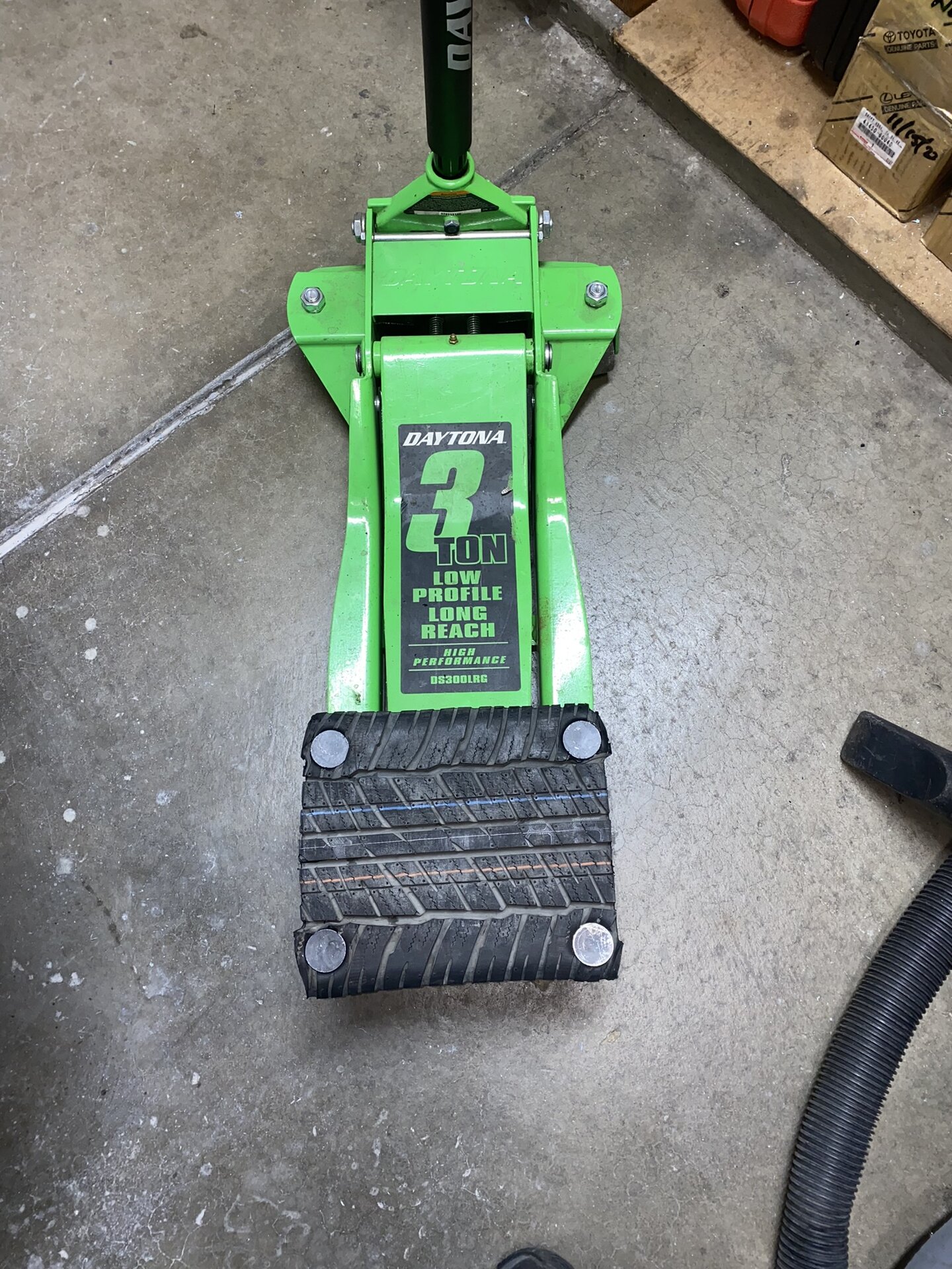

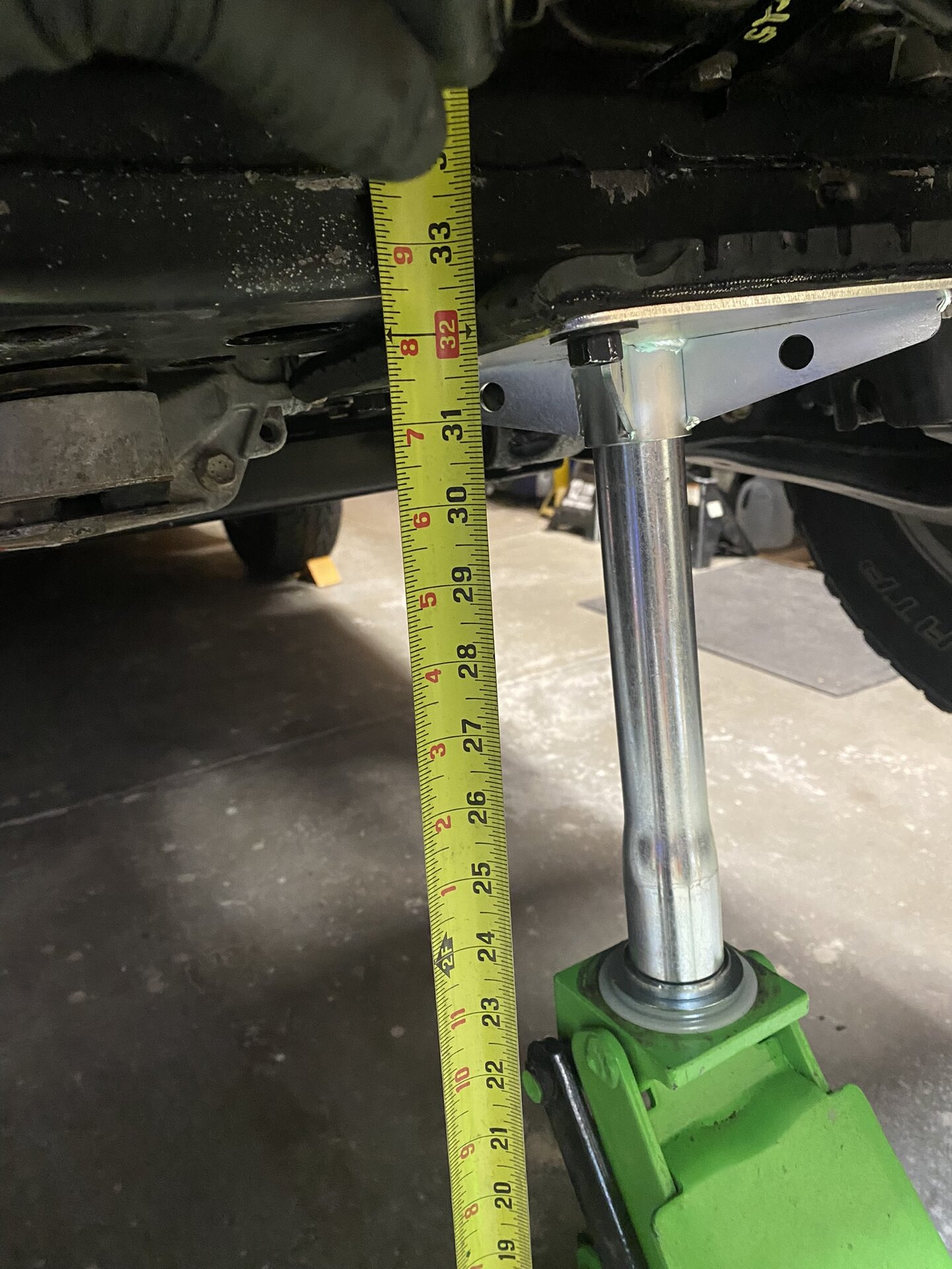

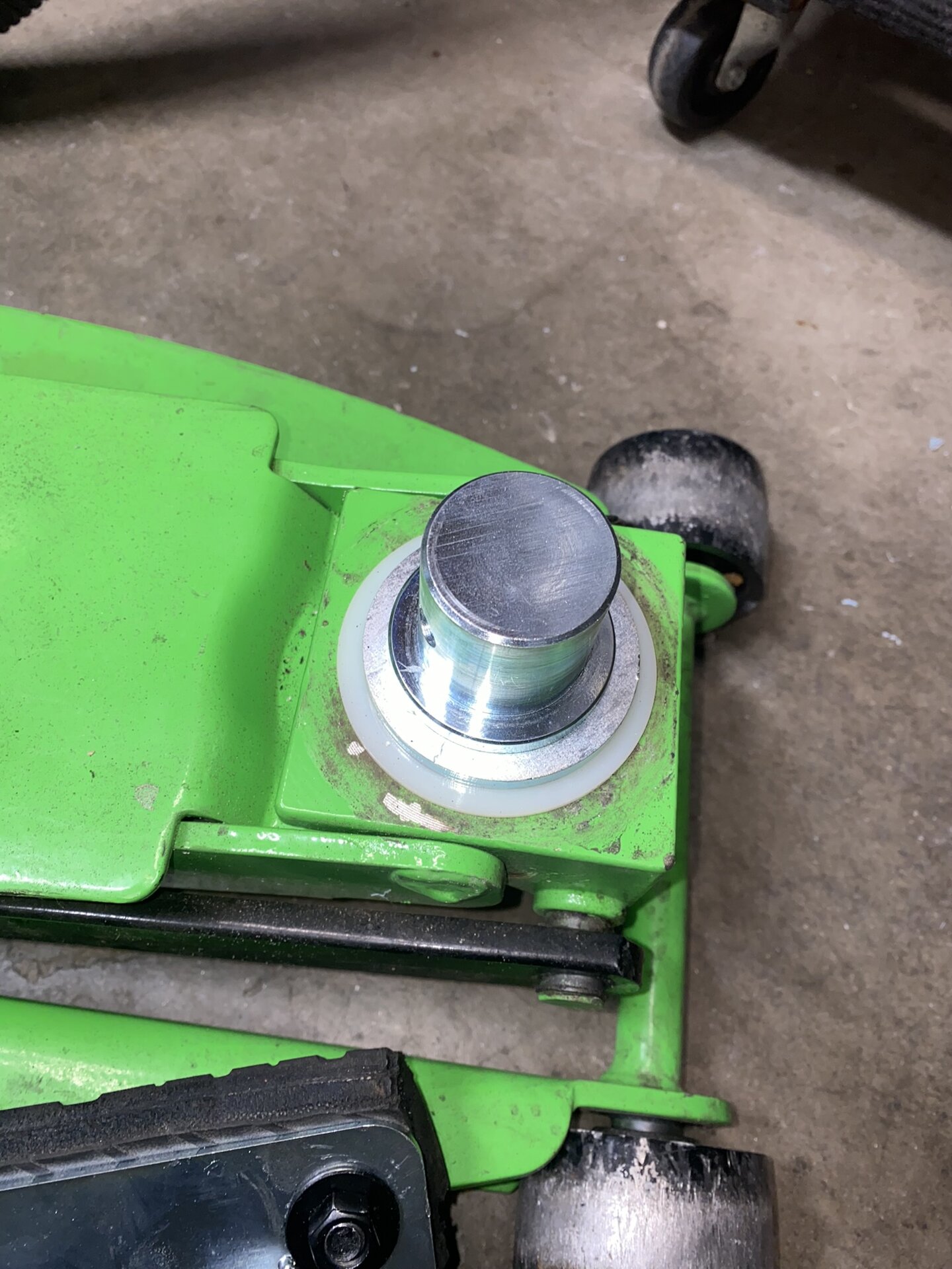

I've set up with Race Ramps, to torque these:
I've also customized my floor jack, to increase lift just for them.
