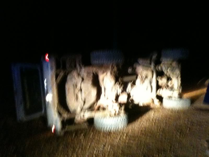

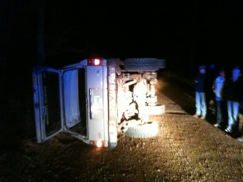

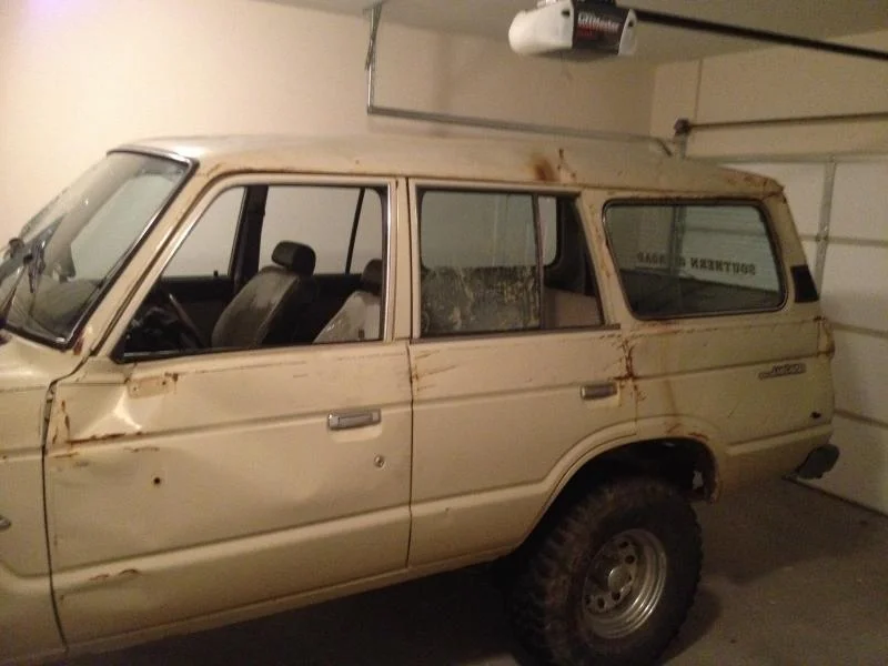

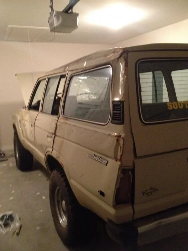

SO a while back my cruiser was in a roll over due to a faulty install of an air locker. This left my whole driver side, the windshield, and the roof pretty jacked up! So I decided to chop the top and put on an exoskeleton roll cage and also spray the whole thing in bed liner. This is the beginning of that build up and and all critiques/tip/thoughts are welcome and appreciated! the following pics are the damage after the rollover...

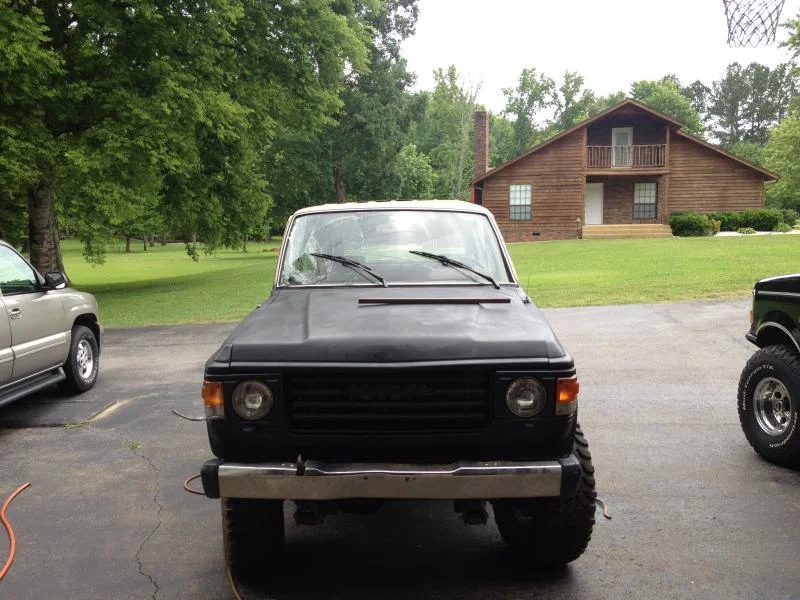

Pre first cut, and sprayed bed liner on the hood and front quarter panels

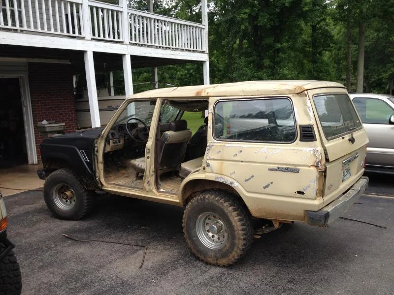

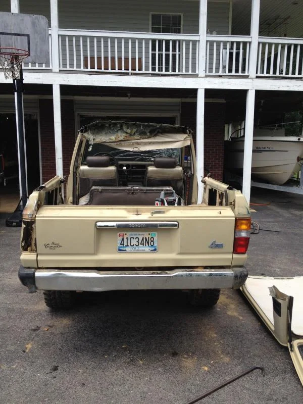

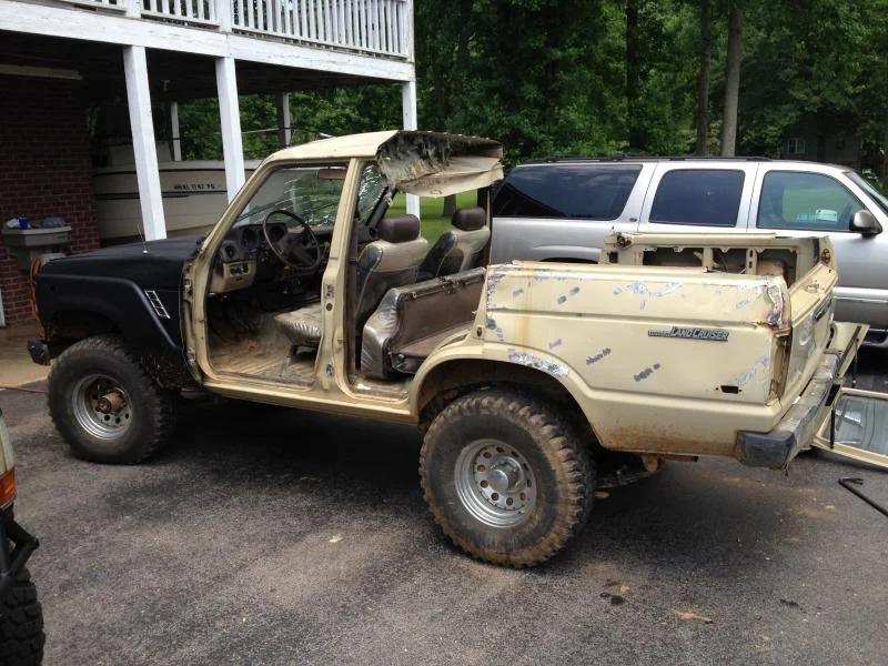

here we are after the first cut with the roof off. used a saw zaw and a grinder with a cutting wheel. this is as far as i have made it. more pics to come on Monday at the earliest :bounce::wrench:

can I get the opinion of the group? what to do about the doors? i like em off but when driving through mud it might suck.. i was thinking about cutting my doors in half and putting em back on i also plan on getting a soft top cut and and putting buttons on it for the winter and during rain. anyone have any ideas on the door subject?? thanks
Looks good. I would cut the stock doors down to half doors. There are a few guys on here that have done it a few times. I would cut your rear hatch along the body line then weld it to the top of the tail gate to even the back out.
Could you save the front and make a FJ60 ute? Keep the wagon rear, weld in the bottom half of the doors, extend the lower tailgate up to meet the tops of the rear quarters as mwalls54 said.
Use the stock b-pillar and add another smaller one, but angled rearward and put lexan triangle glass between. Also a lexan rear screen in it [or actual glass if you can].
So you will end up with pretty much a FJ60 pickup. Pretty rare, handy too. It's not like you would have put your Nan in the backseat without a cage anyway, so a ute would still be practical.
Then.. source a 1HD-T or an LS3 blah blah blah. Sorry got carried away. :)

"SO a while back my cruiser was in a roll over due to a faulty install of an air locker."
How was the air locker installed that this was the result? Maybe save someone else the same headache.

im diggin all yalls ideas. the locker was installed improperly. from what i understand there is a bar that goes straight through the gears with 2 screws on each side only one screw was installed sorta like this if you can picture it l l but only one screw... locked up my front right tire on a dirt road goin about 35 ish and took me into an embankment then rolled me heres some pics

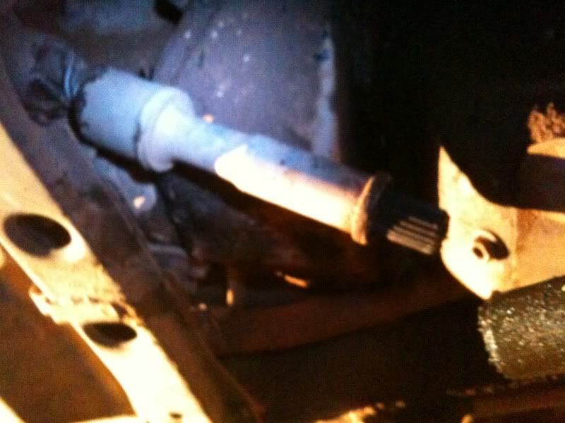

it also ripped the front drive shaft out by cork screwing it seeen in this picture

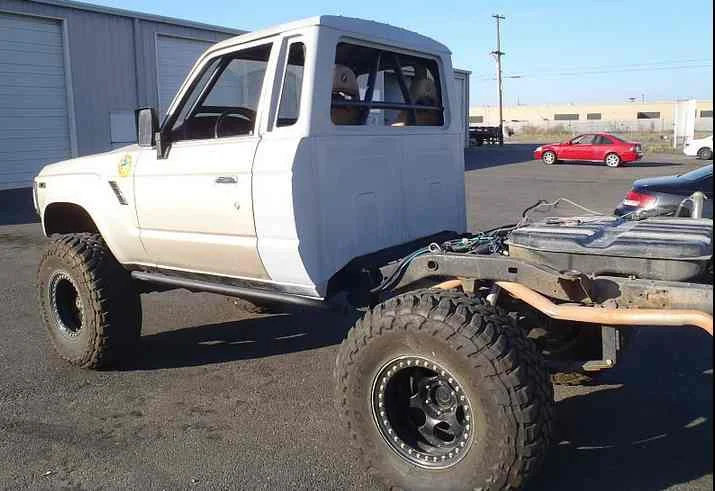

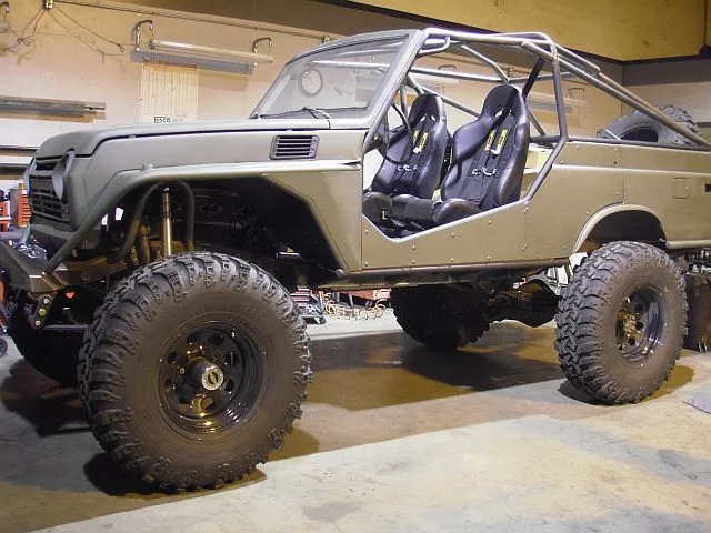

No apologies, Mate! Rig below now in process of being built - Central Valley, CA.
Keep it coming, I'm a big fan of chop - cut - and make Bigger and Better!!
That's an amazing pig up there. And great job on the 60 as well, it's coming out very nicely!!!
YES! I searched google very briefly but found nothing that illustrates what I meant, til now. Your truck is fxxxing sick as. I would totally build a HZJ61 but with a styleside/wellback tray - separate though like a 45. 1HD-T/H55.
