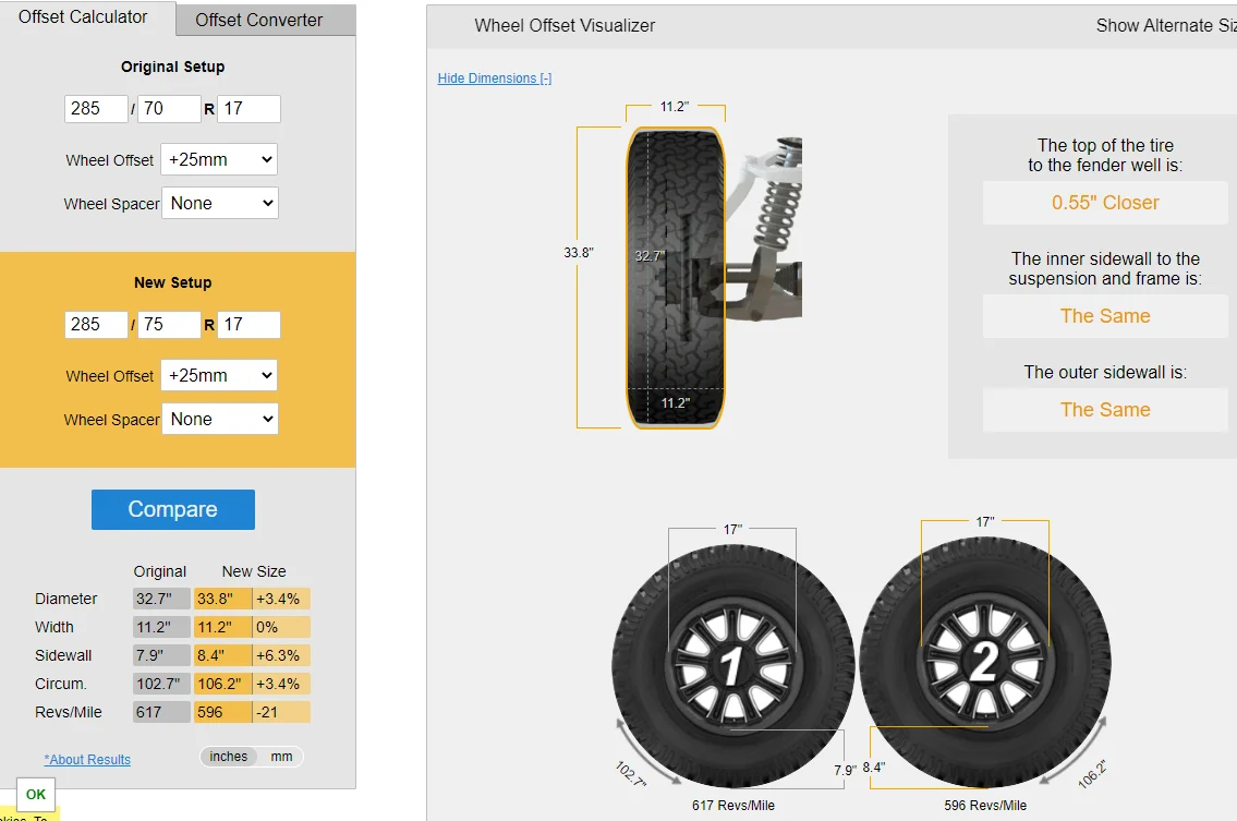

They will fit with no problem, but I am not sure how specific you are trying to get or what you are trying to test with other methods. For peace of mind I can show you via the calculator how they would work compared to your current setup and a setup that is common for others.
Comparing them to your current tires, the inner and outer sidewall doesn't change because the width is still the same, but the top of the tire will be 0.55" closer to the inner fender.

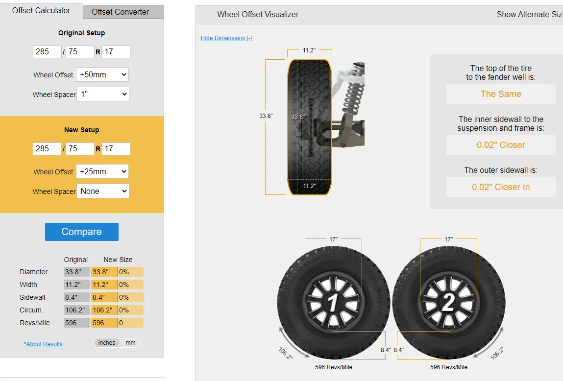

Your new 285/75 would be nearly identical to running Rock Warriors with a 1" spacers, a fairly common setup for people here. Your tire would only be 0.02" closer to the inner suspension and frame (which is essentially no difference).

You would clear just fine with 285/75/17 at that offset.

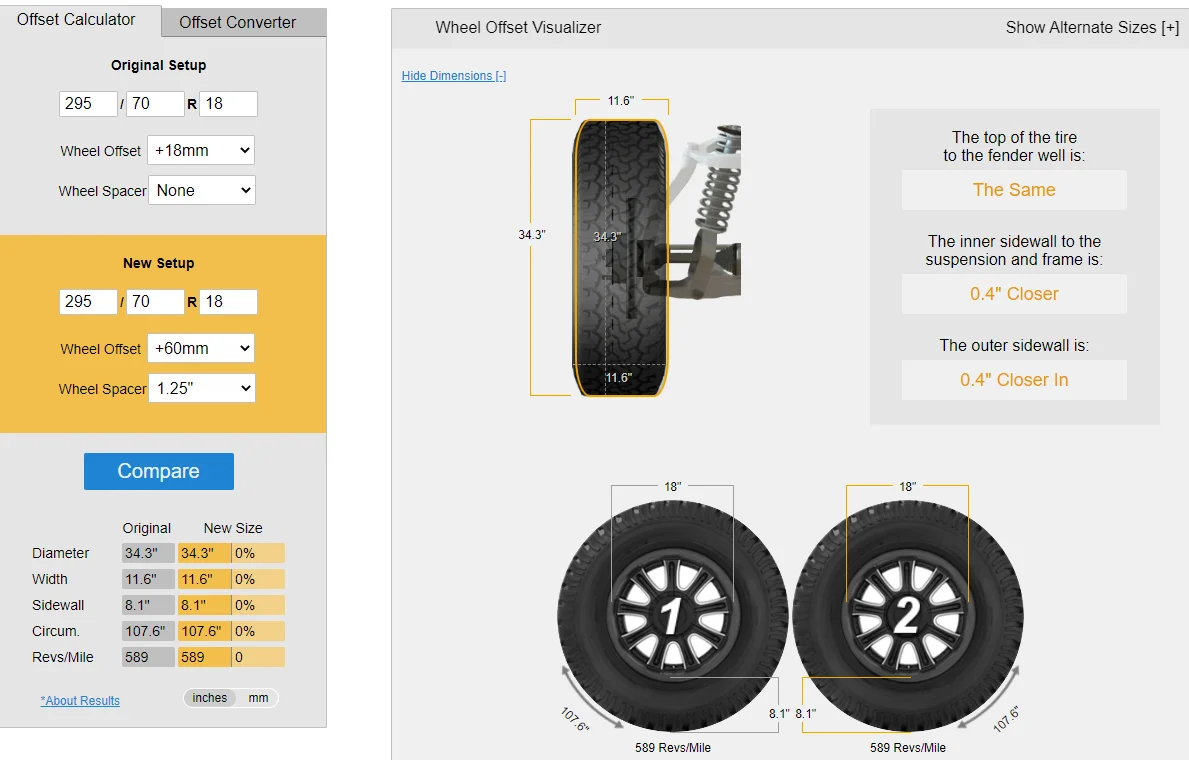

Do you know what the heritage wheel with 1.25 spidertrax spacers total offset is? My previous 200, I had method wheels +18 offset without spacers and was able to run 295/70r18 which I’d like to do with my current 200.

I believe the heritage rims are the standard stock offset of +60mm so running those with a 1.25" spacer puts you 0.4" closer inboard than running the +18 offset you had before.

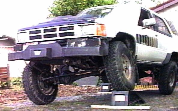

If you're looking for a way to simulate articulation at home, the thorough way is to drop the springs out and cycle the suspension with a jack.
The easy way is to park on a couple ramps arranged thusly:
