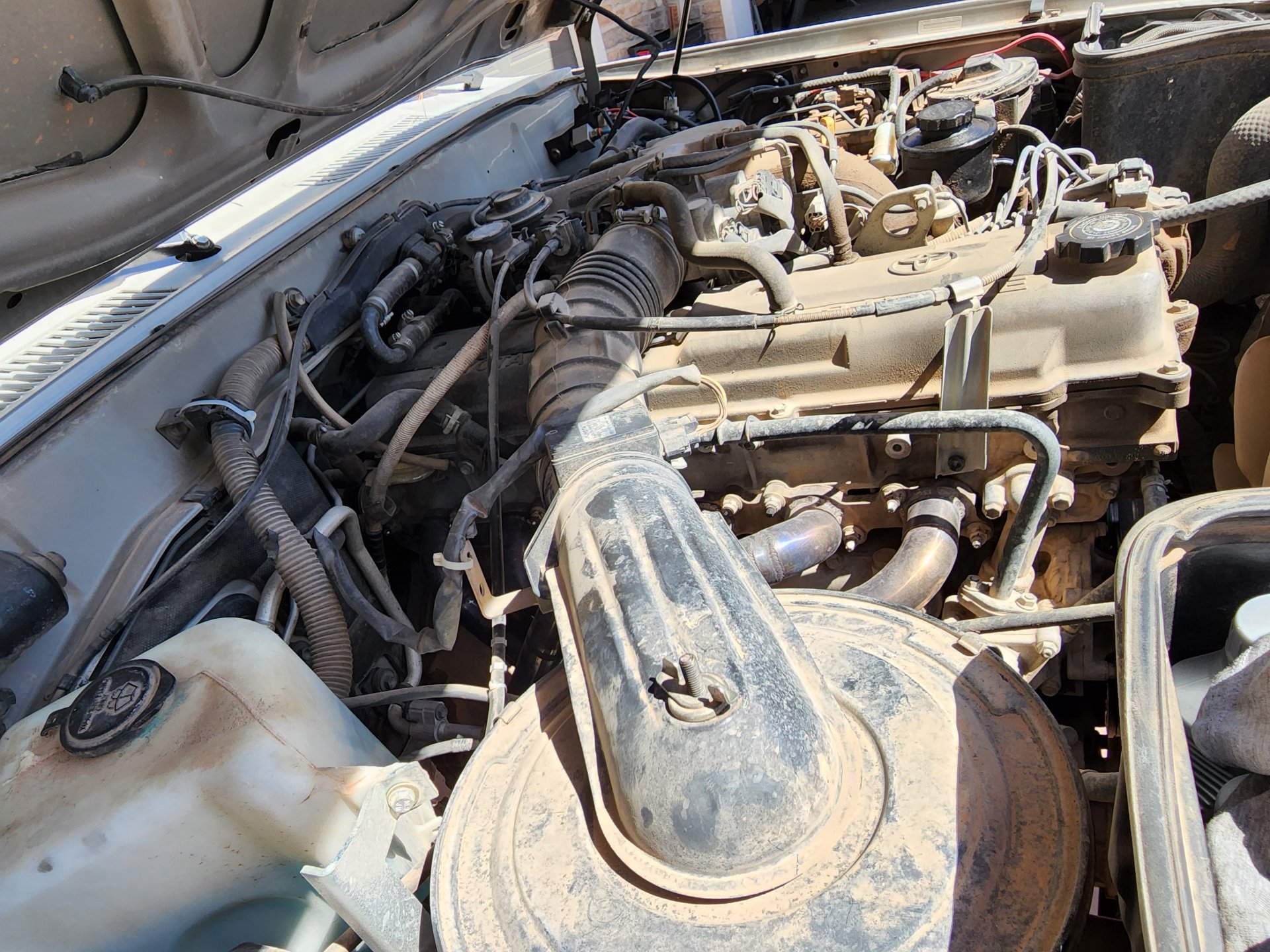

This aftermarket header should make the job should be easier for me!!!!!
The only problem is the PO had the headers installed and I don't know the brand. Hence I am not sure if I use an oem gasket or a gasket from the unknown company that made the headers?
Anyone recognize the headers?
