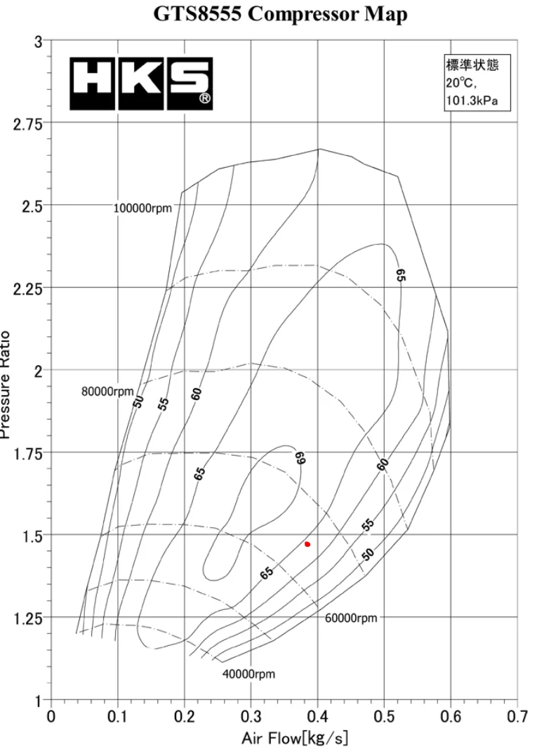

Here is the compressor map for the GTS8555. Just based on the power numbers(510 HP) they are claiming I think the compressor would be operating at the red dot at sea level. So at 1.4:1 pressure ratio and ~64% efficiency the charger air temps should be around 160F out of the compressor. So the intercooler doenst have to do a TON of work.

So the TVS would actually be more efficient at 510hp. I am assuming 1 lb/min of air flow per 10hp. So 51 lbs/min at 510 hp.
