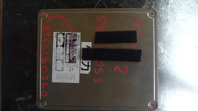

Ok, thanks to the generosity of Rick I was able to swap in a known good ECU, knock sensors and crank position sensor from a 1997.
The ECU from Rick was a 89661-60261. The one in my truck, from a salvage yard installed by the previous owner was a 89661-60260.

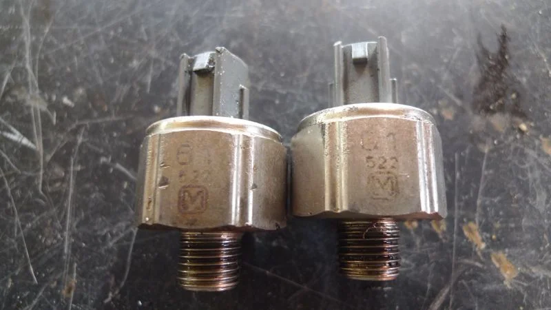

The knock sensors on mine had clear markings on the sides. Looks like a "61" in large type and then a "522" in smaller type beneath that and then a "M" mark. Pretty sure that they aren't Toyota OEM. The one's from Rick had no marks at all.

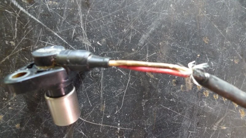

Then the crank position sensor on mine had the insulated ground stripped away from the last 1-2 inches right at the sensor. Not sure how that would affect the actual function of the sensor since it sounds like that shielding just protects the sensor from picking up random RF signals from other things in the engine bay. At any rate, the one from Rick had a nice rubber boot covering up all of that.

My $0.02 is that those knock sensors don't play well with the ECU.
The missing 2" of shielding should not have a significant effect on the CPS for just the reason you say. And that sensor is already physically protected by a metal shield which will also serve as a partial RF shield.

I have an old knock I pulled from my 94 and it has an M on it and a 61 like yours
but has 452 stamped on it and also has toyota stamped on it as well

I'm only guessing that the knock sensors aren't the right ones for the salvage yard ECU. For one thing, both were throwing a code and I think it unlikely that both sensors were bad.
To support the idea that not all knock sensors are created equal, here's a quote from this document: http://www.wellsve.com/sft503/counterp_v4_i4_2000.pdf
Many sensors look alike, physically. But the sensor is matched to the engine and the PCM. Since all engines vibrate, the engineers must spec the knock sensor so that it doesn’t react to “normal” vibration and only reacts to knocking. The wrong sensor, even though it fits, may not work properly because it won’t correctly identify normal and knocking vibration.
