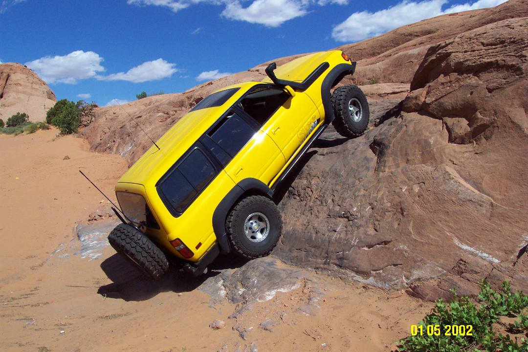

You can see it here
On this one I had a 2m atenna on the roof and CB on the tire carrier. Shows roughly where that spot is

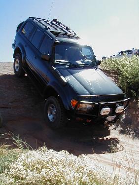

Here's my Wilson 1000 setup on the 80. I went through the second row seat dome light also.
https://forum.ih8mud.com/showthread.php?t=115397
