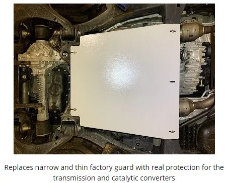

OP, sorry to hear about this. I don't have anything more to offer as far as ideas to help but I am curious if you have aftermarket skids or not. As @paulunm suggest BB skids would certainly make cat theft harder. Probably not the sole reason to to install them but my BB skids do make me feel for secure from a cat theft perspective.

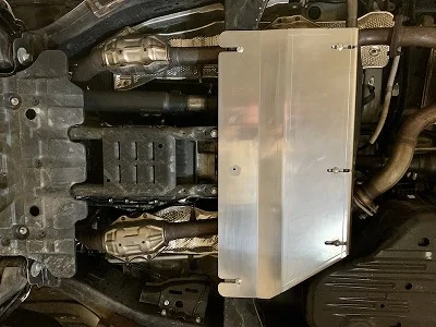

Is the budbuilt transmission and transfer case skid plates enough to cover cats?
If so it’s like $650.
Is there a cheaper way to cover everything?
