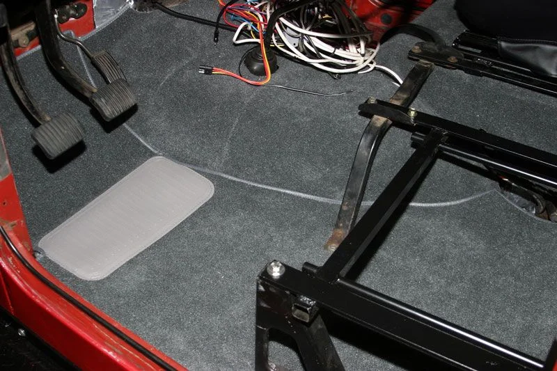

I did lot of sounddeadner in my FJ40, then the carpet kit from cruisersolutions. I liked his carpet kit, because it was very complete - covered the tank and side pannels. It made a big differeance..
attachment.php
