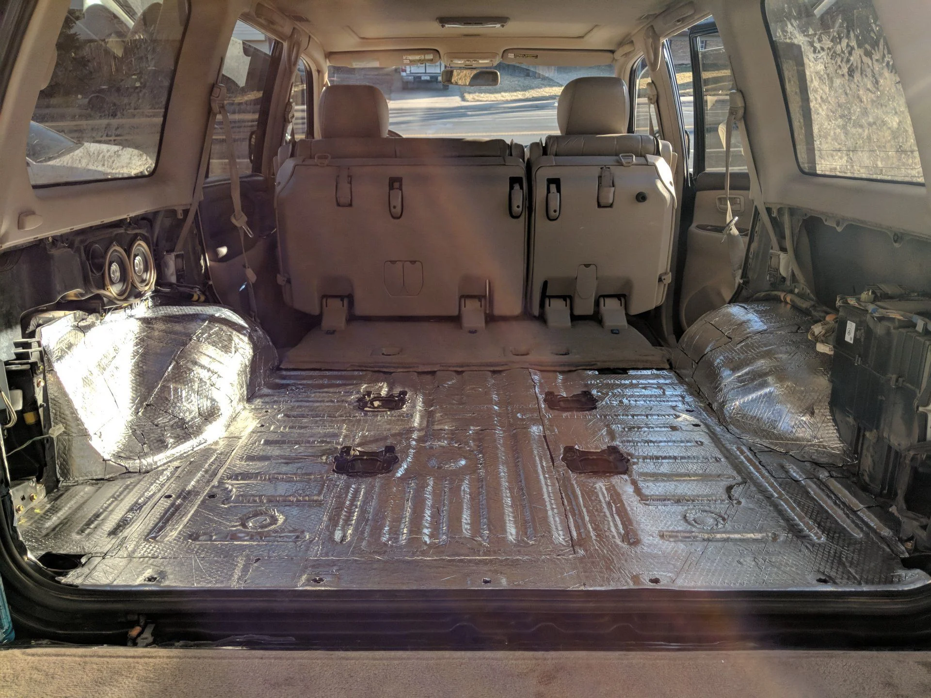

I did my cargo area a few years ago and have zero regrets, in fact I was amazed at how much road noise it eliminated. I would at a minimum do the wheel arches to get rid of the wind and road noise from the tires.
I have another box of deadener in my garage and I've been meaning to do the front area, but just haven't had a chance to get around to removing my seats.
I used the Noico 80mm. An 80 series guy in town gave me two boxes for free. It's great stuff. Just take the time to use a roller and do it when it's warmer out so it sticks well.

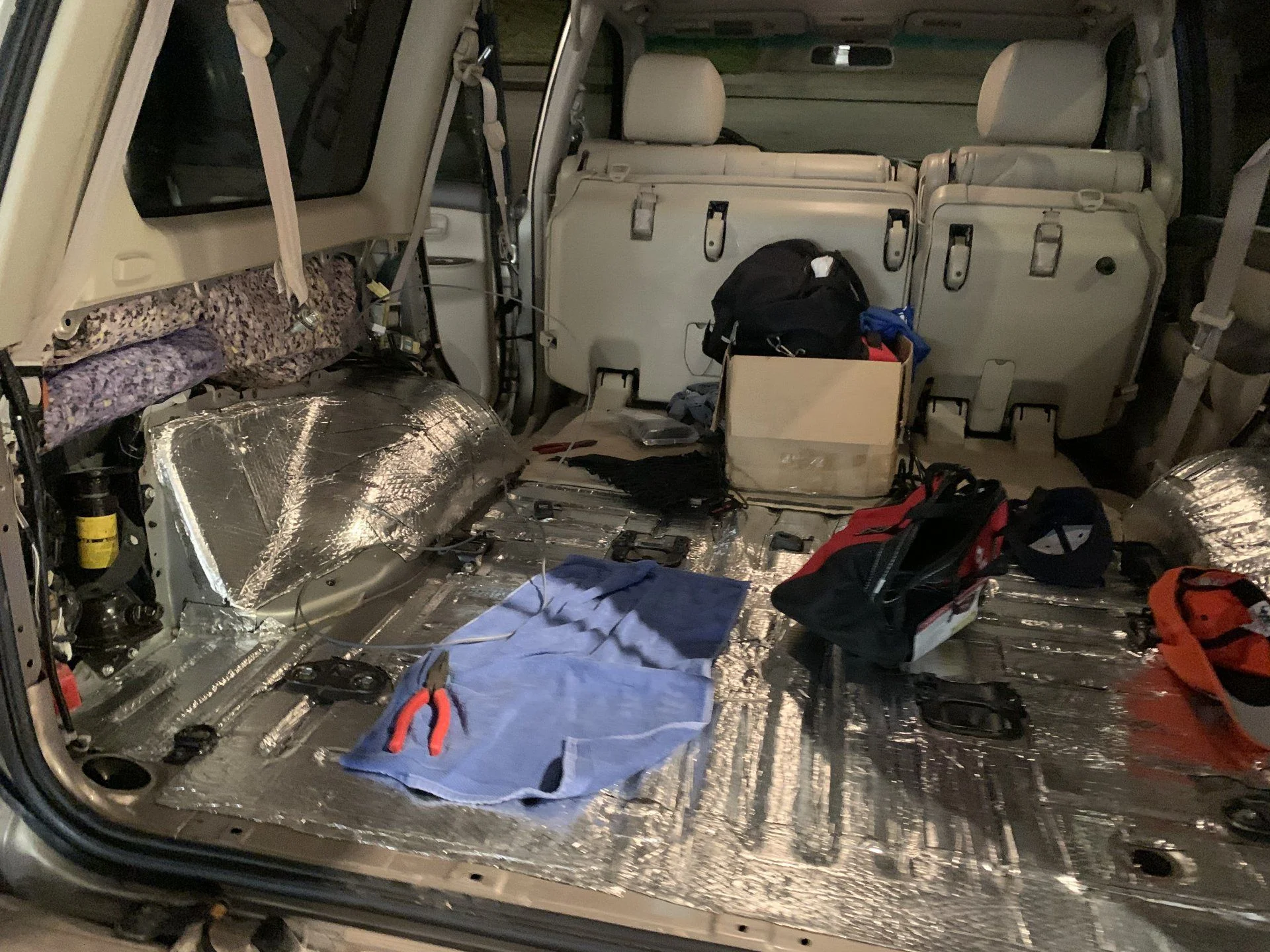

I just put some Killmat in small areas of the rear that sounded tinny when i knocked on them ( outer edge of fenderwells, exterior skin) . Not sure if it made a huge difference, but pretty easy to do while I was in there for wiring.

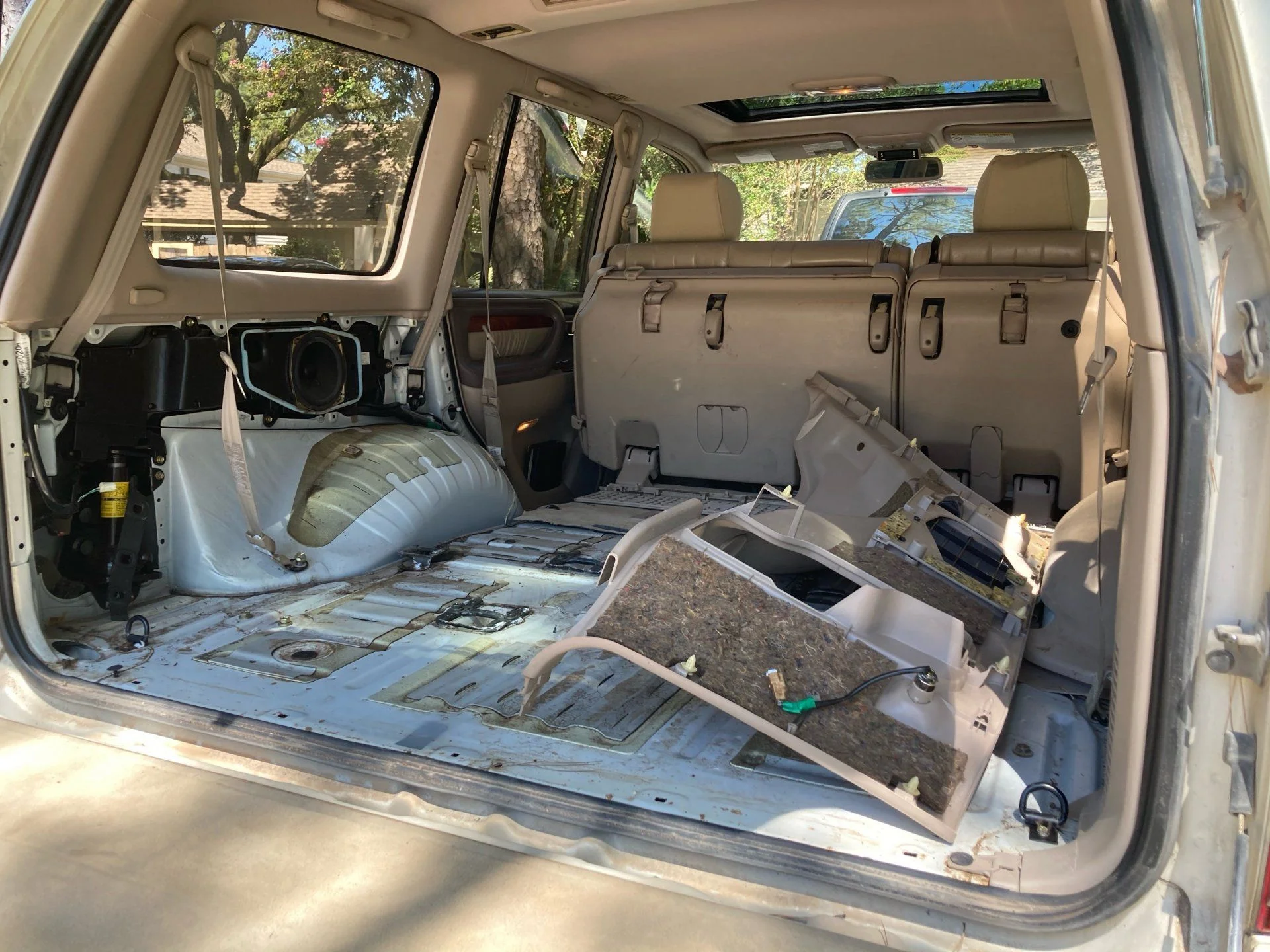

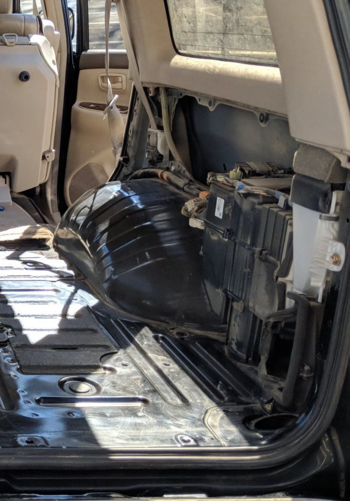

Bringing an old thread back to life as I dig for pictures of the cargo area with the trim off. I am about to open mine up due to a wild spring like noise every time the back PS panel is impacted, from shutting the door to bumpy roads. Does anyone know what the black plastic box behind the PS wheel well is in this picture? I’m unsure what I’m going in to tighten up / deaden.
Bringing an old thread back to life as I dig for pictures of the cargo area with the trim off. I am about to open mine up due to a wild spring like noise every time the back PS panel is impacted, from shutting the door to bumpy roads. Does anyone know what the black plastic box behind the PS wheel well is in this picture? I’m unsure what I’m going in to tighten up / deaden. View attachment 3923568
Rear air conditioner unit
Addressed that one long ago. This one is clearly behind the rear quarter panel. I’m doing a full sound deadening, so this area just gets raised in priority now…
