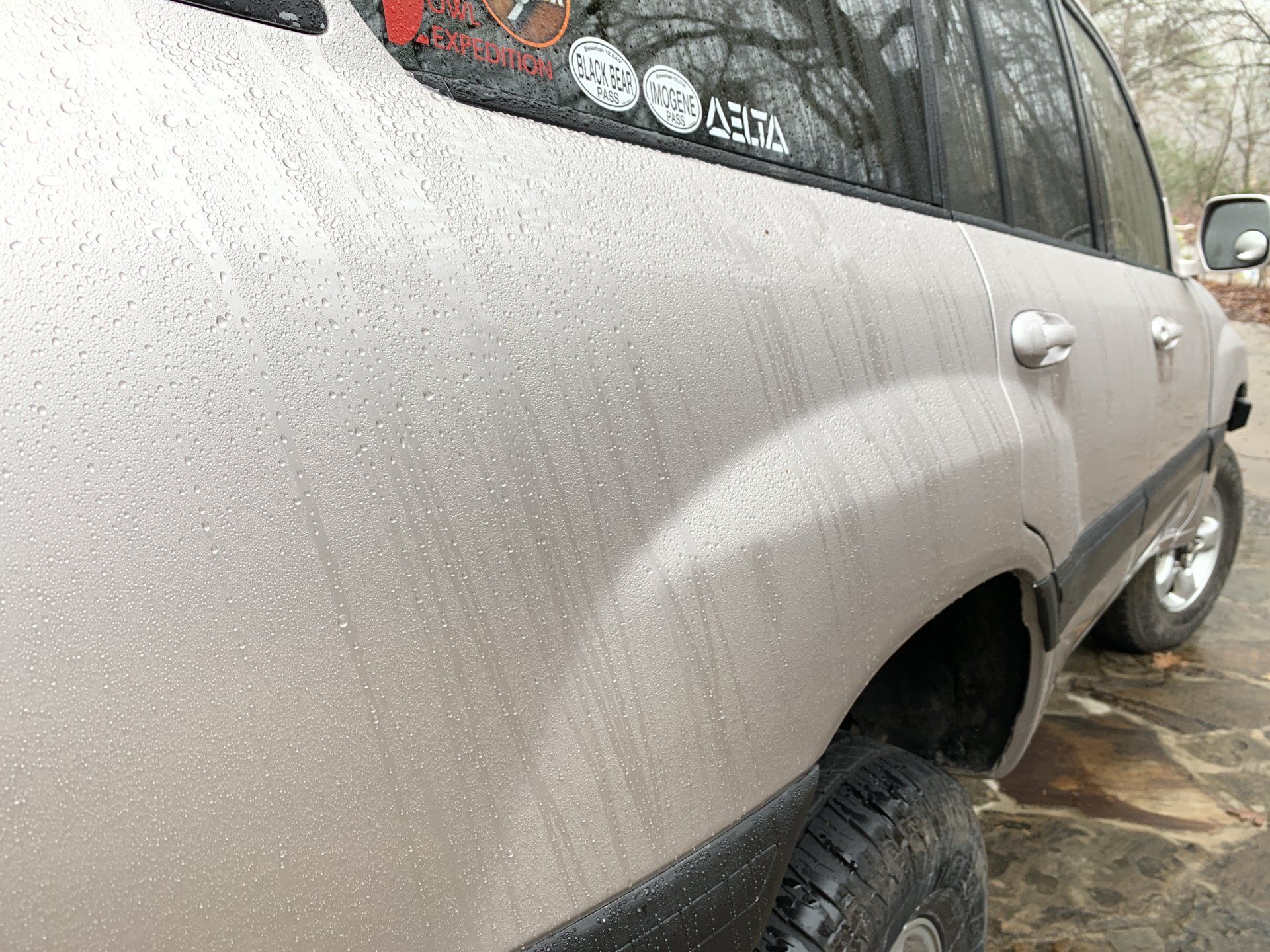

So far I’m loving this ceramic coating, water beads up and sheets off so nicely. In my opinion better than waxes I’ve used in the past. Also, the coating I used on the glass is fantastic. Wiper blades are smooth (no chattering) and streak-free, really don’t even have to use them at highway speeds, and it’s the most transparent my glass has been in years.

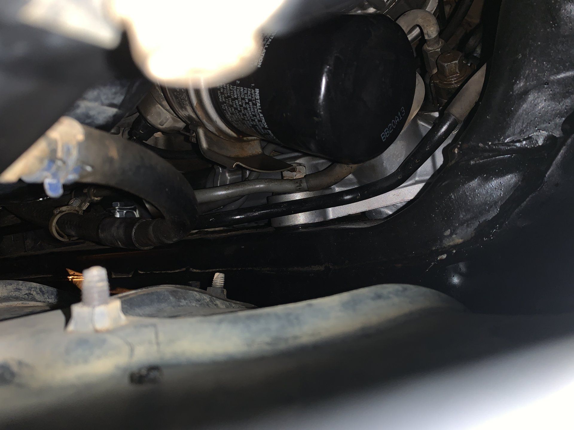

Crappy pic of the rack through the gap in the skid plate:
