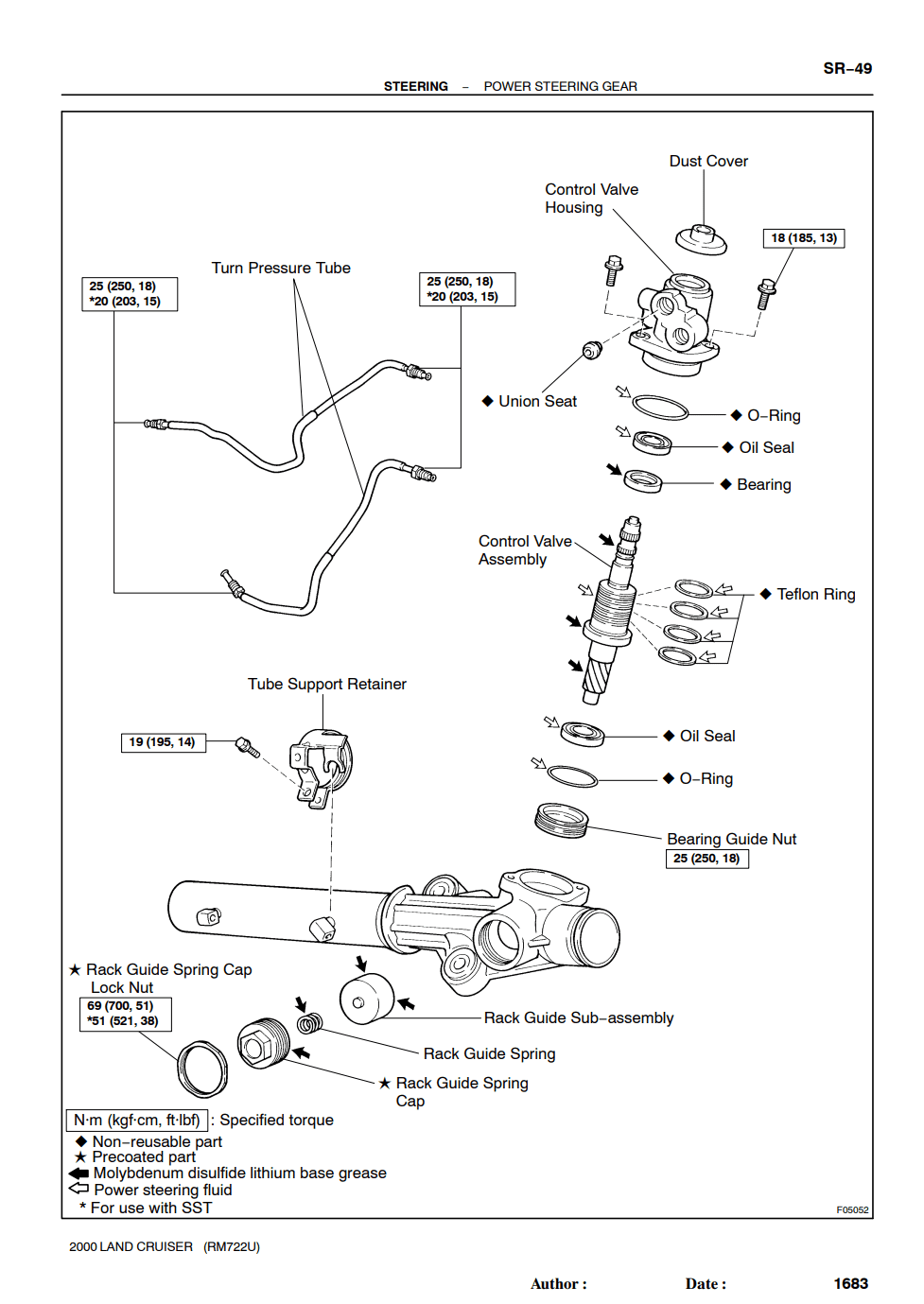

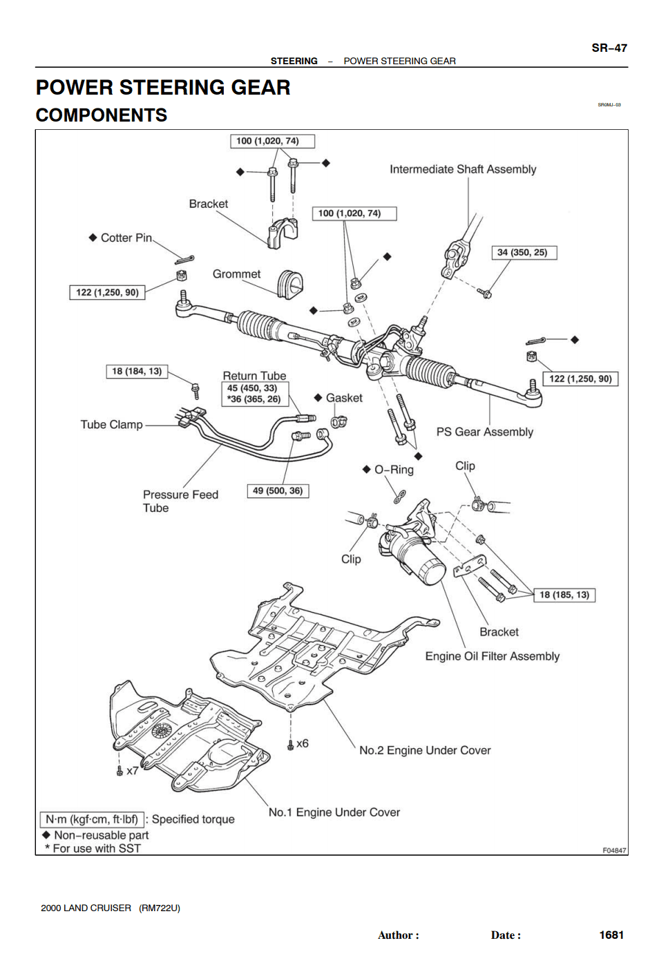

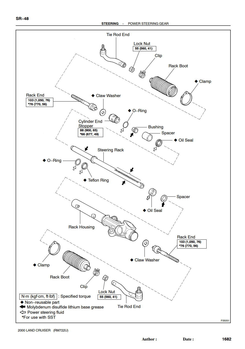

Parts diagram from the repair manual. I got a 48 hour subscription to TIS, so I can pull anything right now.
Thank you very much that's very helpful! Looks like the other bushing besides the D-shaped one is already preinstalled
