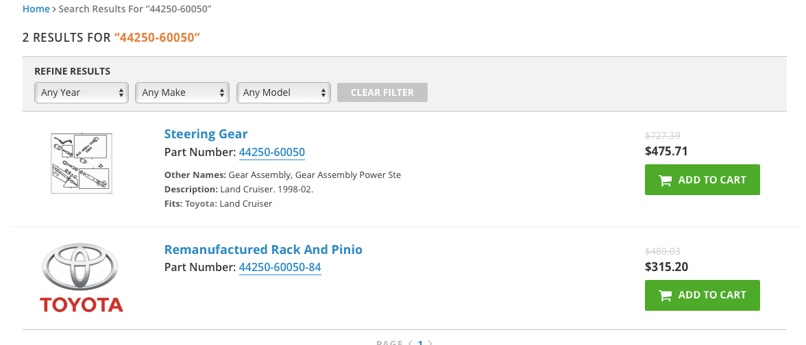

Reman from McGeorge is $315 and new is $475. Since they are doing the labor maybe you can negotiate the price on the part down a little. Still prob isn't worth buying the reman.

**The steering rack for the 98-2002 LC (44250-60050) doesn't appear to be sold complete with outer TRE ( that I could find) so you'd need to add those to the rack- better check on that they dont reuse your worn outer TRE.
Note that regardless of which rack you get, you will still need to buy new outer TREs! The outer do not come with a new rack, only the inners do.
Nevertheless, I agree with others that you’re getting shafted on the rack price quote. Buy a new one yourself from one of the online Toyota sources and take it to your guy to install. Warranty will be the same.
