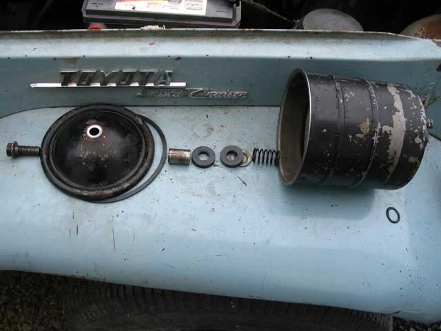

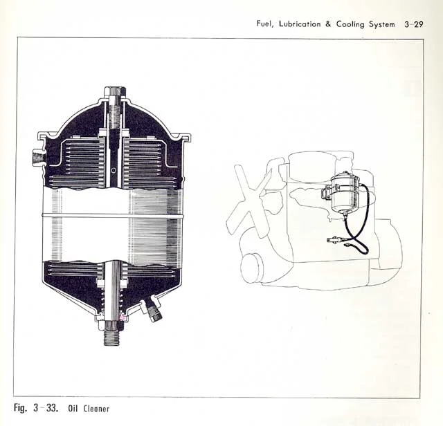

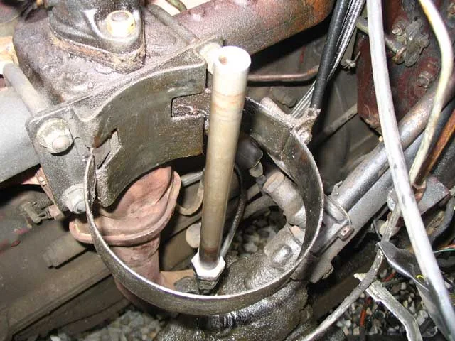

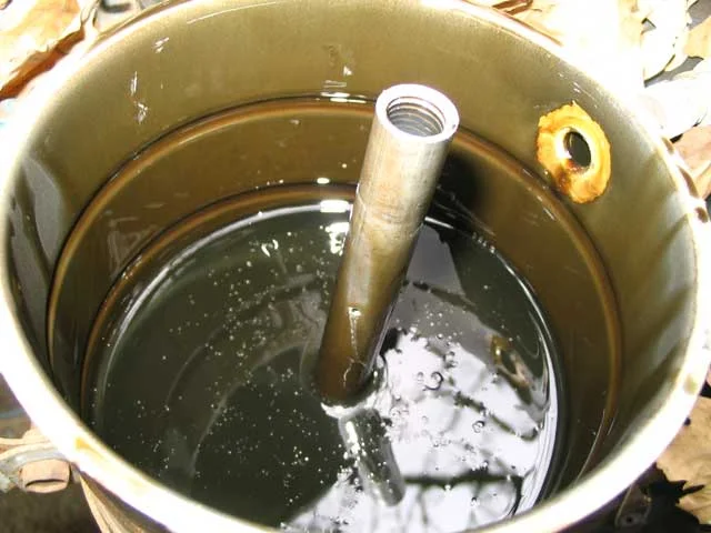

ok, I got it all figured out. There is a small o-ring that keeps the oil in the canister. When you pull everything out of the truck the return line is the same part that runs all the way thought the canister. The 2nd pic shows the oil return hole. It is almost at the top of the canister. Oil cannot drain beyond this point but should drain on it's own down to the port at least. The 3rd pic shows the o-ring at the bottom of the canister. The teeth on both sides lock on the bottom nut so you can tighten the bolt at the lid without the whole works turning.

You can see the return hole in this pic with oil in the canister. As far as I can tell, this is the correct order of the internal parts. There may be one more washer between the spacer and the first rubbber part on top though.

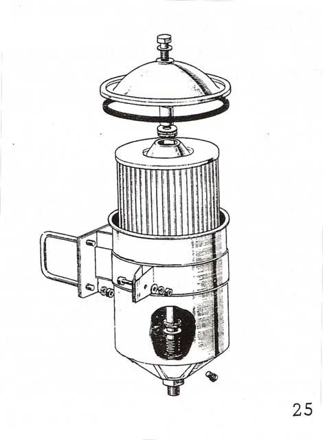

Check out this old school filter. The 3rd pic is where I think there should be another washer. Just between the spacer on top and the rubber.

They are all missing the washer, one was upsidedown, and the convertable was just plain weird. I need more parts, want to go to the junkyard Wes?
One more thing ------> No leaks! :)

So, what's missing on your's, Mike? That is how mine is set up. It does show the out hole in the very last figure being just an inch or so from the top lip of the cannister, almost the same level as the inlet hole on the side of the cannister.
