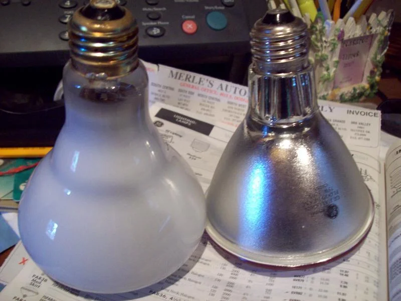

Halo T housing, Coilex Baffle and Regressed eyeball. The wife just brought home cases of bulbs from a client who is going to LED.
65w BR30 is our norm, some of the these are 75w PAR Halogens, too hot? I remember something about medium base and long neck, what do I have here, and any .02?

well what does your can say is the max bulb it will take?
and in the pic you have two type a base bulbs.:doh:
Must have failed in the original post. Can is rated for these, trim not sure of, and remember something about trim options w/Halogens..
Yeah, the base will fit, and the wattage is good, but I'm not sure if halogen bulbs put out more heat/watt than incandescents. Also, the increased size may interfere with the trim and/or overheat it due to proximity. Besides, you should be putting CFL's in everything! :flipoff2:

A 75 Watt halogen won't put out any more heat than a 75 Watt regular incandescent. In fact it will put out a bit less as more of the energy that goes into it goes into light production.
most recessed cans have a thermocoupling in 'em to keep stuff from getting too hot. even older ones. also, inside the cowling that the lamp is there should be a sticker, lable, etc. on that lable it should tell you what lamp/trim configuration it's set up to handle. most of the time painters have sprayed it over pretty good. might have to look in a couple of cans or get a model # and check a new one out at the store.
cans are fickle about the lamps you use though. you can stick 65 watt br 30's in without a problem but a 60 watt a-19( your standard incandesecent ) most will trip a thermocoupling.go figure.
they have different styles, one screws in and you need to adjust your socket up or down so the trim will be tight to your ceiling, the other one has a crew socket with wires and plug and it has springs that uses the same system that the trim uses to stay tight.
No way. A halogen PAR lamp puts out way more heat directed down than a normal BR or R lamp. The filiment burns hotter, and the goal of this design is to put more light directed out.
I had nine 90 watt pars in my kitchen. Besides everyone leaving them on all the time, you couldnt even stand under them.

Just because the reflector in the lamp reflects more radiant heat in one direction, that doesn't mean that the bulb puts out more heat.
If both bulbs are 75 Watts. Halogen bulbs are a bit more efficient at turning energy into light than incandescent bulbs. So, less energy is available for turning into heat. So, where is the extra heat energy coming from?

most can light are rated for the 65w br30 or a 75w halogen as stated you probably have a thermo-couple any who. Also the halogens are smaller diameter so they do not pass heat as easy into the can I know they run hotter but they also have the heating coat on them (the silver paint on the sides) witch helps deflect the heat. If they were mine I would throw them in. just my .02 (I'm a master electrician)
