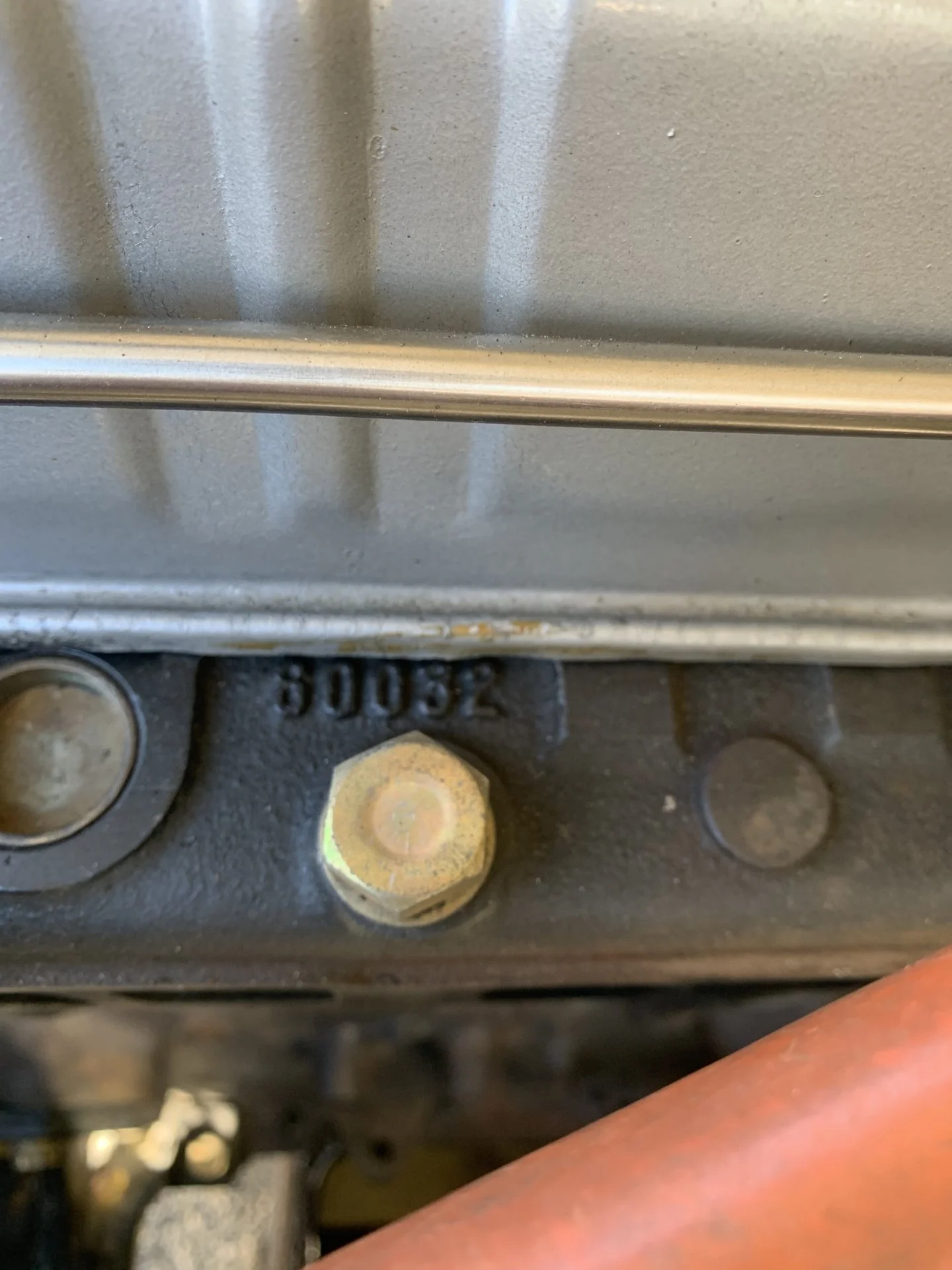

Can a Non-USA Columbia Spec. F1.5 1973 have 3 threaded Coolant service ports in a original Cylinder Head ? #60032

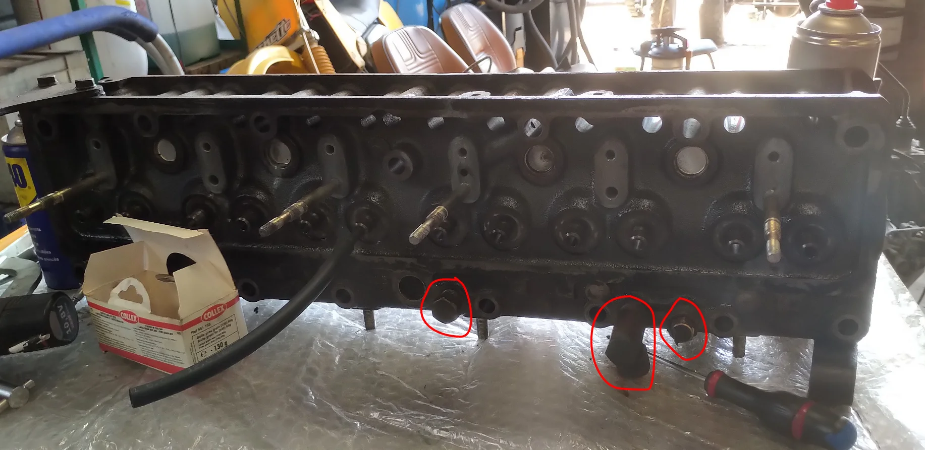

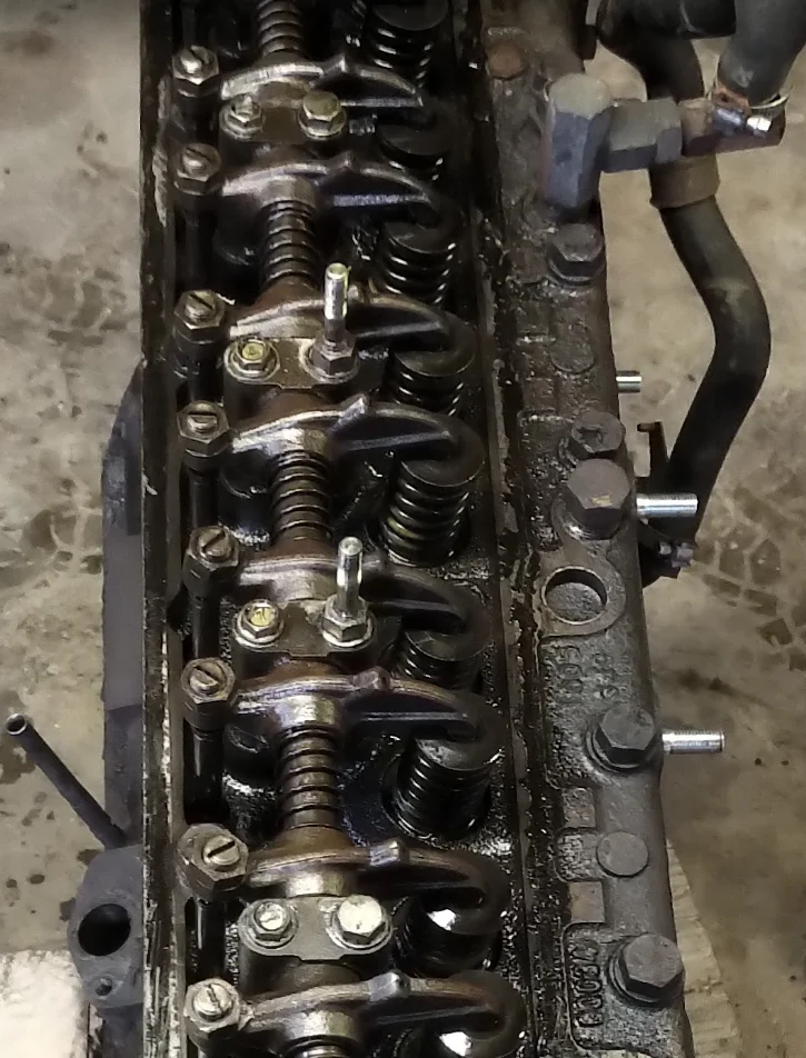

Are you talking about those 3 ports?
1635428677606
Better view on the 2 rear:
AM-JKLUDK9FKwlmcJvGMgthrAk0Ph-RO_DtLwyhJbnvUsukaTprgN7iXEjIi2PlFqYbSlMkrrvDa0Q7jscFgIbLrnrH3xhW0qZ-CdCU1Z8Mg8Y8i4LTCK1vYj_oqe_355LoNNdzssds6Dbhq5DqU5PMjGNqe=w1455-h970-no
View on the center one and the first of the rear:
AM-JKLUJv8CCJe8Q5piJoSZbGeZ9X9xLrJ9tln60p_corczwP-5-QYfSR1w8oYnkXceRQMejq5BP2Bp_cl36h4Gwb4XZoK0xCKat52LwKmigLm9DHaVvnTY0I6AcpITC7DlU_Kdcw193a-9pUbn_mHfmn62V=w647-h970-no
1635429551776
My head has partnumber 60034, it's from a euro-spec F.5 built in 10/1973.
I have no idea what is supposed to be the usage of the center one, I only discovered it following the restoration. It's very hard to see it once the engine is in running condition, you have a very narrow angle to see it between the carb, airbox and valves cover, and it's always in the shadow.

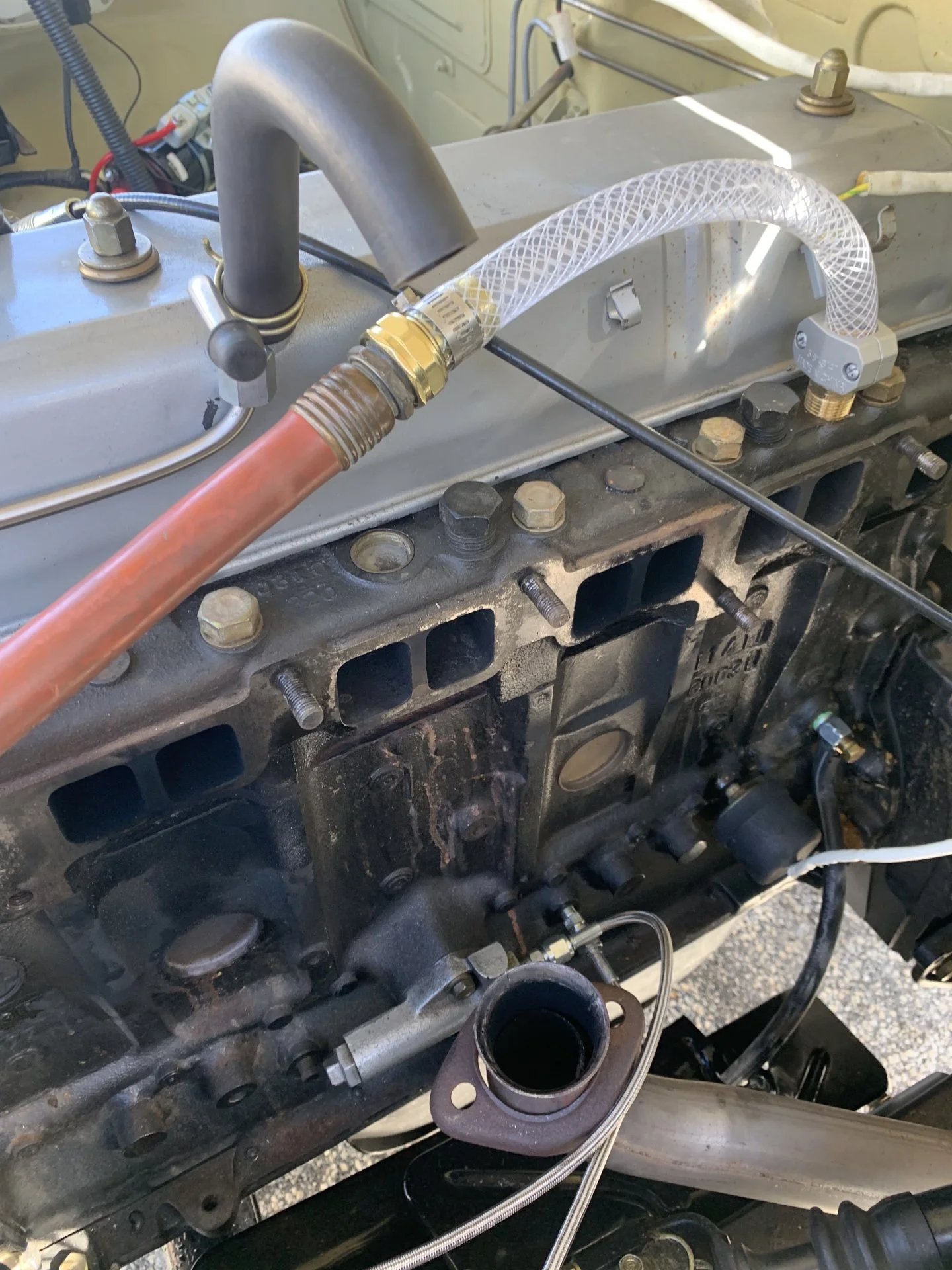

My Jan '73 F engine (US Spec FJ40LVA) has the same three ports: heater supply, water temp gauge, emissions system temperature sending unit.

I believe they moved the emissions thermal valves to the thermostat housing, possibly for more consistent readings, or, it's easier and cheaper to drill and tap an aluminum casting than the cast iron head.
My euro 74 so has the 3 ports on the head but also has this thermo valve on the thermostat housing. It's on the way of the vacuum advance but not too sure how/when it supposed to work (and even less if it's still working).
AM-JKLXvMpGwNN7tdTV3VqbVKnJKfA2R8wgLBZzBJy1rER0xgGIaXrrsOGp9ZS-xmRmIKiElMwFrTacWyU52Woci6I4_nVFmD67PfA4D6Da8IDafihhD_hTagLEFVmVcuMVXvwkb_bIWvENLhhXaAuWbgz_ScQ=w728-h970-no
When I had looked in the EPC for those valves it seems they were fitted on euro trucks with the F engine but were removed with the 2F.

MY original NO SMOG cylinder head had the 2nd threaded port for the optional USA spec. heater circuit , but NO 3rd port center behind carb ? 🤔
