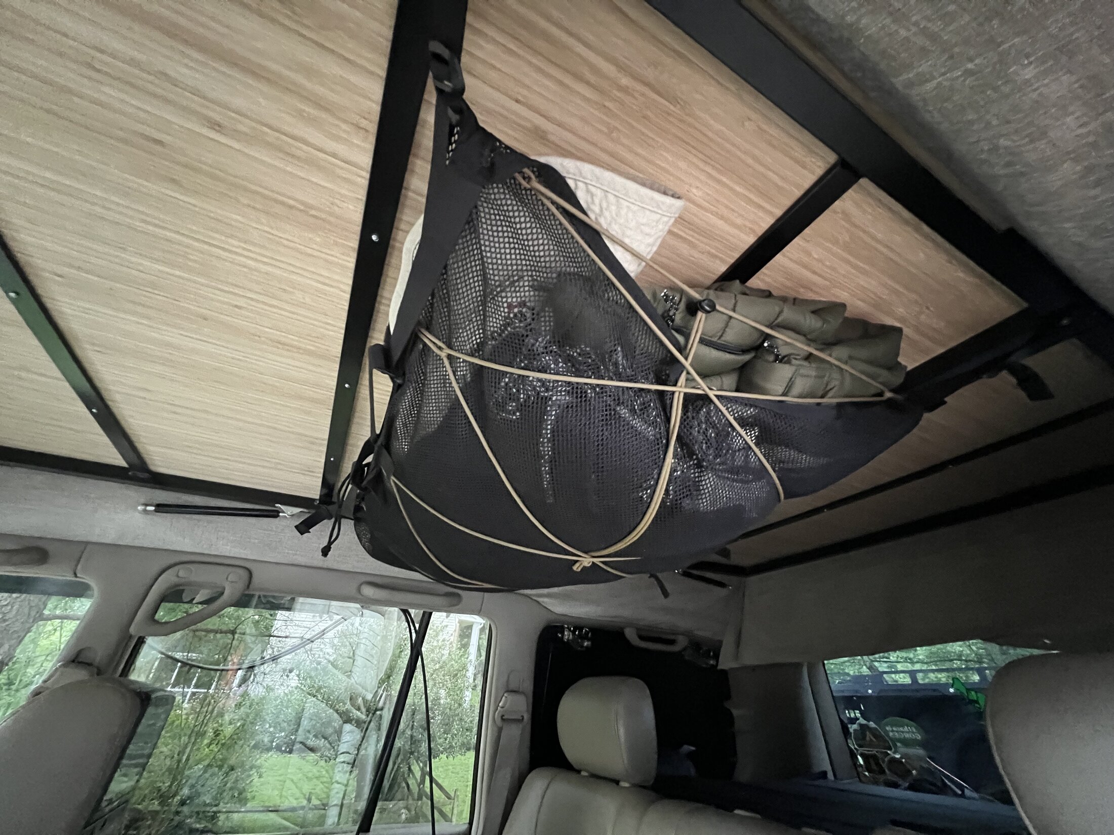

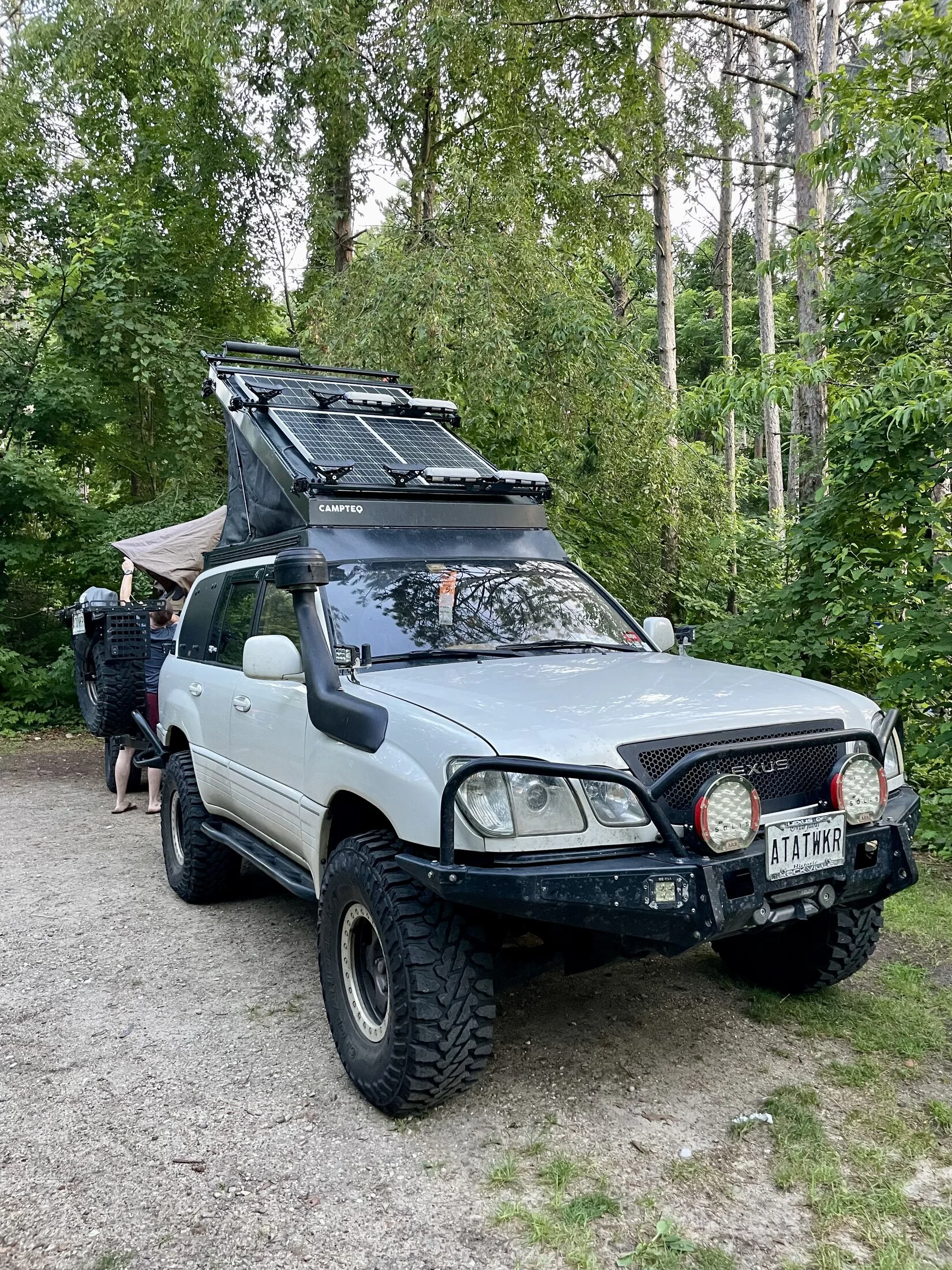

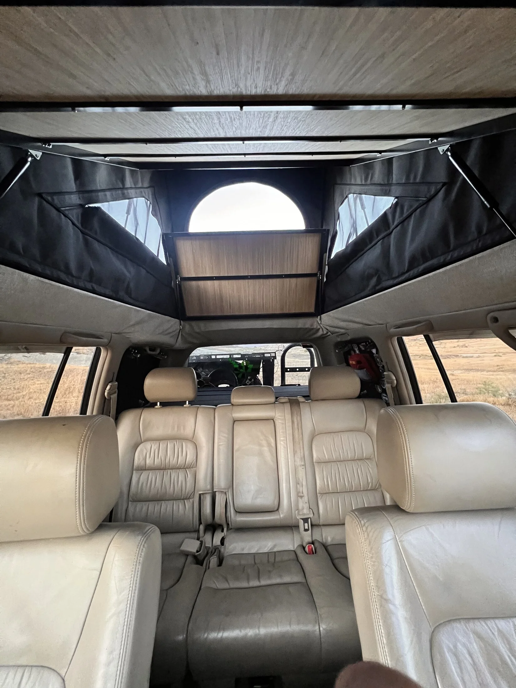

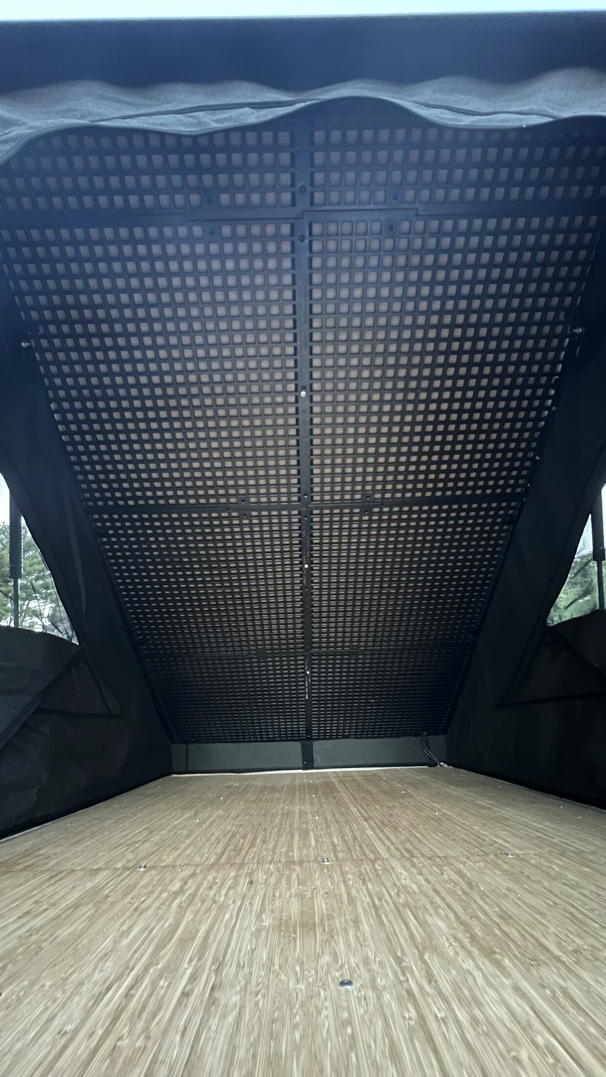

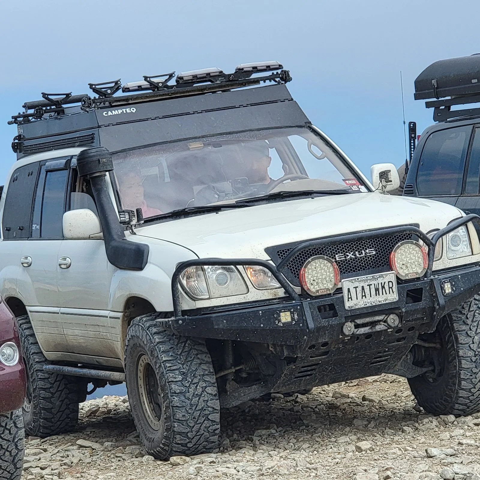

I thought about that too but I think the sunroof opening is too far forward and close the the top hinge that you would have to be extremely slim and flexible to squeeze through the opening and into the tent. I’ve had three other RTT setups: CVT, JB, ALU-CAB, and now this. Here’s a few pics of my 470. Any questions, let me know.
A cool guy took the last pic.
View attachment 3703656View attachment 3703657View attachment 3703658View attachment 3703659View attachment 3703660

No water.
Minor rattles (but normal in my 470).
0 regrets.
I truly did not know this was an option and am blown away by this. So there are no supports between the vehicle anymore , just open pop top roof?

Chatted with a friend at COTR2 and he mentioned Eric was back making these. Both him (200 series) and I ended up getting these done. No regrets and super happy with ease of setup and tear down. I can roll into camp late and be asleep in less than two minutes with about same time for pack up in the morning. I travel with my 470 as much as possibly (vs flying) and do a lot of “state hopping” along the way. This has been by far the easiest and most convenient of all my setups. Not cheap by any means, but it fits what I need very well.
