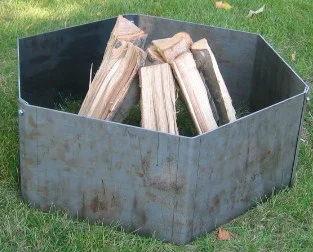

I want to have a fire ring made for camping and found a company online that makes them out of steel and stainless but figured I would just go to local metal shop to have them fab/ break the same thing but wanted to do out of heavy gauge/ thick aluminum to cut down on weight. Any cons on why heavy gauge aluminum shouldnt be used? I figured aluminum does better with heat? Here is a pic of what I am going to have done. it will be 3 peices that bolt together real quick and will be 8-12" tall and 30-36" across from flat sides of octagon
No experience with aluminum as fire ring material. Just know from the scoutmaster I had when I was a kid that he's actually melted/deformed aluminum dutch ovens. Thought all dutch ovens were cast iron until I read a post a few years back researching something about dutch ovens and ran accross that info he posted.
If that's any indication, I'd stick wth steel. My old washing machine tub fire pit has done great for 5 years plus. It's up on some plumbing flanges as feet so its also very easy to clean up what ash does fall through the holes. Flaw I see with your design is that it's open on the bottom, so unless you put it around an existing fire ring/pit, you will be scaring the earth where you build your fire and if you camp with the 'leave no trace' philosophy it won't work very well. I've cleaned up after BIG fires in my tub and have left absolutely no trace of a fire. Packed out all the ashes too!
Aluminium is just a bad idea unless you want a hot-melted mess. I don't know what "kinda" fire you build, but usually after a few adult beverages, someone ends up melting a glass bottle in our campfires.... OK and more reasonable statement, my buddie warpped one of my al frying pans pretty bad on a small campstove. Regardless, steel is the way to go.
ok, steel it is I guess, I just figured aluminum engine blocks and heads were meant for heat disapation for high output engines and such. Oh well, steel will be cheaper of course.

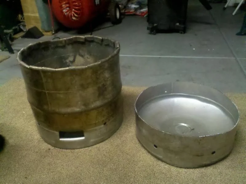

I've been using an old beer keg I had. I cut the 1/4 bottom off, and inverted it for use; that way there is an air hole after knocking out the tap. I hammered over the rough cut edges for safety. Perfect size for the rig. Kegs must be some type of aluminum alloy since it was a pain to cut and I had to use a small sledge hammer to hammer the lip over. I've had no melting issues, keg are pretty tough. Plus you get a solid bottom for the environmentally sensitive types....and a smaller ring from the cut bottom.
