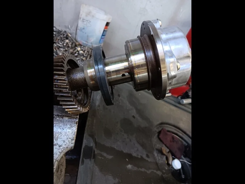

just adding more info to thread i have an 01 lx, cruiser mechanic said they typically don't switch camshaft seals while doing timing belt on all the 100s they do and since this shop is highly recommend cruiser shop from this forum i guess I'll believe it, it's an extra 2 hours and not leaking, since i need truck back asap, i only had crank seal done.
I just did my timing belt and my friend who’s a tech at Toyota said the same, if they’re not leaking leave it. Theyve run into issues with old seals wearing grooves in the shafts and then having a hard time lining up the new seals perfectly.
I am running into this exact issue with my '06. Had the shop replace the cam seals with a TB service, but after getting it back, the oil leak from the area was worse. They took it back and put a master tech on it and discovered grooves in the actuator surface that they claim were from the previous seals.
Now I am also replacing the actuator assemblies so the sealing surface doesn't allow oil to pass by.
