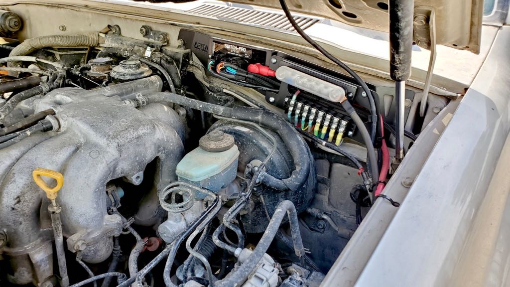

I tried searching and didn't see too many threads on the 80 Forum for different Switch Pros installs. Seems to be much more popular in the 100 & 200 Groups! I did see @synapse setup, curious if you have more pictures or details of your setup. Did you make that mounting plate?
@NorCalFJ100 Yes, simple plate and bracket made. Though not sure you want to use mine as reference as I'm RHD, so this area is where your brake master cylinder/ fluid reservoir are...

@Delta VS as shown above mine is in the same general area and have had no issues with heat for exactly 2yrs 1wk :) Exhaust side of the engine bay may be a different story.
