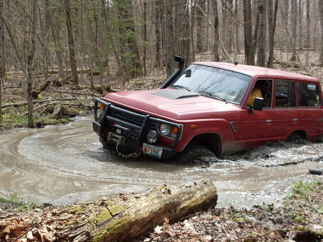

I think I spied it too . . . . . . . a little further north of Detroit though.
Is this the one?
That'd be it!
Let me see if I got this straight...
My old rig lives on the same street as Wendy's aunt in Detroit???????
