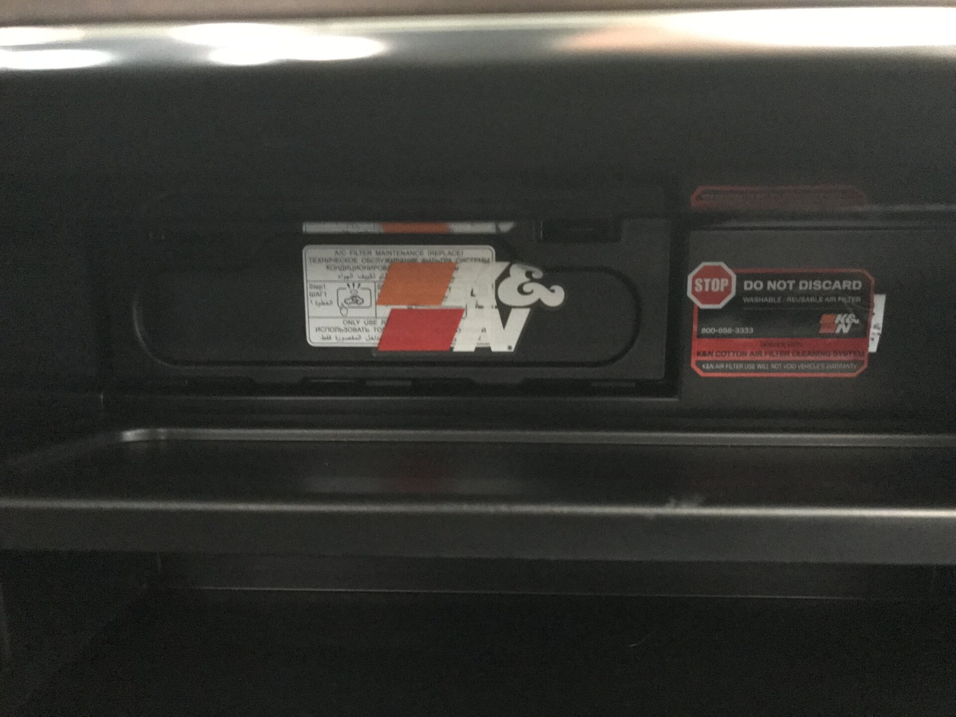

Greetings All,
Edited: This won’t keep someone else from breaking your cabin filter door, lock the glovebox.

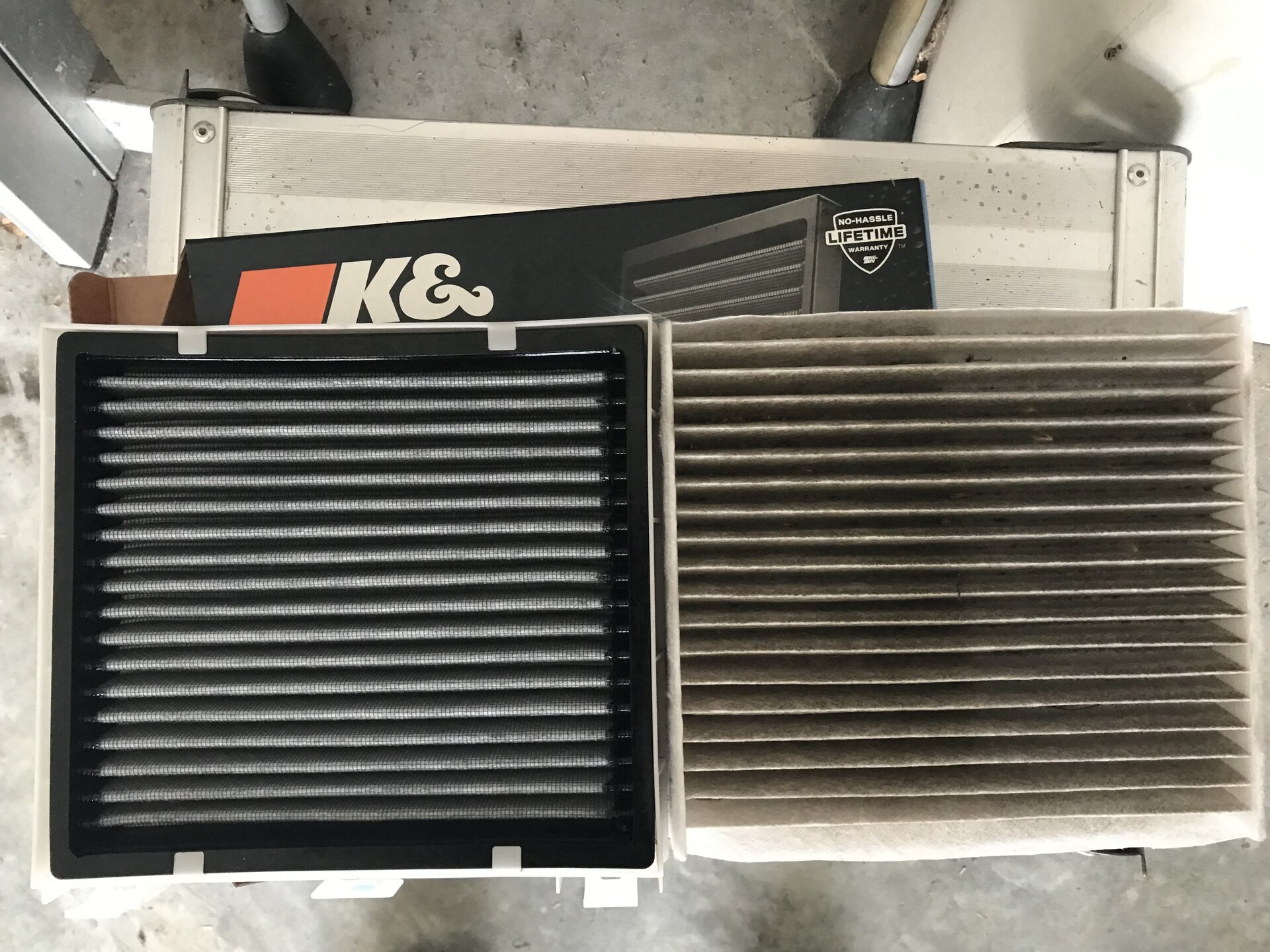

My Toyota OEM cabin filter looked bad after 20k miles. Neither my wife nor I have allergies, but after looking at the dirt/crap in the filter—time to dump it.
I sought a reusable solution to replacing paper cabin filters.
NOTE: This is not a product endorsement.
1. Get a K&N VF2000 Cabin Air Filter.
2. Start your engine.
3. Turn on Auto AC Setting.
4. Set Recirc (recirculated air).
5. Turn off the engine as the recirculating doors are now where you need them.
6. Replace the Toyota OEM Cabin Air Filter with the K&N (reference YouTube if needed).
7. Button it up and adhere the stickers.
NOTE(S):
-5 minutes at most, if you follow the process above.
-From there it is up to you to decide how often to clean it (and to keep it secured/from being accessed by service personnel).

That is a lot of money for what it is, but I’ve found a big drop in how well the filter fits into the frame and seals when trying different aftermarket options.
I’d maybe shop around for cheaper sources
Also that seems to be a charcoal filter, a basic filter element would probably be cheaper. I used 87139-30040 recently and while this was in the states it was only about $20 from a dealer’s discount website.

I ran one of those K&N cabin air filters in my Tundra for years - probably for over 150,000 miles of driving - and I found it worked just fine. It was easy to clean and re-oil with the special kit. I also found that the rubber frame it was in sealed better than the OEM. I cleaned it whenever it got dirty. It was still working just fine when I traded the Tundra in on the LC. Before that, I was spending 35 bucks every few months or so on charcoal infused filters. After going with the K&N, I did not notice a difference in filtering. It costs about 50 bucks for the filter and a cleaning kit if I remember correctly. At least for the Tundra, it kept the shop monkeys out of the glove box.
