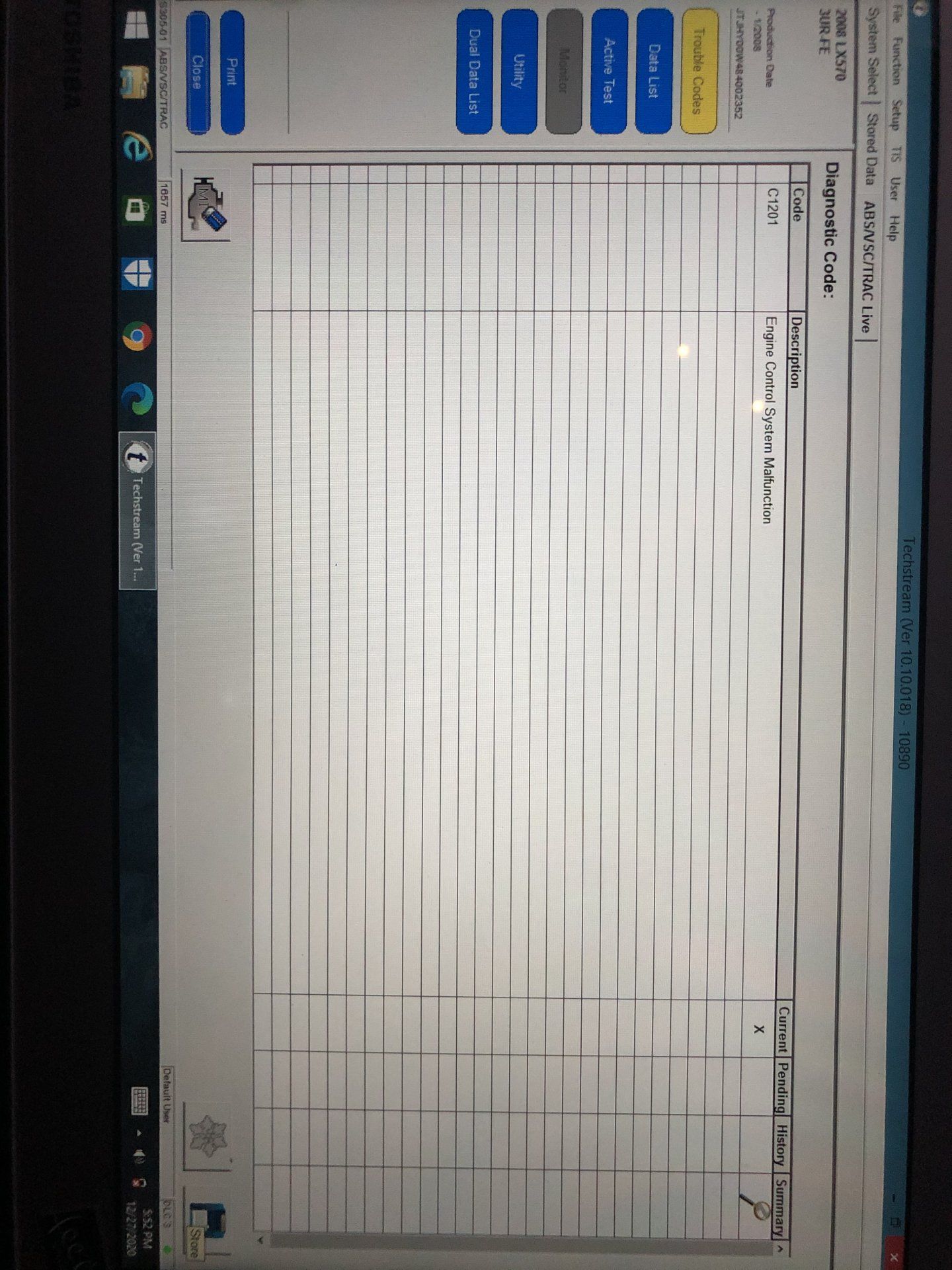

2008 lx570 with 224k miles, all of a sudden started throwing c1201 and one other code i did not write down. I connected TIS and tried to clear but it is not clearing out and the 4lo or 4hi switching isnt working, also when i pressed locker switch that sign started flashing as well. It has happened in past few times but always get cleared whenever i clear it. This time it isnt going away. Dont know where to start looking, anyone have had experience with this? It drives fine without issues

C1201 is a generic ECM error code that doesn't really help troubleshoot. It's set as a result of the other error code which should give more insight into where the issue lies.
It's very plausible that it's some electromechanical switching issue within the transfer case. Should be safe to drive.
Get us that other error code to help diagnose.
