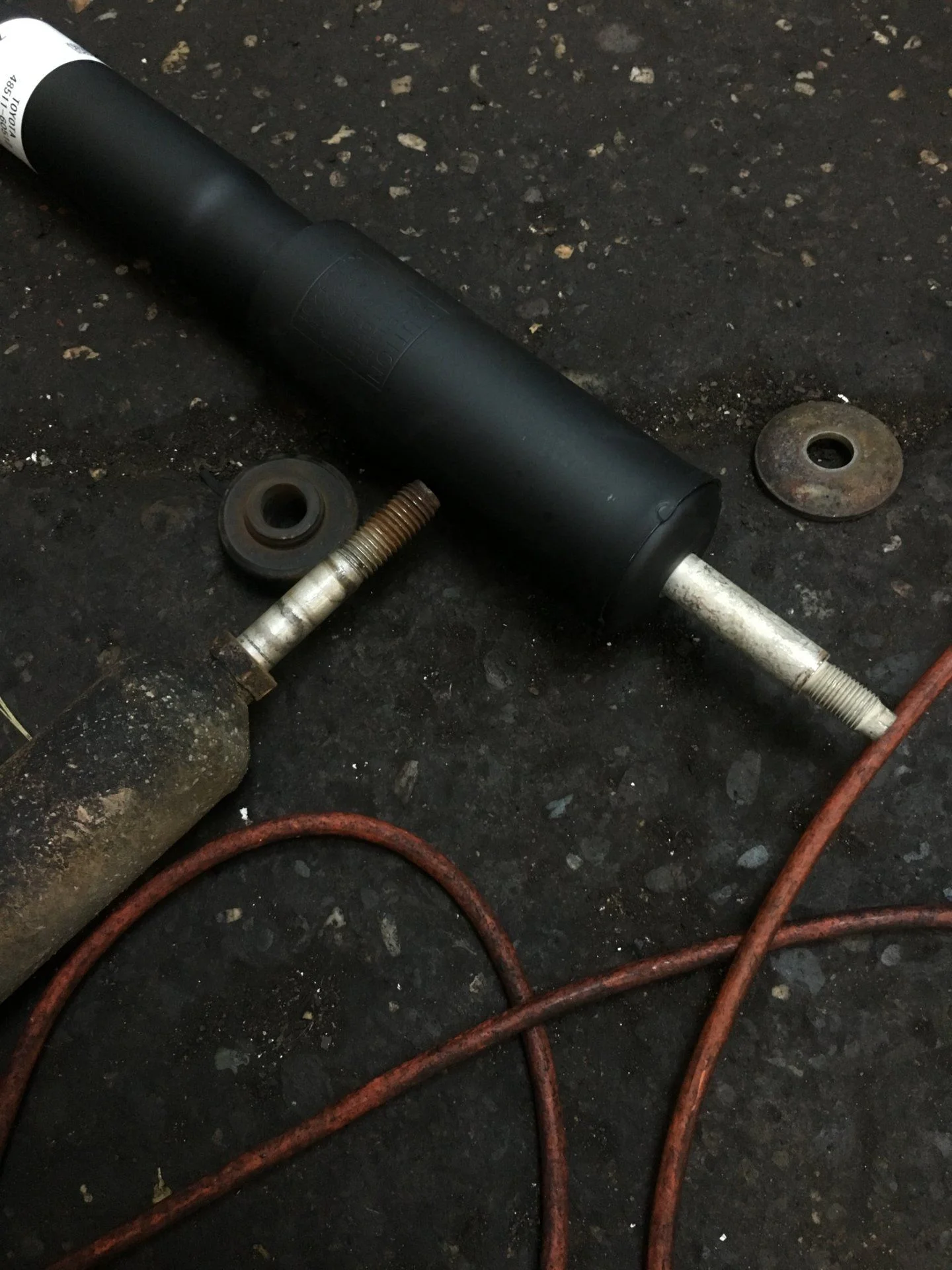

do new black tokicos have this welded nut on the shaft? anyone know that has one sitting around?

Just got oem front shocks from the Toyota dealer. Took them to my mechanic and this is what we have. That top disk thing doesn't fit. The new shock has a lip that the old doesn't. What gives?
It’s likely the current shocks you pulled off are not OEM, do they have Toyota markings? The top nut and bushings are specific to the Toyota shock as @Ayune mentioned previously:
FYI, bushing washers do not come with the shocks and they ain't cheap. Not a wear item, but if you've had aftermarket shocks mounted in the past then the OEM washers may have been replaced with smaller I.D. washers and they won't fit OEM upper shafts.
If you need OEM washers you'll need six of P/N 9094802173 (plain) and two of P/N 9094802170 (with flange that registers into frame mount).
Yes I see now. They were stamped Made in USA. My mechanic just had to file through that metal washer bushing thing a bit to get it to slide down on the new shocks. I only changed the front ones, but they do feel a bit smoother. I need to drive it more to really feel the difference, and replace the rear ones too. The old front ones were really shot.
