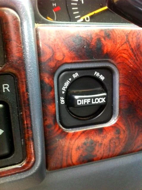

I am sure the pros here will ridicule me relentlessly, but in the spirit of helping those newbies to 80 series LC's here is my story. One year ago, I bought an 1996 LX450 for what I thought was a reasonable price ($13,000, 115,000 miles, clean underside and engine). Car had the triple locker switch but PO said he had never used it and didn't know if it would engage. Fast forward a year later and I am preparing for a June Moab trip. Figured it was time to get the triple locker up and running. No matter what I did it wouldn't engage and when I turned the ignition switch there wasn't a light on the dash. I pulled up some threads here and found an old one about fake triple lockers (who knew?). Checked the door badge and the A/TM for locked is K294 and not locked is K292. I had K292. Proceeded to pull the triple lock switch and that is all it was. No electrical connection. What a dope. In the end, I have a car I love and bought at a fair price with our without the lockers. But with the recent astronomical rise in prices this kind of mistake is now too expensive to brush off. Hopefully this will help a new buyer. BTW, if anyone knows how I can get the proper dash plate please let me know so I can pull my fake locker switch.
